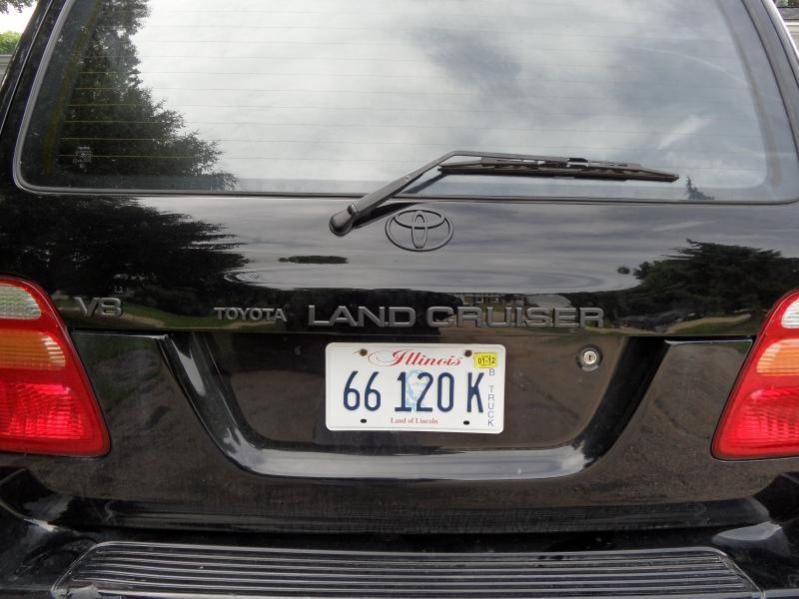

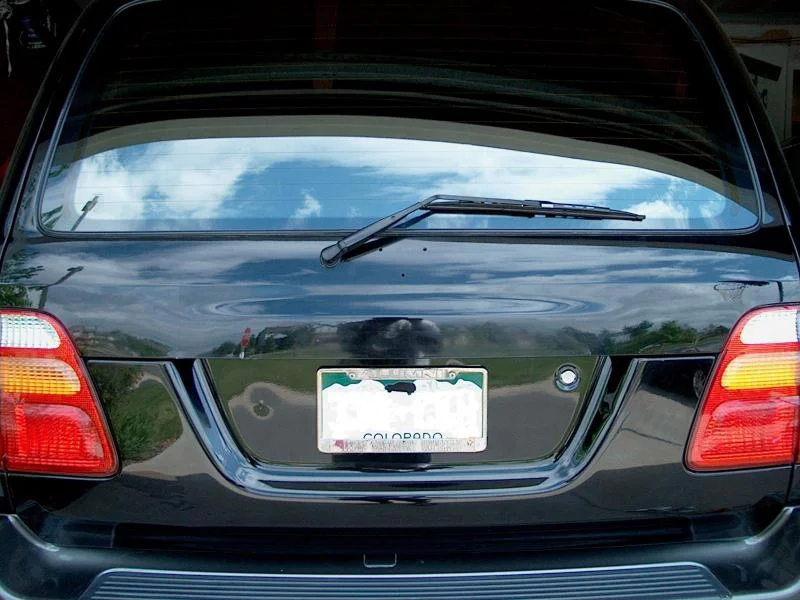

Anthony.L said:
Question, behind the main toyota emblem that is on the rear hatch next to the wiper, are there holes in the body? In other words, I can take some fishing line, zip that emblem off and no holes left behind?
They have alignment holes. You can remove it, but you will haz holez

Wh am I posting this picture? Gunmetal gray emblem on a blacked out grill looks excellent. I had black o black but it looked like my grill fell out late at night. I guess it's time for bed and less beer. Who knows

I have posted this in another thread, but for 2000 year, here are the holes when removing the one emblem, no other emblem has holes.
