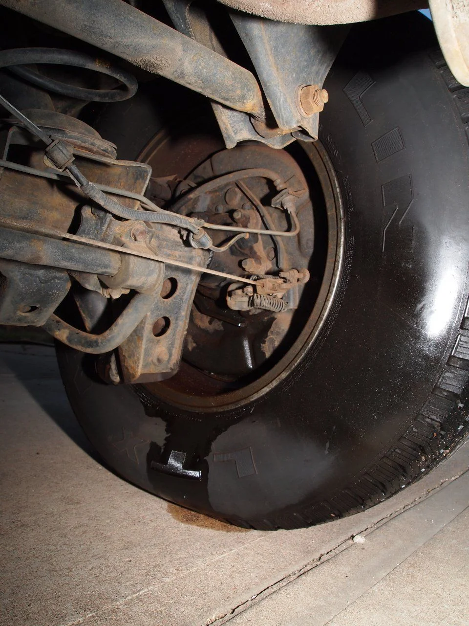

I've found the 00 LX470 (Graybear) wheel lug key internals (key portion) snapped off. PO's shop must have tried to removing the wheel and broke. I thought, no problem I'll just use another LX key I have, wrong. I've managed to brake loose the regular lugs. I say managed as it was the first time I've ever needed to use heat and penetrating oil on lugs. I also had to use my big boy 3/4" beaker bar. So I've no doubt the keyed lug is going to be a bear to break loose. I can't take to tire shop or elsewhere as brake fluid is running out of rear caliper.

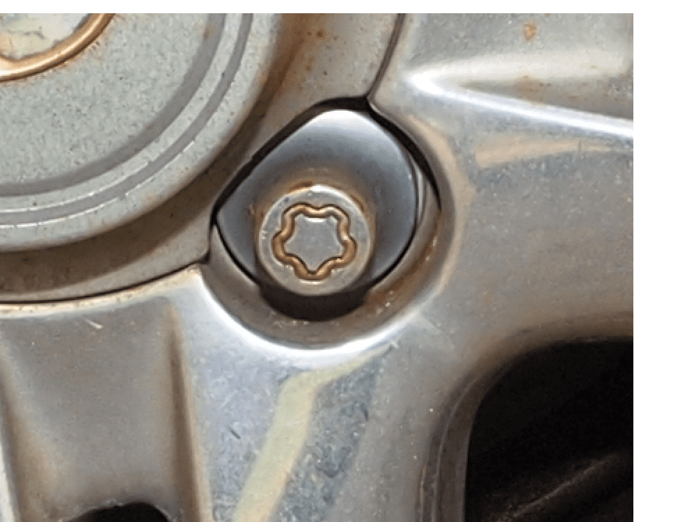

I added a picture below yours camino. I can't tell if either will work can you.
I can't tell the difference between the two I have in person, no way I can tell through a picture. I do have the key number somewhere though.
It looks like mine are 6 point and yours is 5?

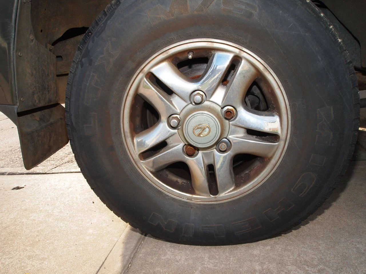

Here's the wheel I'm working on. The two either side of keyed lug where the worst of the bunch to break loose. I didn't know our lugs are hollow.
