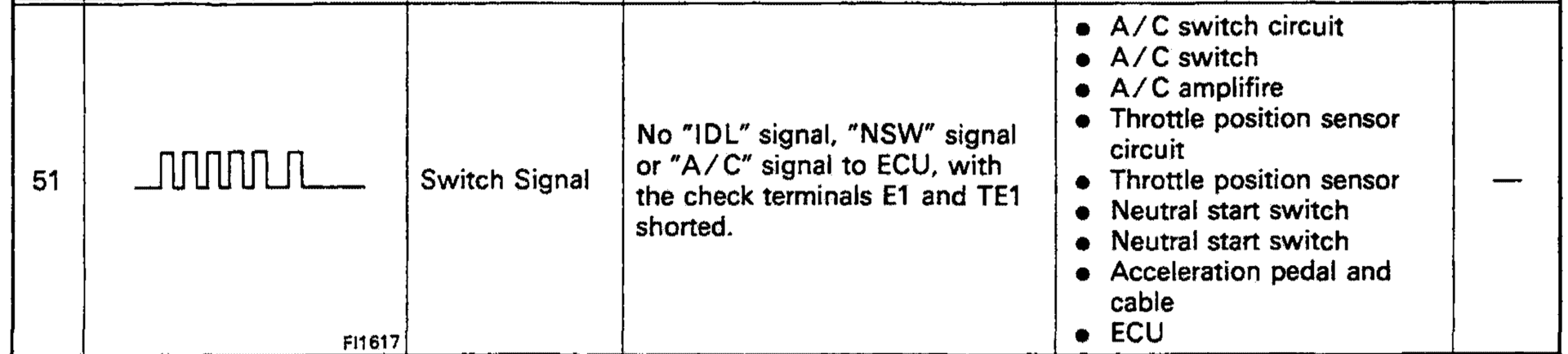

Code 51 does not look related to the exhuast snafu.
