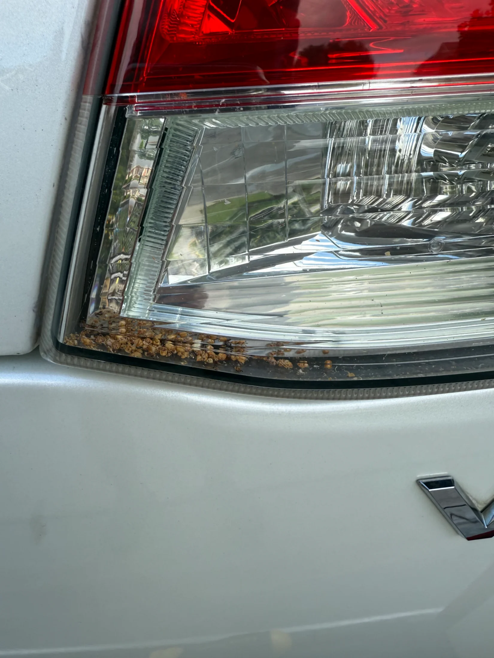

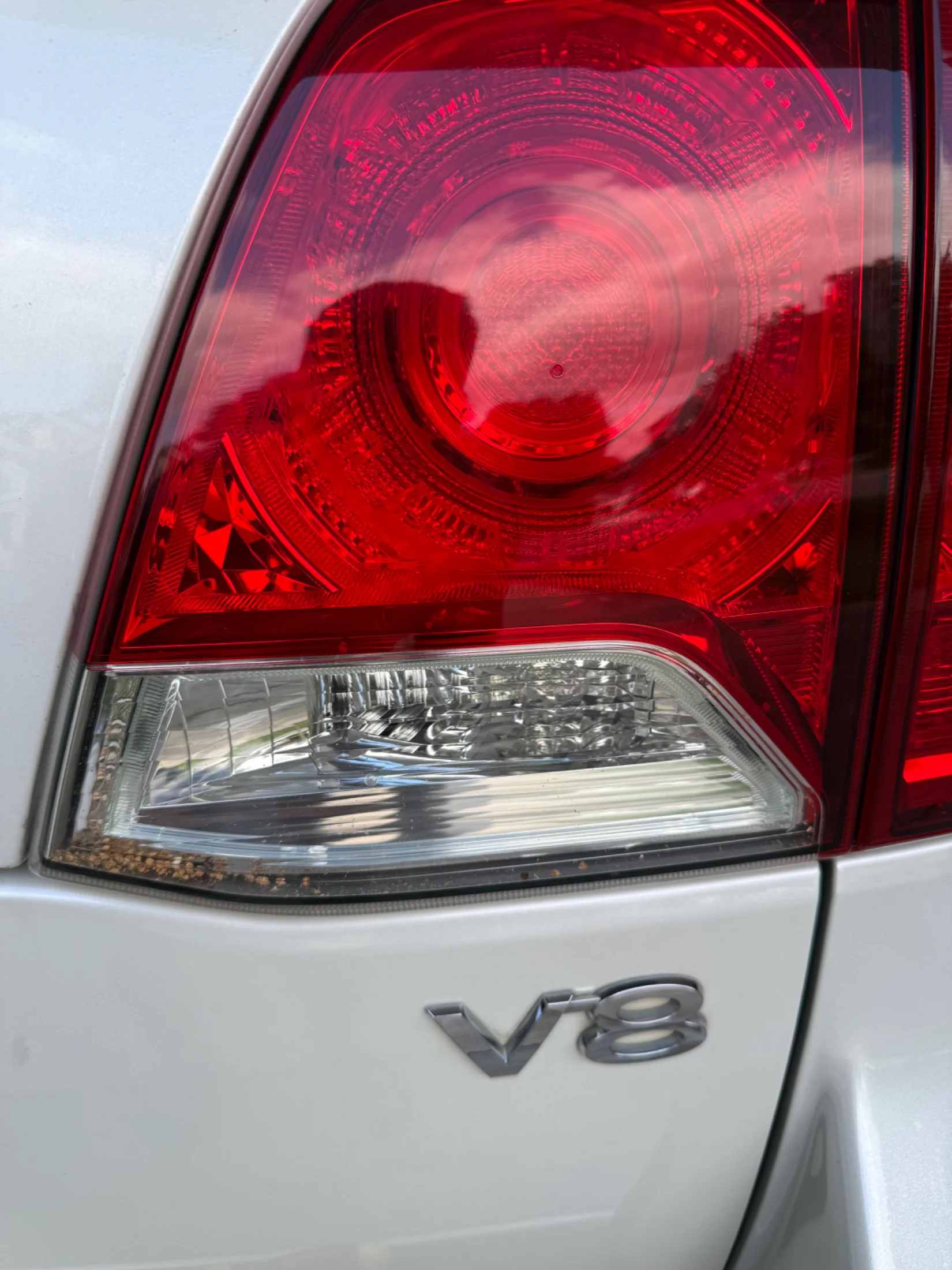

How can I get this debris out? I took light off and messed around with it but can’t figure anything out.
Unfortunately tail lights are plastic welded together so they can't be opened up and cleaned. No easy fix for that aside from trying compressed air with the lamp removed and bulbs out
+ if you can make a flexible wand to attach to the compressed air gun (and lower the pressure) you may be able to push them. Question is where they got inside so you can push them that way.
Yeah that’s what puzzling as I’m sure they are sealed up tight. I can’t figure out how they get in. I just bought it recently and they were in there from the PO. Will retry removing the lamb and bulbs + compressed air
I dunno about later models but my 2013 has something of a flap that is still an external element of the light. Spiders and small things do tend to get wedged in there but compressed air from the outside can knock them loose.
The light pops out easy, open the tail gate and you'll see the bolts/tabs.
Looks like they are just inside the seal and will fall out when you loosen the light and open the seal a little.
An extreme solution, but you could replace the part entirely.

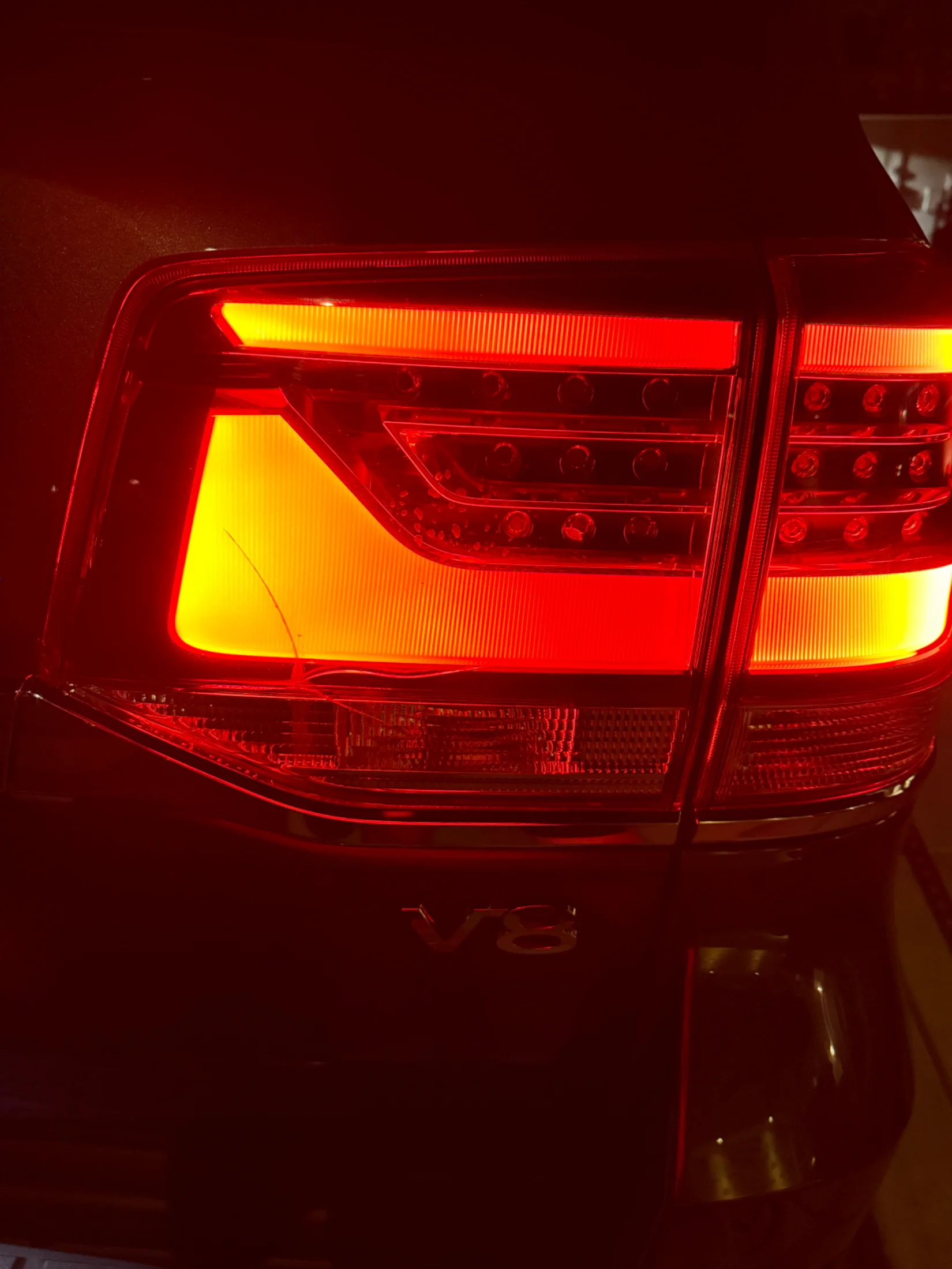

The rear passenger brake light lens is cracked on my truck (image below). Unclear how it happened as it was from a previous owner and I purchased from a dealer. The PN for this part on a 16-21 200 series looks to be: 81581-60360. This looks to be the proper part from Fred Auto Parts (link).
Based on your photo it looks like you have a pre-facelift model. It looks like your part number is: 81581-60180. Again if others have a preferred vendor please give a shout, otherwise I also found that part from Fred Auto Parts (link).
If any others have sources for these parts, let me know as I'll need to replace my lens. Also if you have any tips or instructions on replacing this component that would be super useful.
