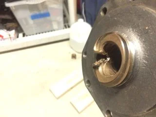

1). The first step is to cut a channel on the inside if the bushing. I used a Dremel with a diamond bit and just worked it back and forth through the brass until I got almost down to the spindle itself.
2) Next I used the Dremel again with a cut-off wheel to cut a channel through the top of the bushing to the channel I had cut on the inside.
3) Then I used a punch to drive up the outside of the bushing on both sides of the cut I had made.
4) Drive the as far into the center of the spindle as possible then it's time to start working downward. I used various punches/ old screwdrivers to drive down behind the channel cut on the inside. The goal here is to get that channel to split and get a little bit of the brass material to pop out into the center of the spindle. It doesn't need a whole lot out there but be patient and get a good bit for the next step.

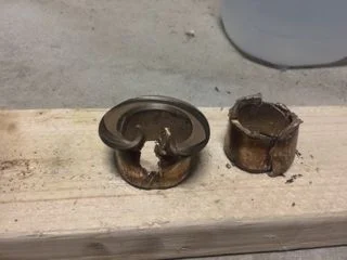

Here's a picture of both bushings I removed. The first bushing I removed is on the right. As you can see I had some trouble.

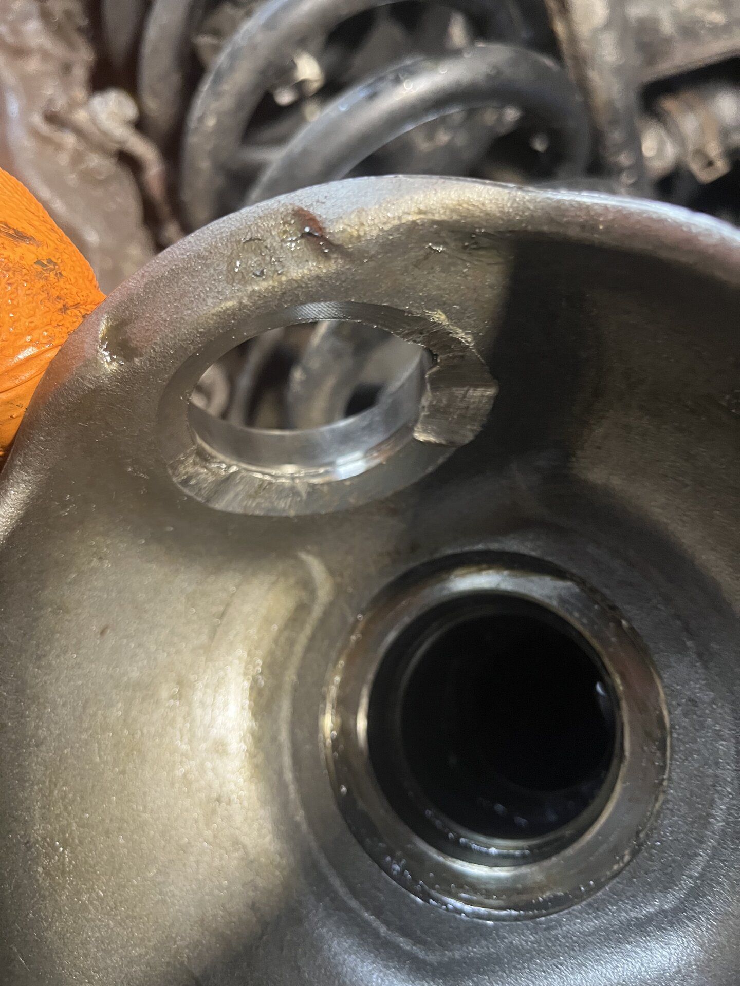

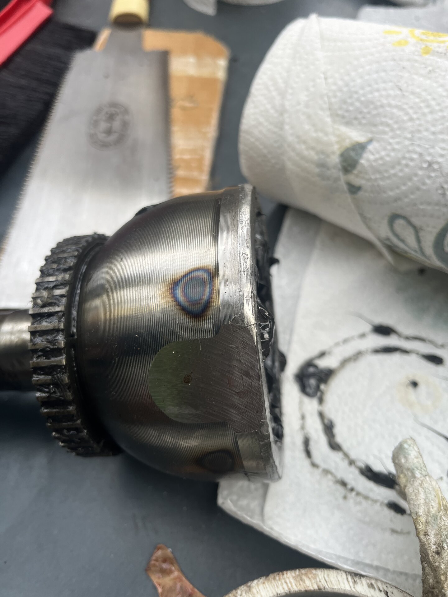

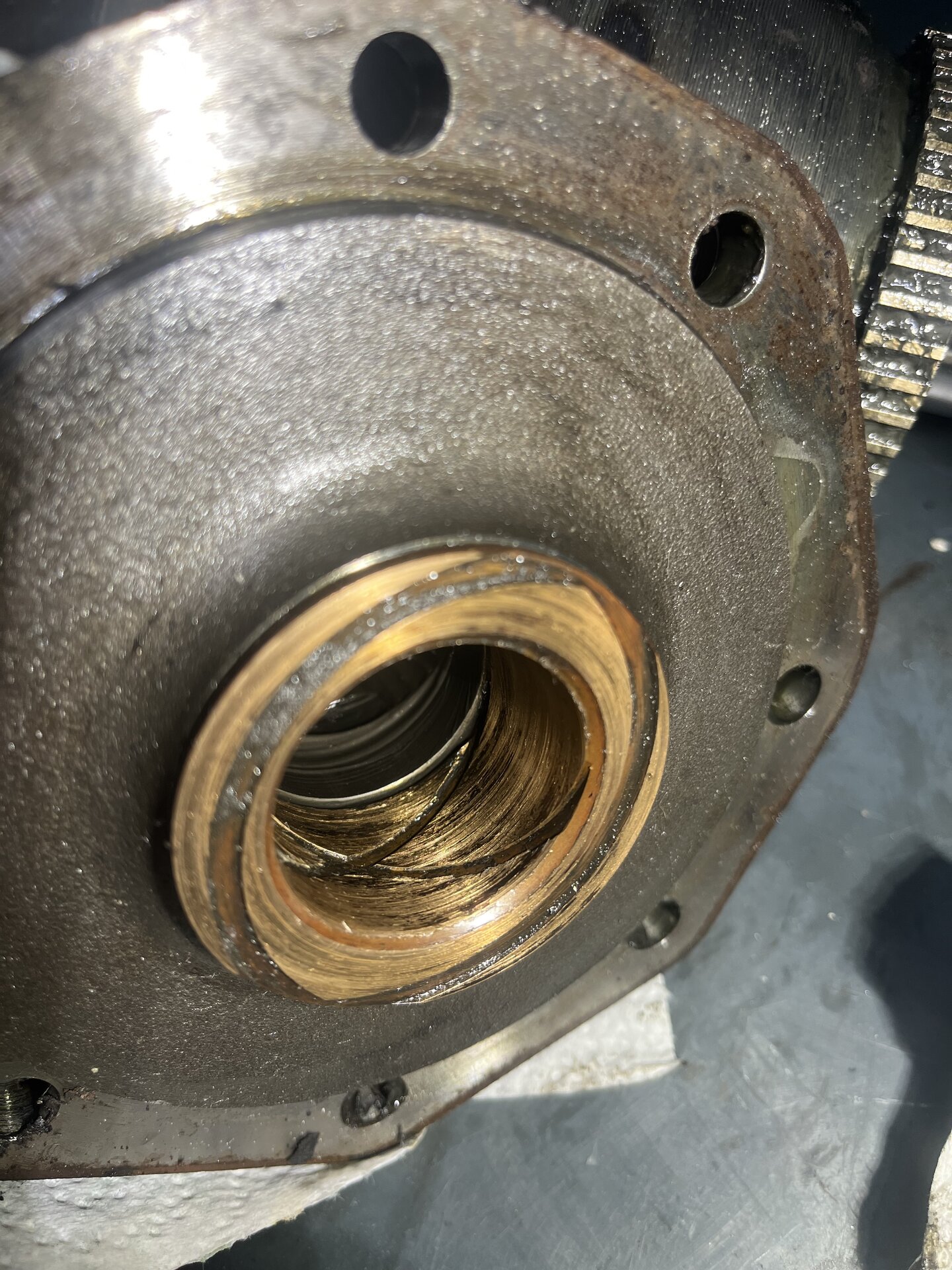

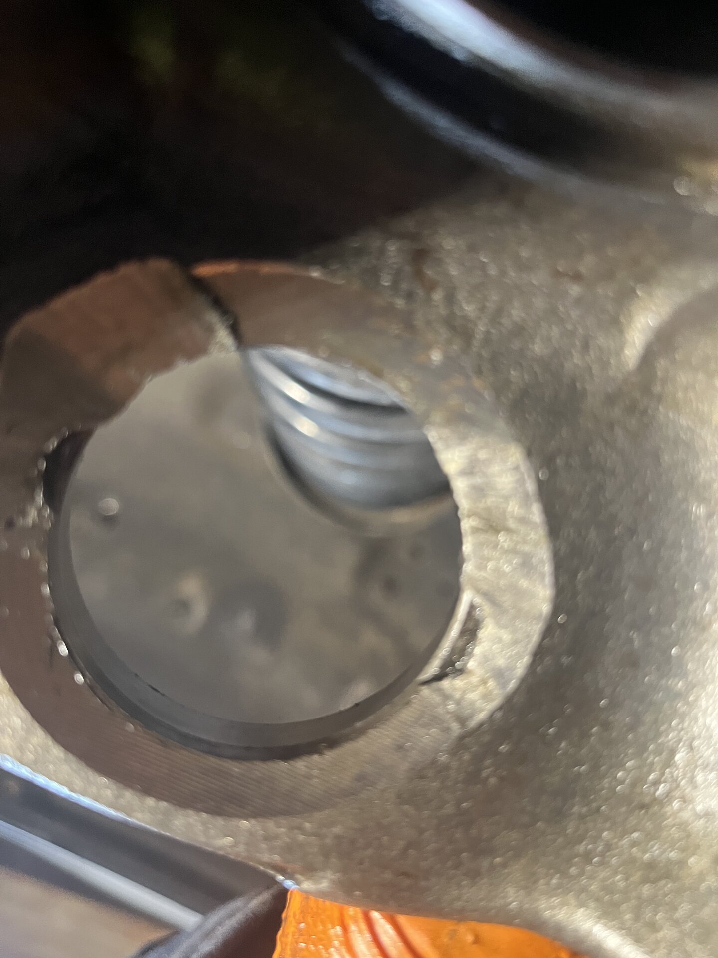

Old thread but a goodie. I never usually touch those bushings but a kit from Australia had a combination short brass bushing with needle bearings I wanted to try. Just couldn't budge the old bushings out.
Got a little good vs bad photo. The bad bushings was on my passenger side. That much slop led to the third image... Glad I caught it when I did. Eventually would have led to me needing a new axle.
