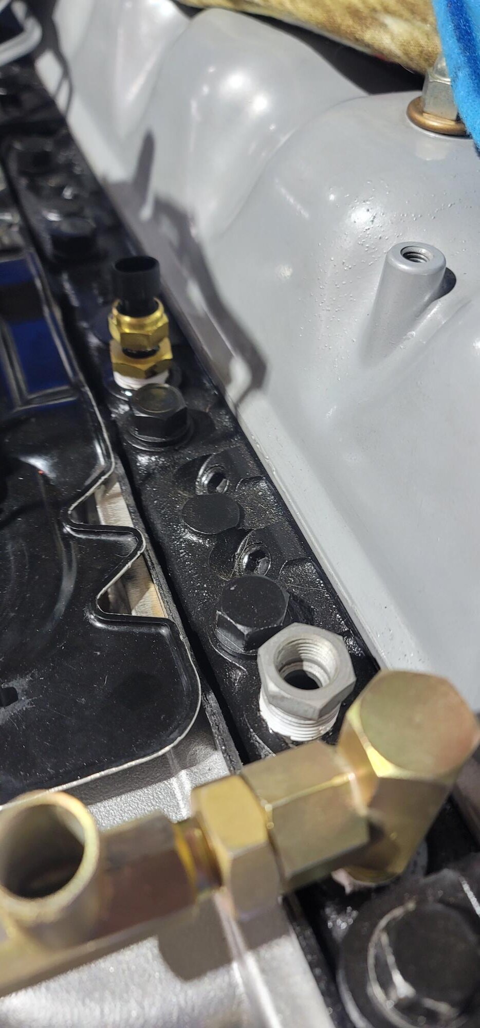

Do any of the venders here carry a threaded plug to screw into the head if I want to remove my bushing. I originally was running the factor temp sender that went to my gauge cluster and another Autometer set of gauges. I just recently purchased the Dakota VHX gauges and would like to plug the head or the bushing if possible. Would the head be BSPT?
Yes. 1/2" BSPT. 1/2" NPT has the same thread pitch but taper and thread angle is slightly different. However 1/2" NPT is close enough that you can get buy with it. It's so close that if you purchase 1/2" BSPT online, it just might be NPT anyway. It's pretty hard to tell the difference on 1/2". the other sizes differ in thread pitch and are easily distinguished.
Thanks for the reply, I see McMaster Carr has them for $5.00.

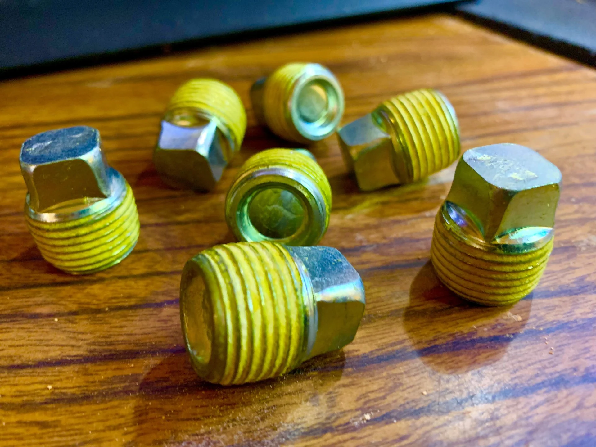

below is the correct OEM Part your require , it is a JIS Pipe Taper and the exact Thread Pitch and Diameter , to install in your Cast Iron Cylinder Head ...
you do not play dr. with a cast iron cylinder head coolant service port that is only 4.21mm thick at the female threads location .....🚩
please send me a PM with your shipping info , i will have one on these out the Morning / Thursdays
