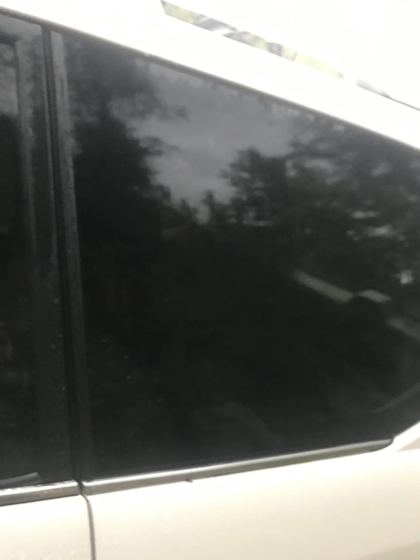

Water leak from rear vent window.
I have a pretty serious leak or leaks in my rear vent window. Noticed wetness when I took the panel off and it drips a lot when it rains. Pushing on the window from the outside doesn’t seem to help reduce the dripping. Has anyone run into this and fixed it? I’ll probably replace the rubber and...
