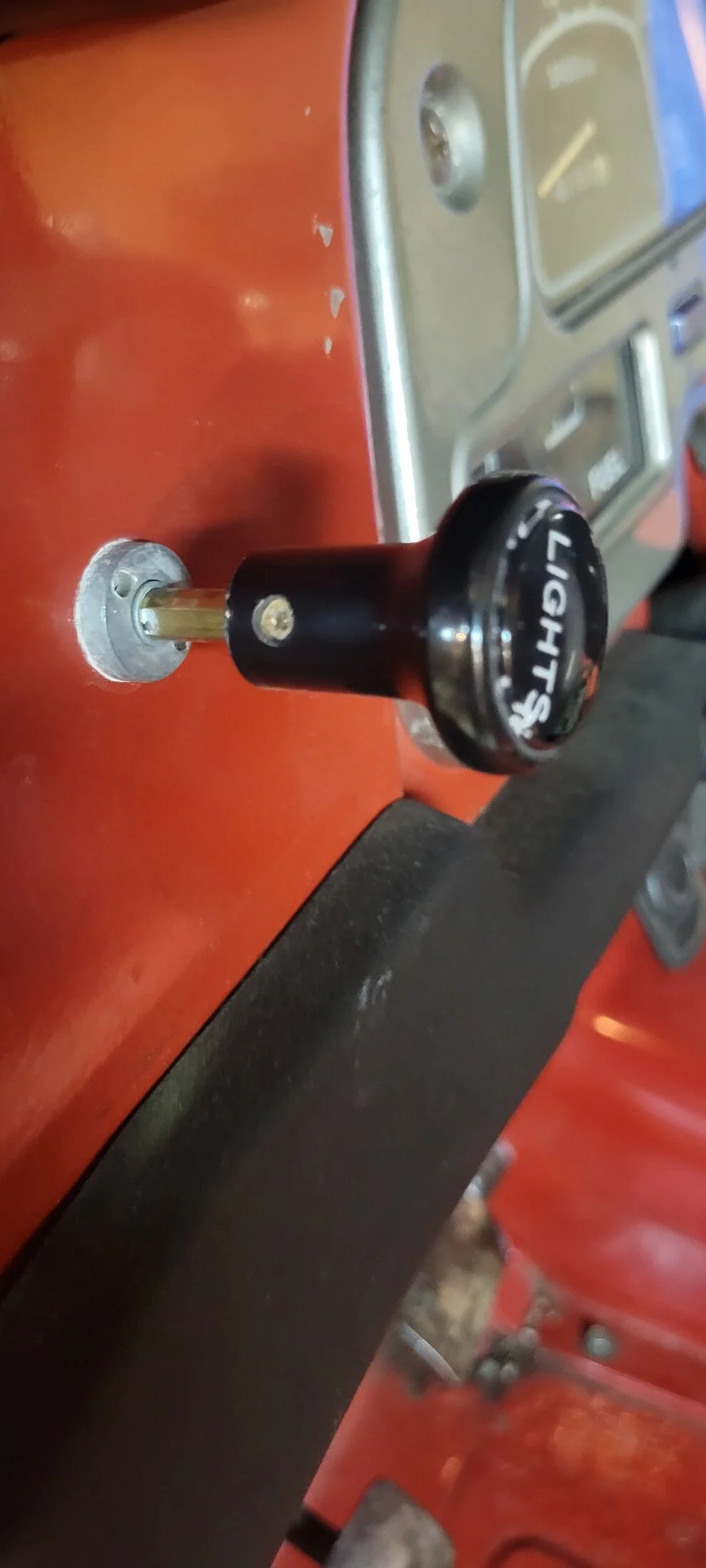

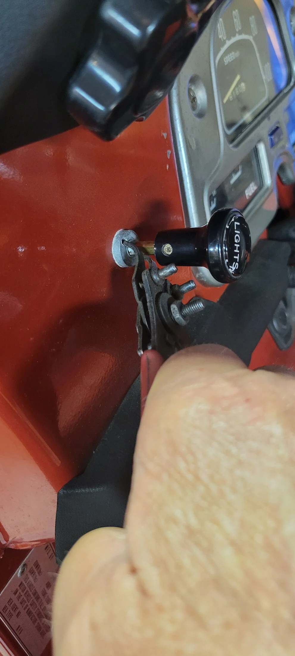

There's a set screw on the side of the knob, loosen that screw and then unscrew the knob. Next use snap ring pliers in the holes or carefully use regular pliers and loosen the escushion/nut that was under the knob while holding the switch from behind the dash and remove the nut. The switch can now be removed from the dash. Let it dangle and replace the bulb.
I can grab the switch from behind the dash without looking. I've used the switch as leverage to help loosen the nut.

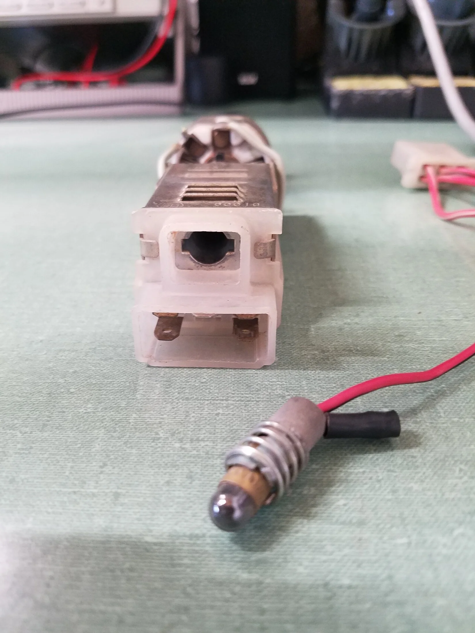

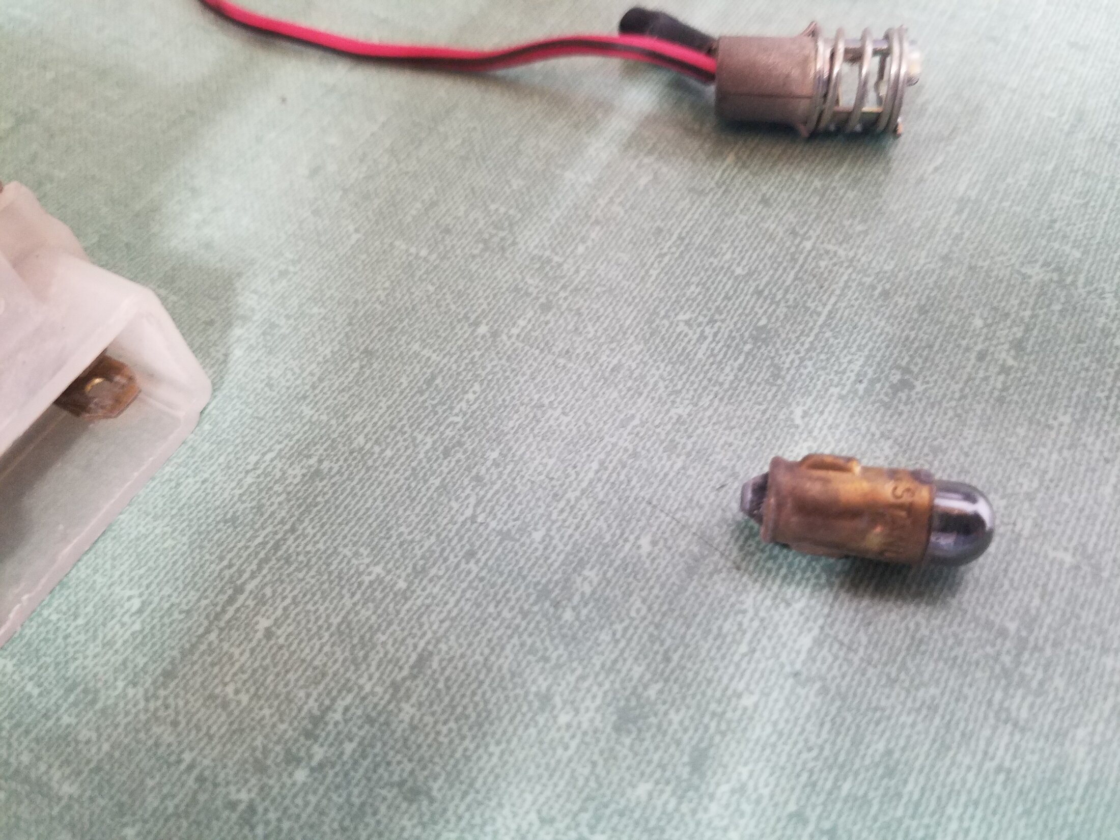

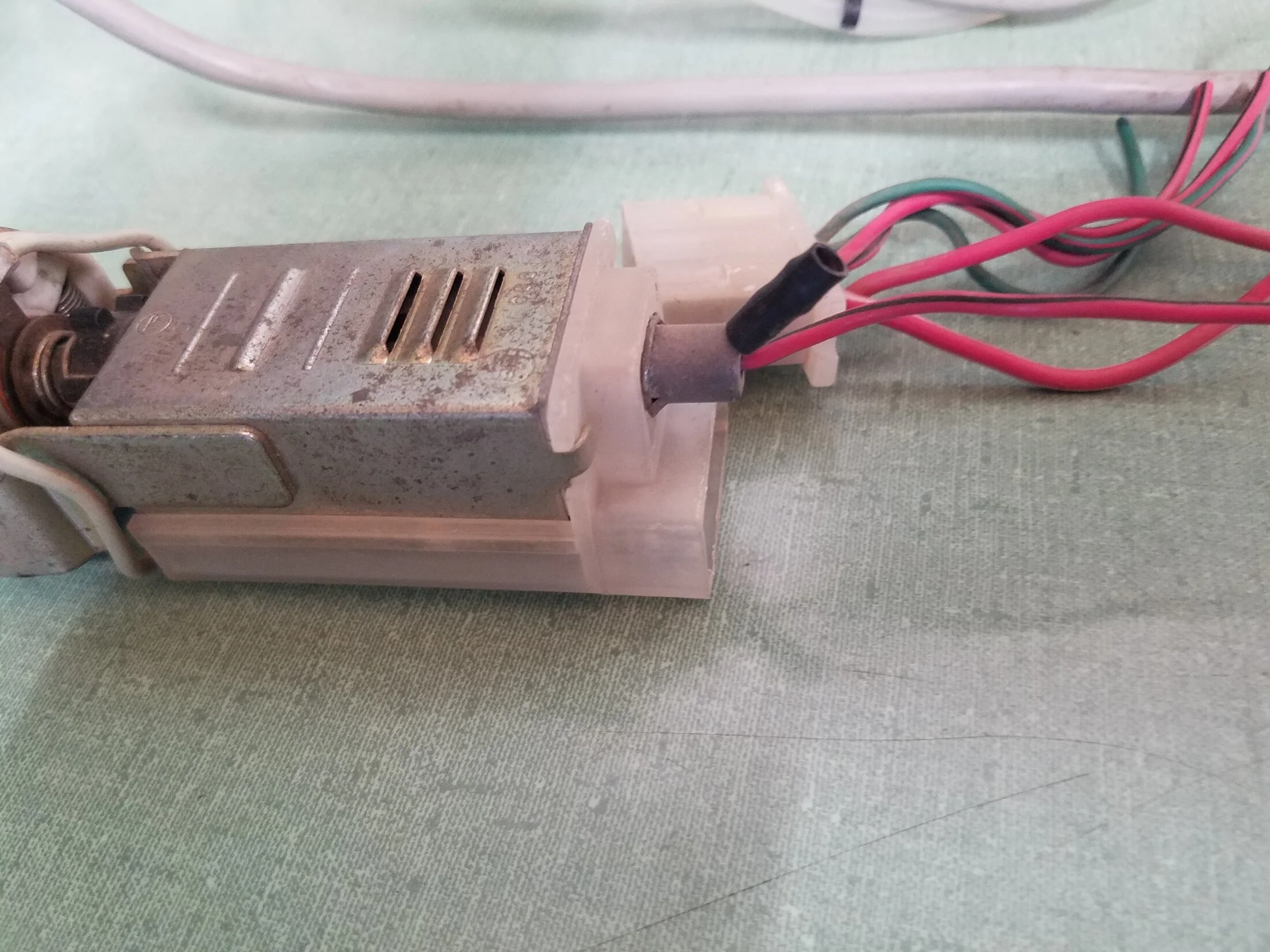

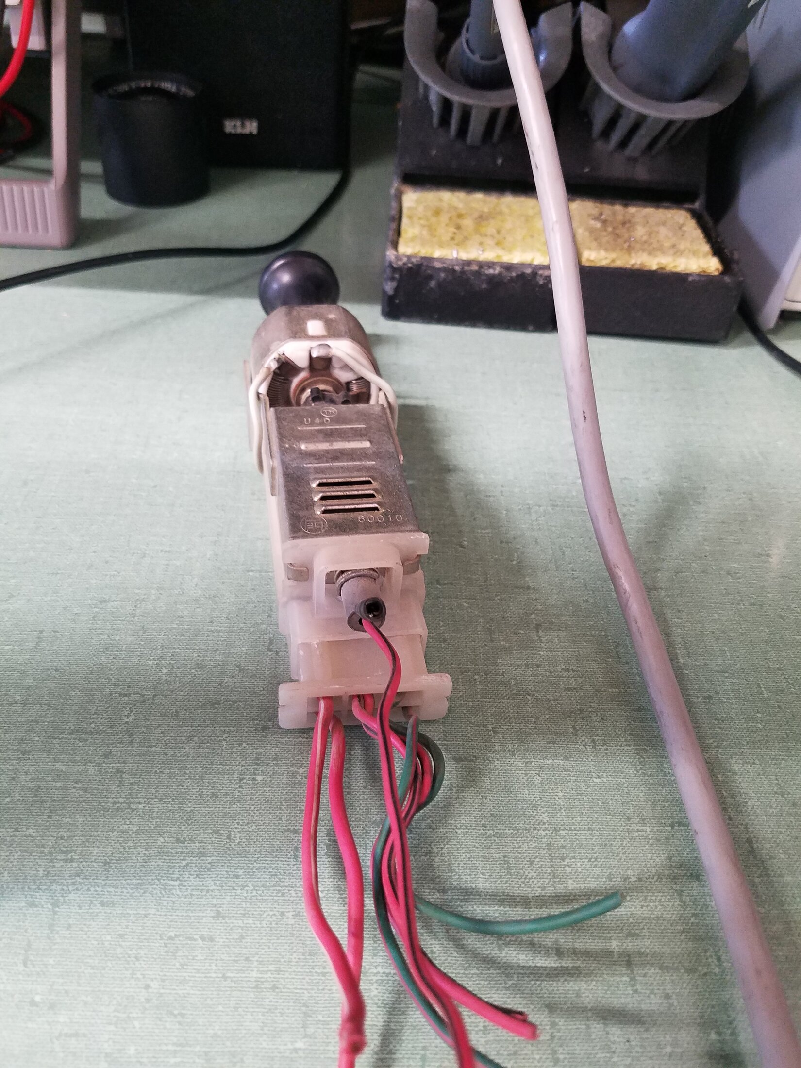

The bulb is easier to get to if you remove the switch plug first. The bulb is removed by pushing in against the little spring and turning 1/4 turn clockwise looking at the rear of the switch. 12V 1.5w BA7 in this old switch.
