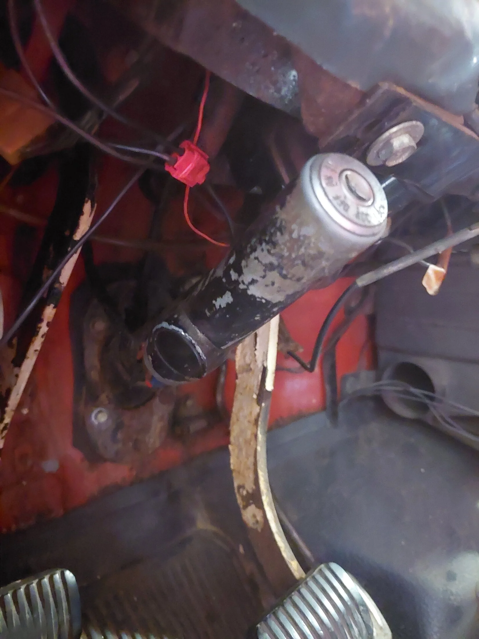

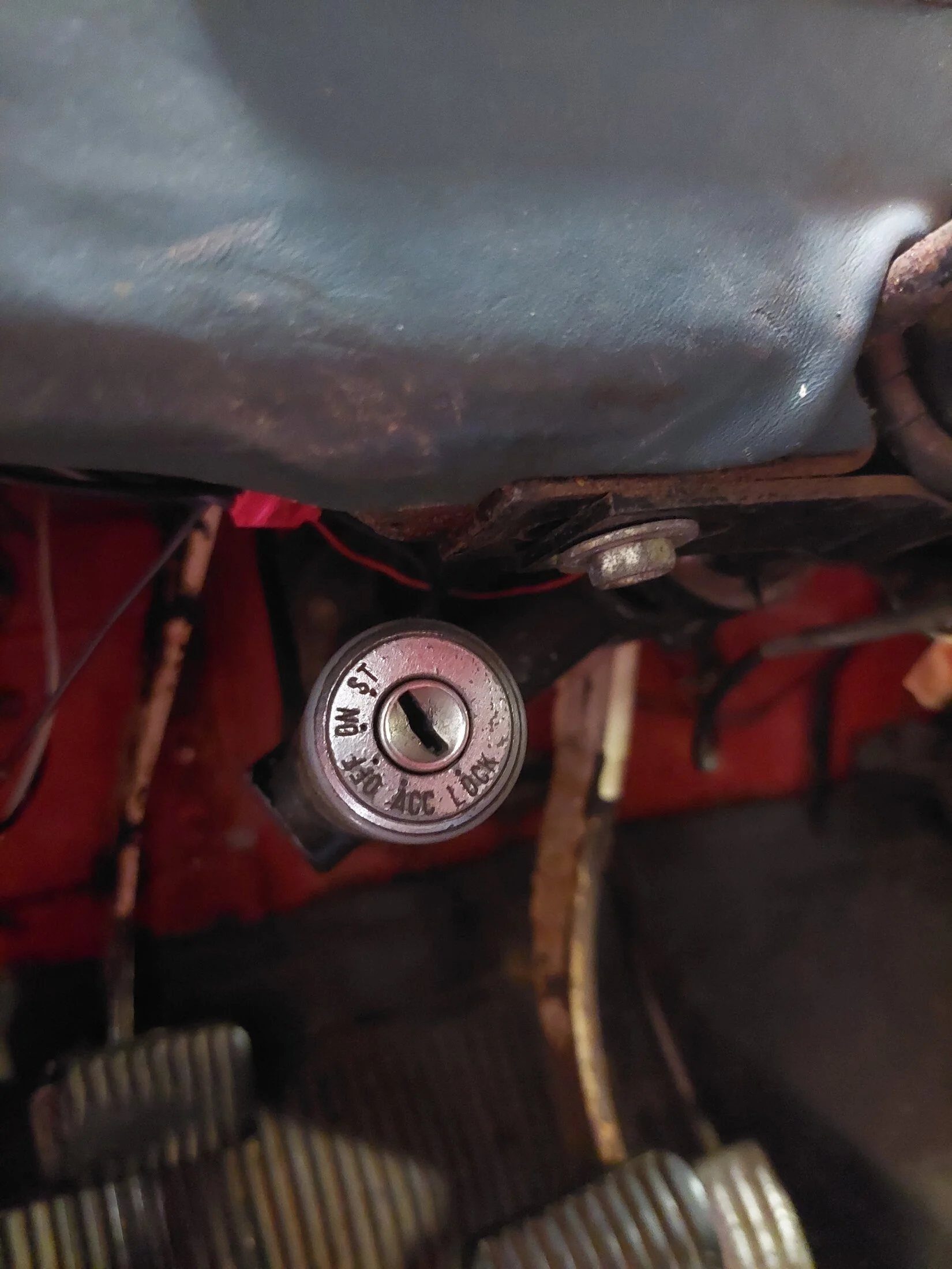

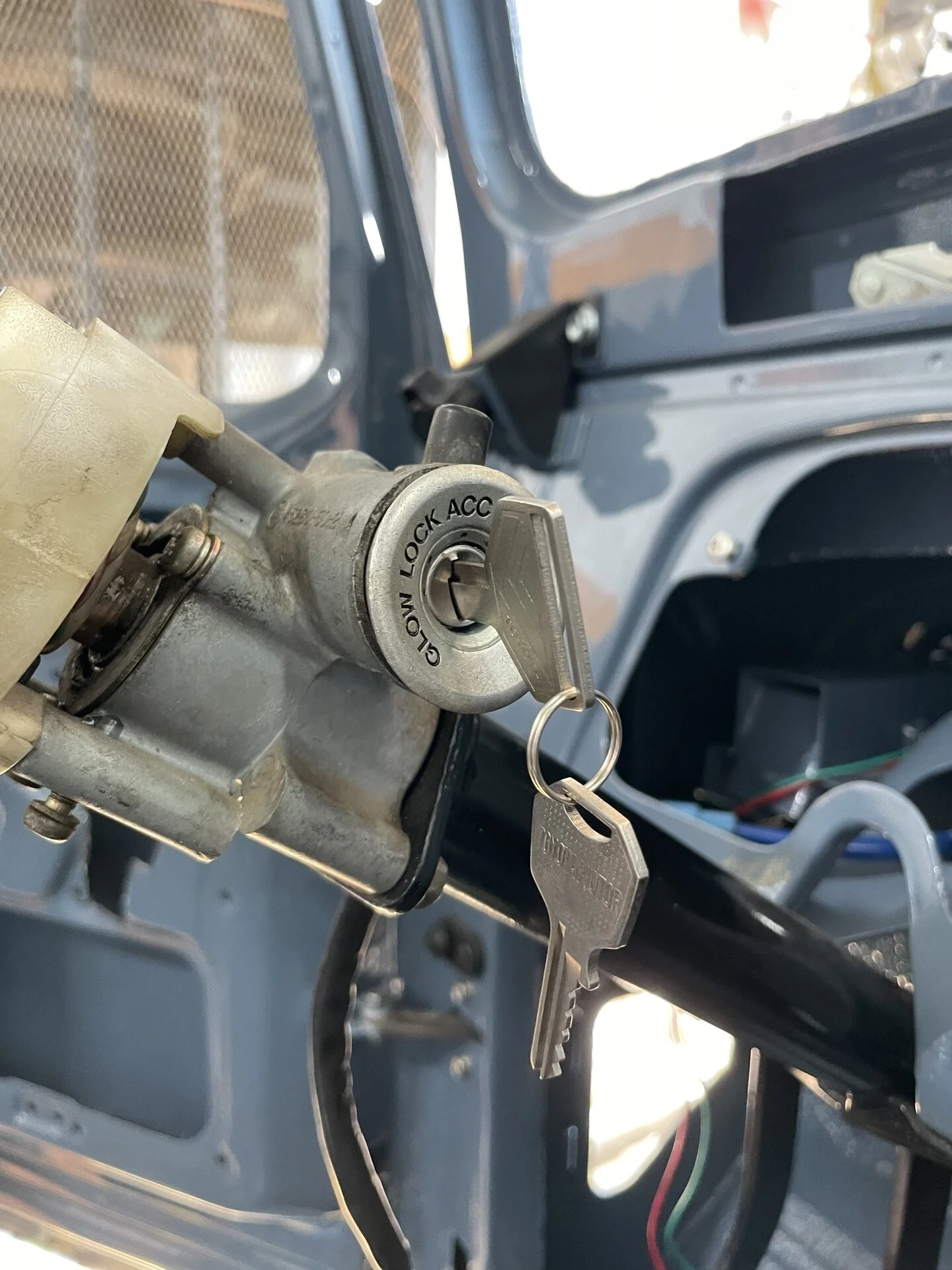

Hi, bought an FJ40 some time ago and I'm missing keys for it. I would like to take it to lock smith if he could make me new keys for it. It's in Lock position, how do i remove it from the lock barrel?
IIRC you pick to on position then there is a small hole somewhere around the body that you push a wire in to push down a tab and the core should pull out, the tab will not push down until cyl is turned to ON position OR there is a cross pin ( roll pin )in the body that needs driven out before cyl will pull. I do remember sometimes we had to drill the hole to access the lock tab, we had a jig to show where to drill the hole.
Ok, as I don't have a key then turning it to ON position is bit hard or do these turn with some other suitable "key"? Or just buy a new one?
Or is there some place where there might be key code, for example in drivers door lock? Mine has locks in drivers door and in rear ambulance door and also in fuel cap.
Thanks in advance, I'm a newbie with my FJ40 project and been stuck for a while with progress with my project.
Picking the lock isn't all that hard, so you can remove the cylinder. Making a key or setting the pins isn't all that hard either. Yea those other locks might have the code for them, might no be the one for iggy. A lot can happen in 50 years to stuff with several PO's.

well well ....
this is a 1st , but so is each day in the vintage land cruiser world ,....

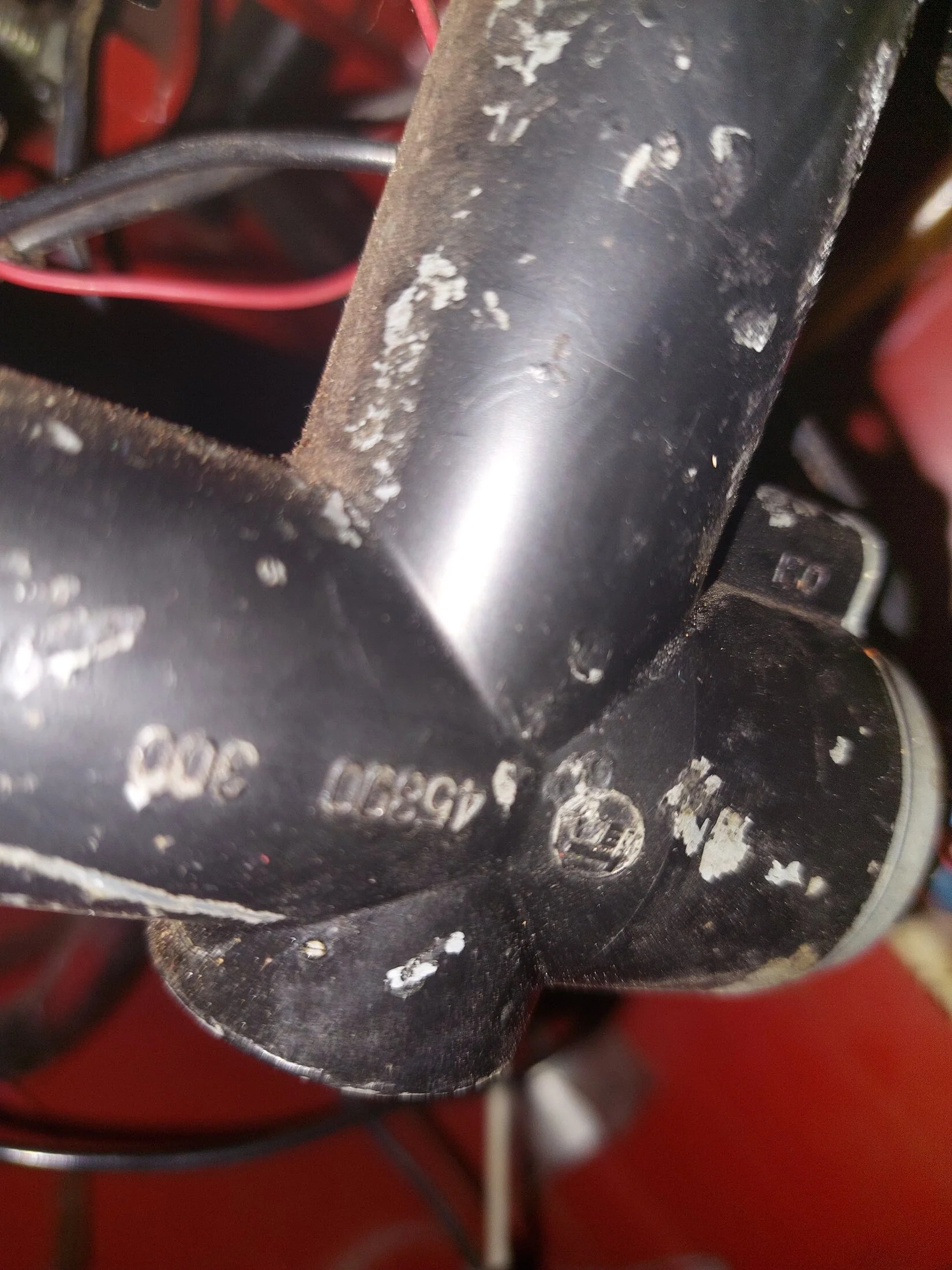

that is in-deed a OEM TOYOTA ignition switch key lock assy.........
mosey likely a CROWN or CORONA / CARINA MARKII
note the
TEq cast logo on bottom , and the # 45890 200
i must say WT......F 😆
show us your 1973 Steering Column Please photos below , BOTH Sides .....
yes , & more then only 1 Photo , more then 3 is good-show ...
you should have this set up below ....?
we shall see ..
i do however highly high respect , like
A+ Level the use and incorporation of a Vintage TOYOTA 84051- # # # # # ,
the is NOT a P.O. subject matter ....matter ...they are here-by officially absolved of any such snarky-ness :wrench::wrench::wrench:
in the mean time if anyone can help smoke-out the OEM offender , bolted under that 1973 Switch-Panel fender ? please share your thoughts ....

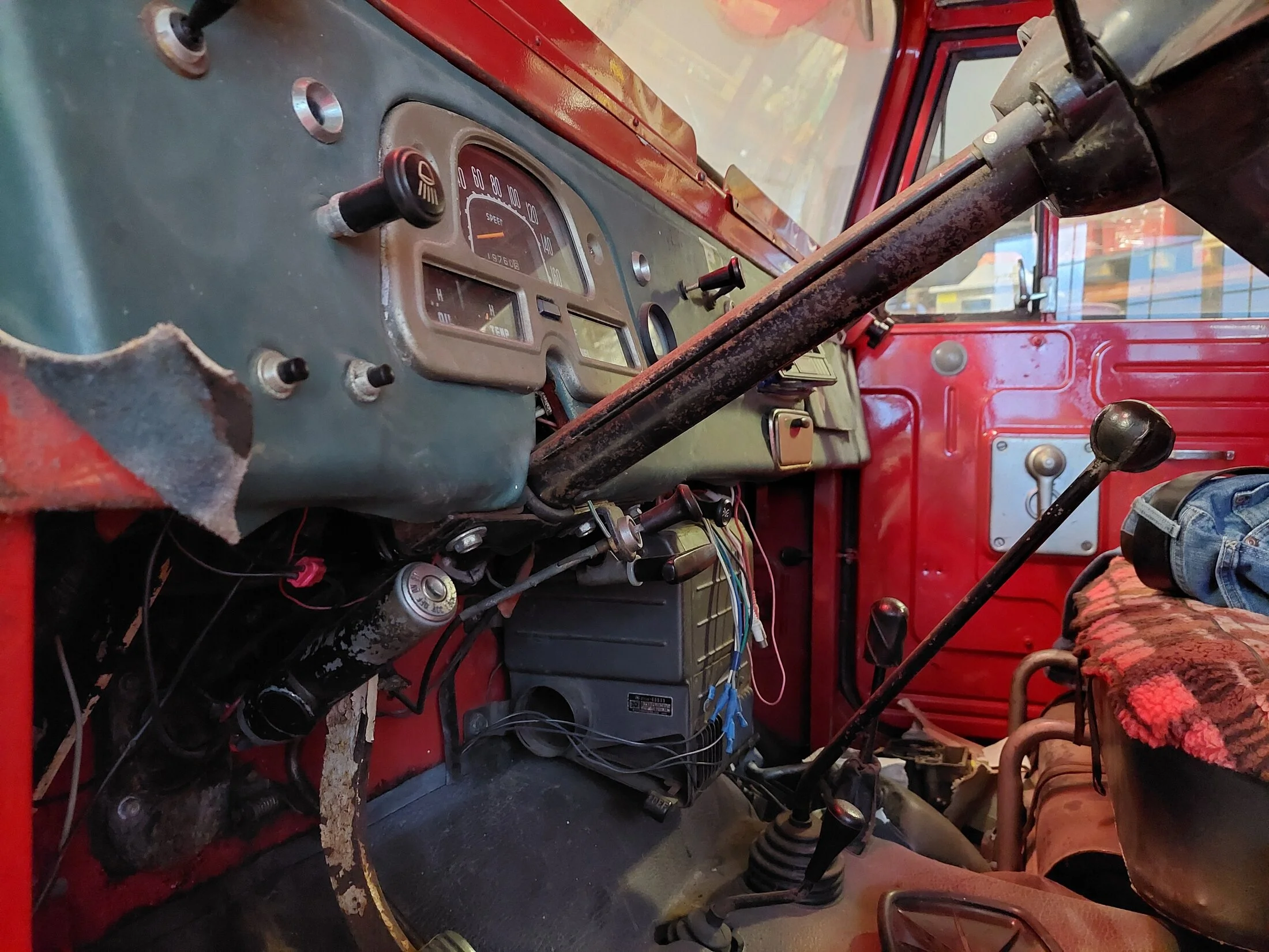

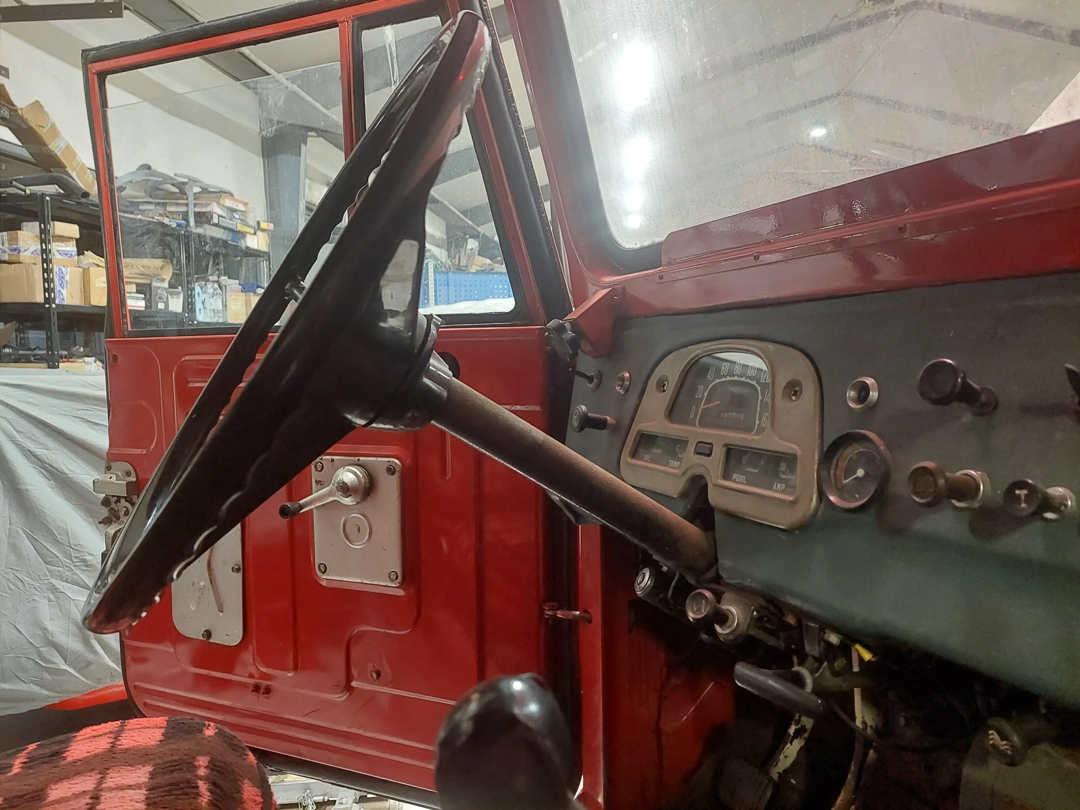

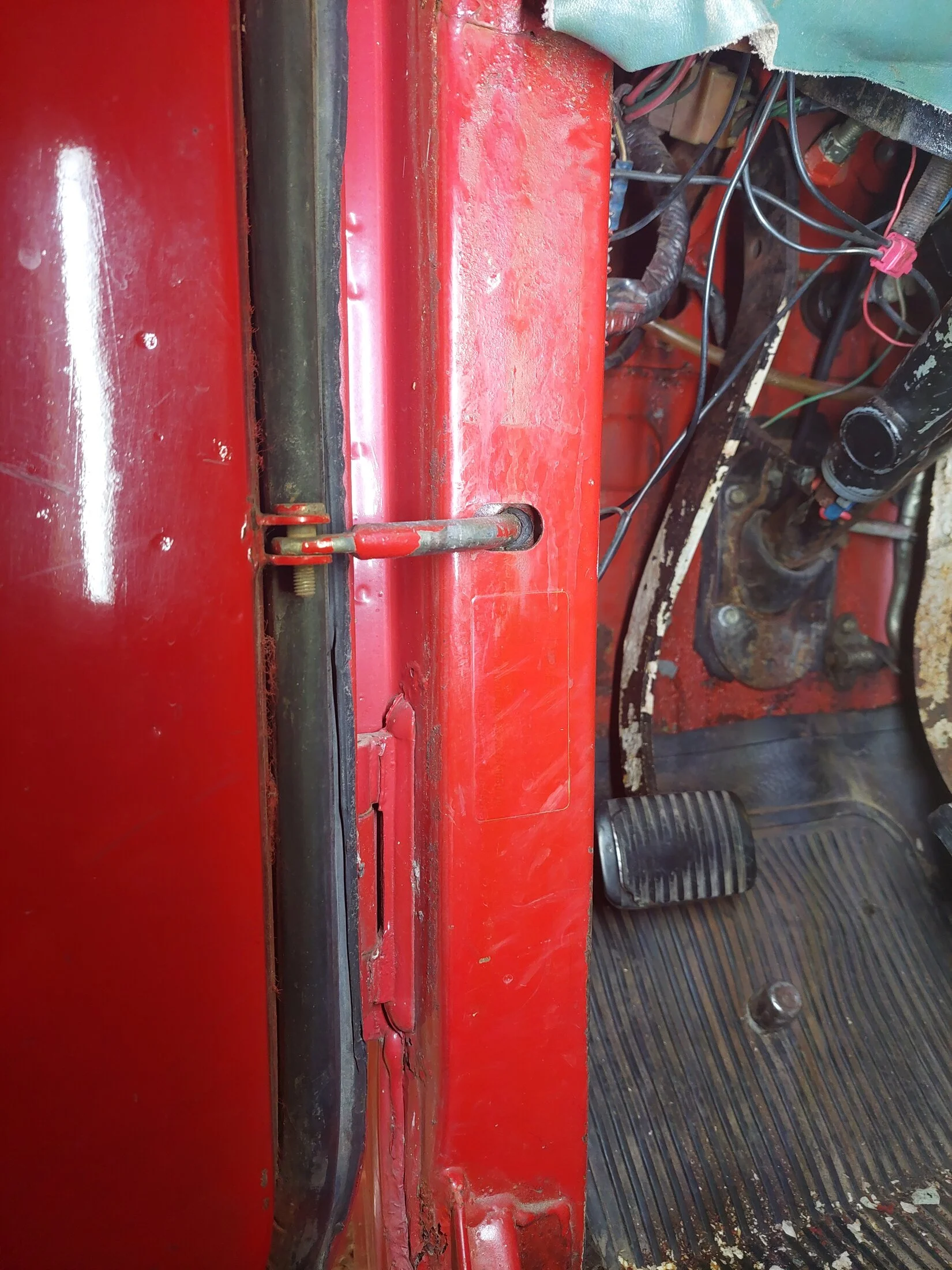

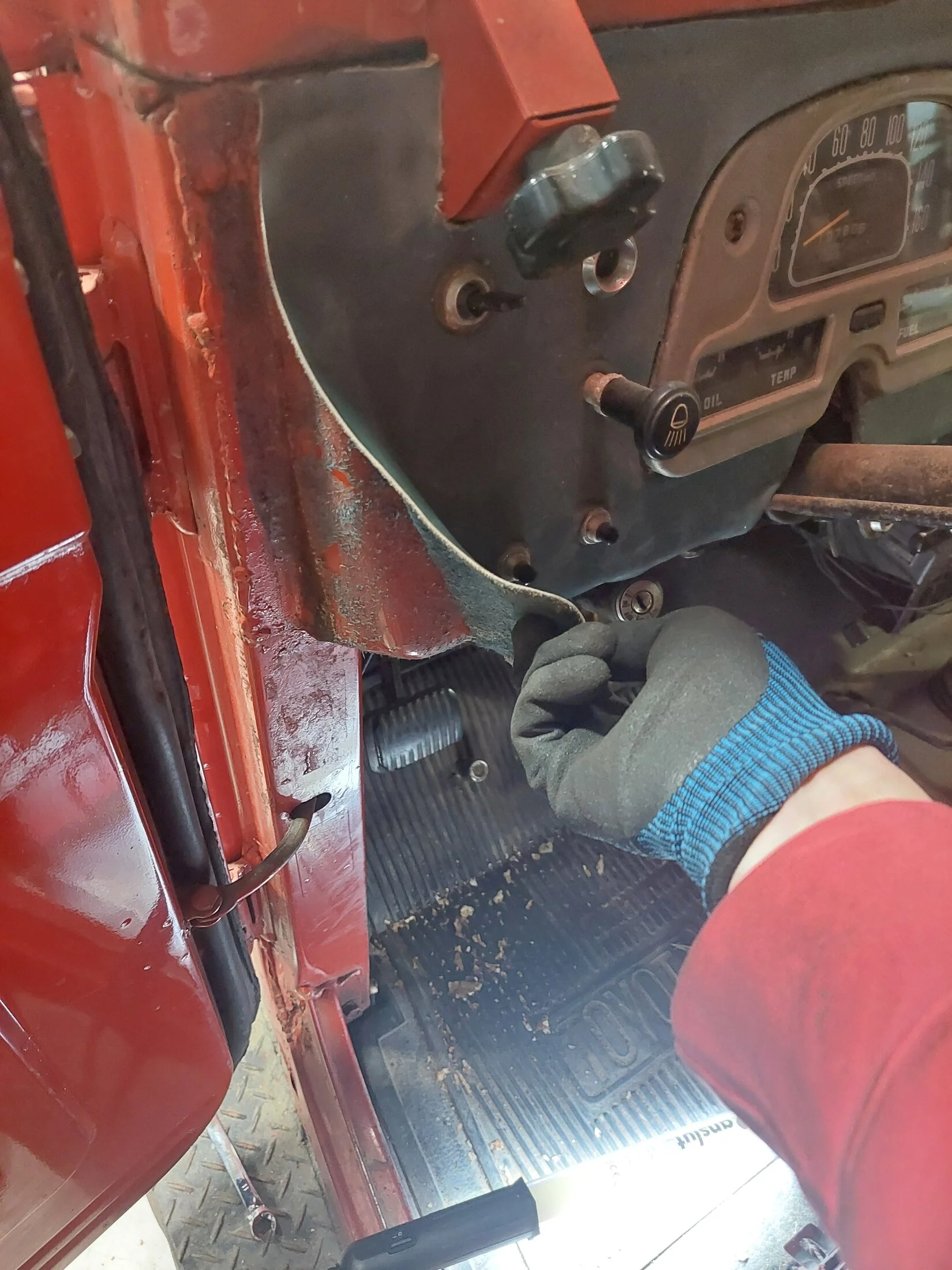

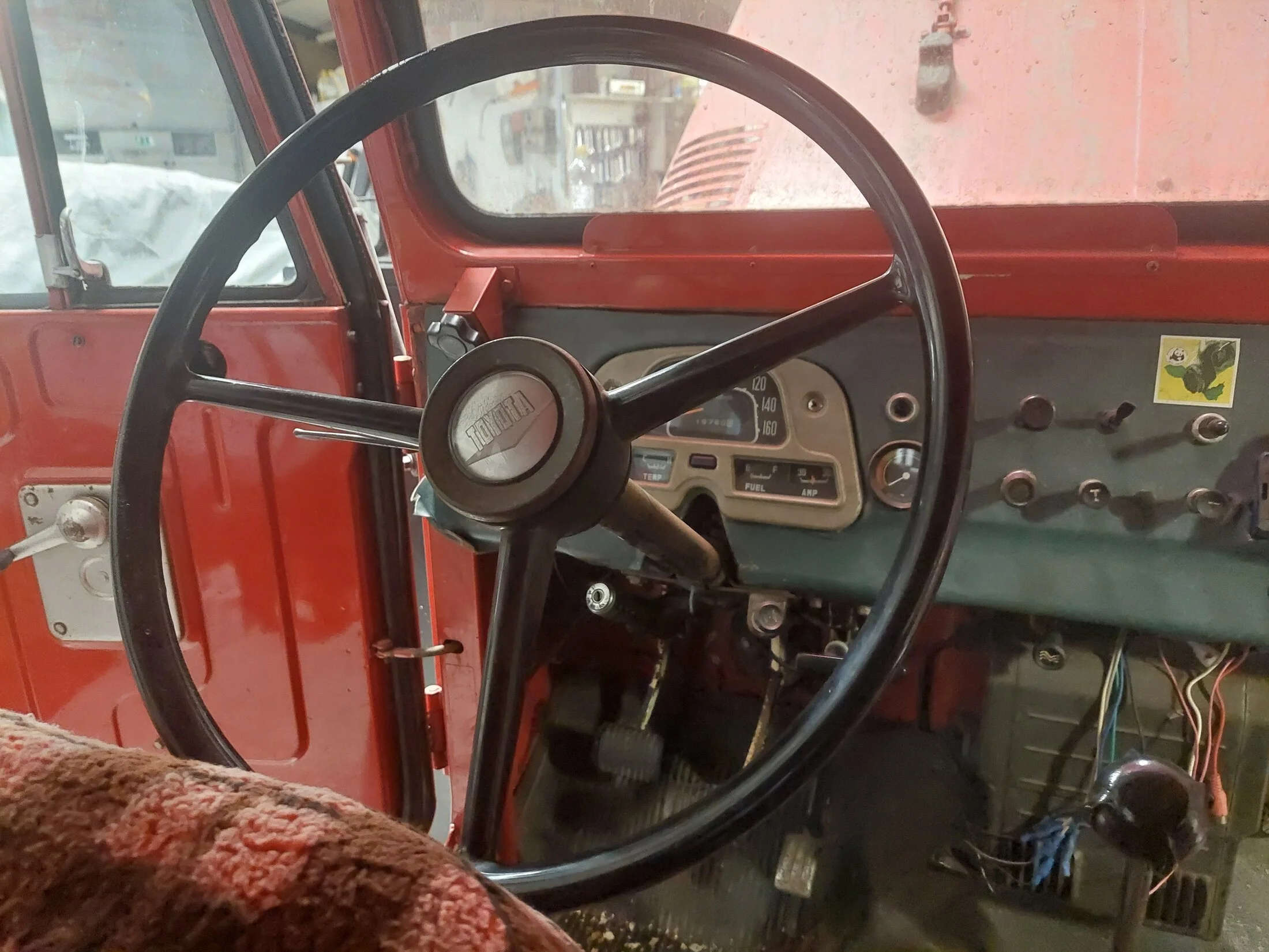

Well that reply was interesting 😀 wondering what has happened here with this one. Here's few more pictures that you asked for.
your drivers side door jamb has a DATA ID Plate ....
the production date is stamped on it ....
1961 - 9/72 was the production dates of your steering column and the in-dash ignition switch set up all things 40 series BJ FJ
10/72 - 10/85
was the column mounted ignition switch & lock cylinder all things 40 series BJ FJ HJ
- you have a Red Paint GHOST mark i see on your drivers side door jamb , where your USA Spec. and some other market regions had DATA ID Plates
- i do not understand the
green paper-type media that is peeling up lower LH corner covering your dash ? is this like kitchen cabinet contact-paper type stuff ?
hummmmm .....
this is a unique-mystery ready to be unveiled i think here .......🤔

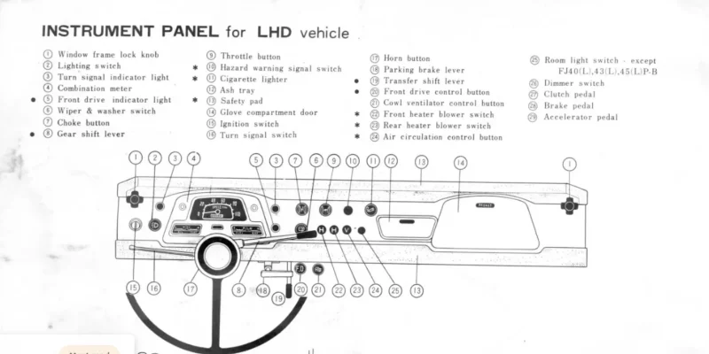

Now that Matt points out the paper...it looks like a leather covered dash...maybe that is covering up the hole on the dash for the switch.
Sorry can't help how to remove the lock barrel however based on my '73, there are a number of differences in the dash pictures (Read lots of "PO presents")
  1. Key should be on the right hand side of the column like in Matt's pictures. I'm not sure exactly when the change of location occurred in the model years. My truck was manufactured in 09/72.
  2. Knobs look like a mix of old and new.
  3. Layout of knobs does not look right. There are heater controls missing, the choke is in the wrong location and there is an extra indicator light to the left of the console to name a few.
Are you sure your truck is a '73? Not that it really matters, but there are some unique features with a '73 that might create issues when you are working on your truck. 1973 Model Reference - https://forum.ih8mud.com/threads/1973-model-reference.1334054/

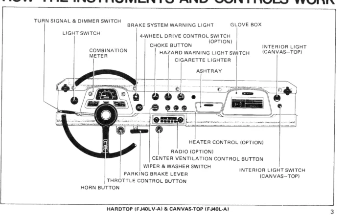

Here is the '73 dash layout from the owners manual.

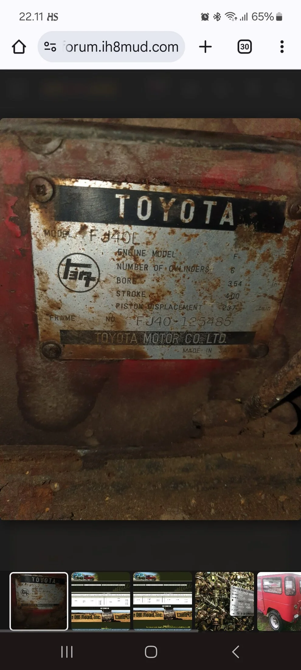

Hi, that Green-paper type media is just, as someone mentioned, kitchen type rubber mat that someone has glued on top of dash.
There are no ID plate, only red painted rust protection stamp that previous owner has get done on body at some point.
I think this might be that 09/1972 model, first registration was early 1973 so that confused me.

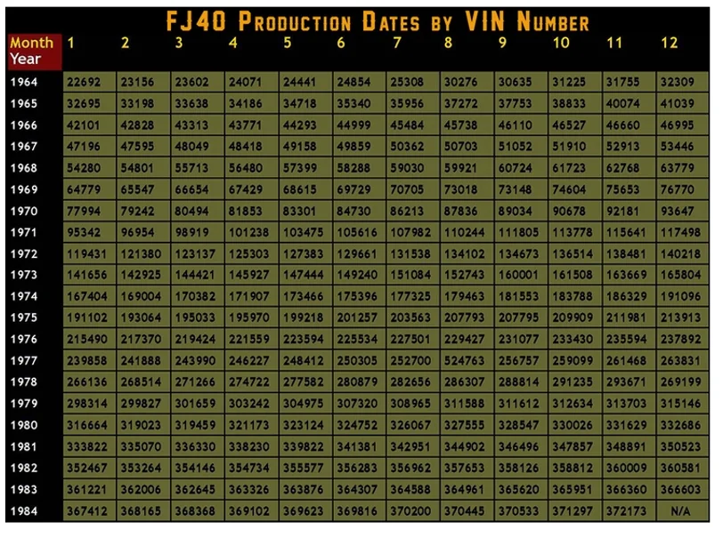

Based on the VIN, I'm guessing your truck was manufactured in April/May of 1972 based on the table below which makes a 1972. I suspect there is a hole in the dash where the OEM ignition switch should be located underneath the rubber mat.
This is dash layout for a '72
