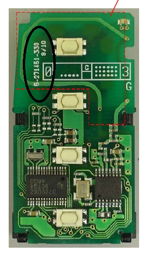

I bought a used keycard for my make model year for about 85$ (its cheap because its used - not virgin), make sure you buy the correct keycard which matches the ICC code on your existing keyfobs which are working.
For 2011 LX this is the model I got from Lexus Smart Card Key 89904-50480 / HYQ14ABB (OEM) - https://southeasternkeys.com/products/lexus-smart-card-key-89904-50642-hyq14abb-oem-copy?variant=43866138771663
