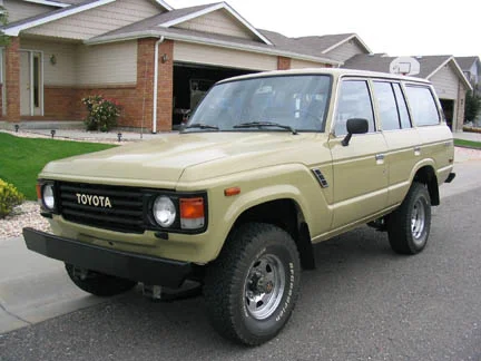

Well, I'm officially out of the red Cruiser club. Now she's "beige" #4E9. It was an '87 color. It was done with the help of some friends and it's not perfect but certainly a huge step up from where she was.
Prepping the body
Fresh paint!
Back together

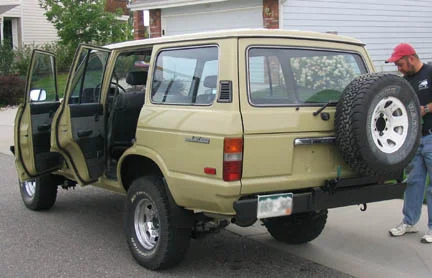

Got my lift to where I wanted it also. Slightly higher in the back.

Thanks for the comments.
We cut out the rust around the rear wheels and a few spots on the rockers and replaced with new steel. The rest was minor dents, scrapes and surface rust. We used a new tailgate we found in the junkyard from a blue '87. Fabbed a new front bumper and reworked our previously fabbed rear bumper with a heavy-duty pivot for the spare carrier.

With a compressor, sanding attachment, spray gun attachment and a few hundred dollars in sandpaper, tape, primer, sealer & paint, the rest is pretty much labor. It took us a few nights to prep it before priming and then we wet sanded the primer coat which took us a few nights. Now that I've gone through it once I could do it much faster. How well you prep the body is what dictates all the time and how well your finished job will come out. We did an OK job but her main purpose is bouncing around the mountains so we didn't take the time to make it too purty.
The guy that helped me said "Well, you can take it to the car show, but you won't enter it in the car show."
