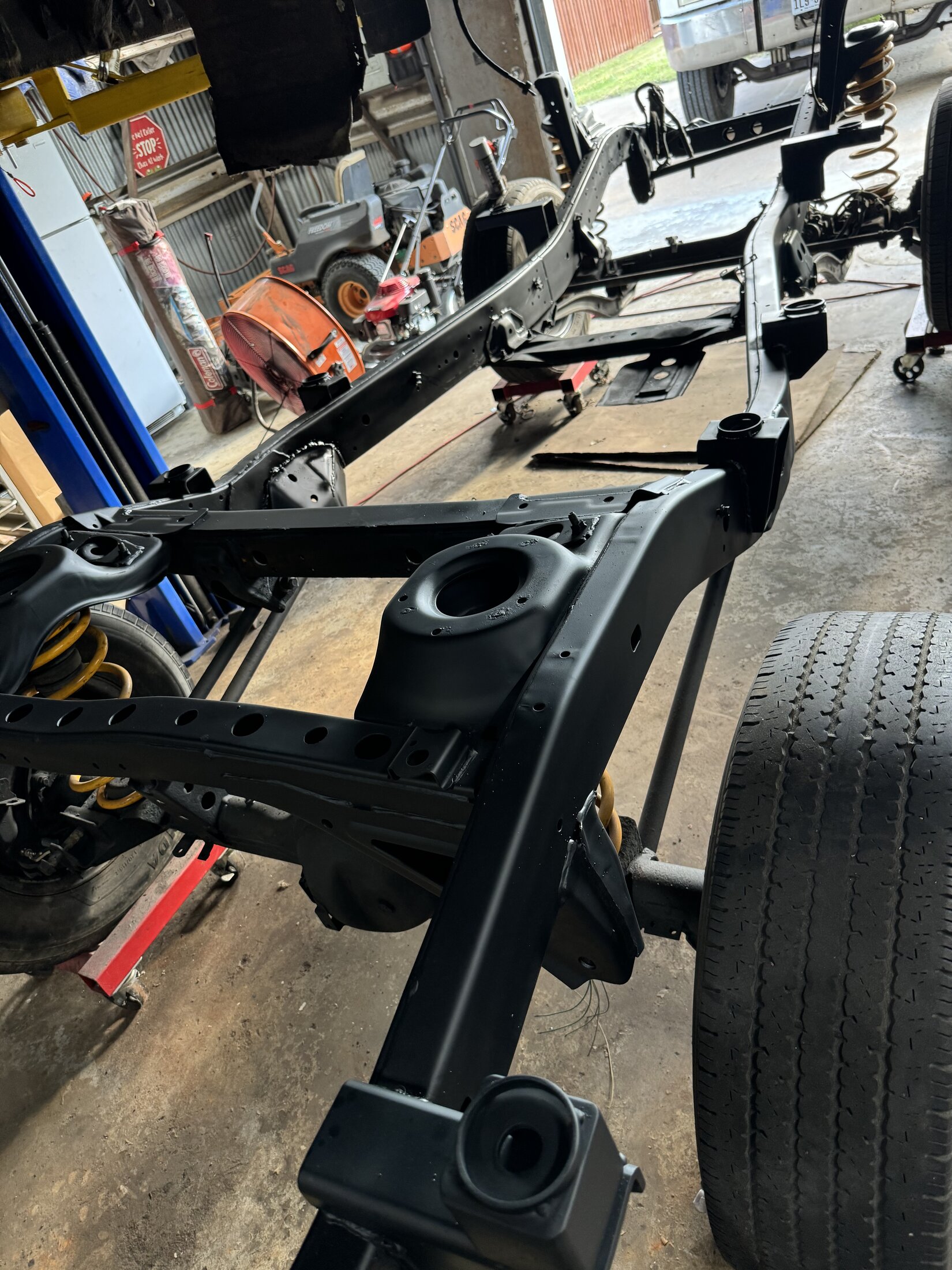

If you are not driving in the winter, keep it simple. POR 15 needs surface rust to bind. Sandblasting removes that. Galvanizing is good if you plan to drive it in winters, but painting over it requires proper prep for adhesion and you have thread chase or protect every bolt hole because galvanized coating gets into every nook and cranny. Welding on galvanized surfaces releases poisonous gas. I am doing a frame swap at the moment and used rustoleum rattle can on top of self etching primer. It lays on like butter and tough. Others use John Deere Blitz Black which is also excellent. Chose the rattle can route as its easy to touch up without additional paint gun prep etc. Shake and spray.
