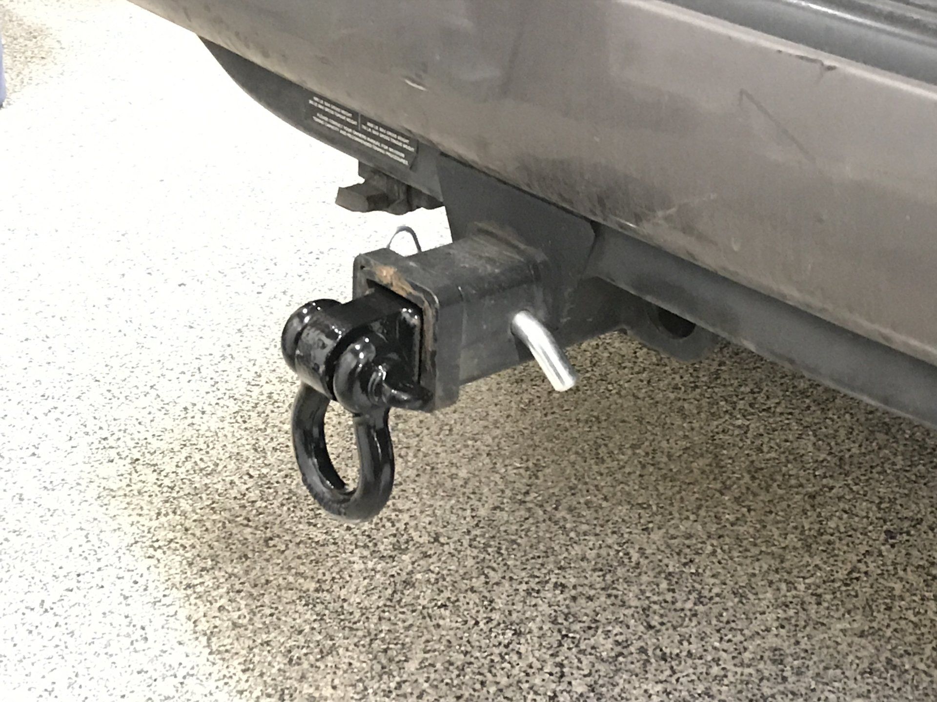

Trail Tailor up front w/Rustoleum.
Hitch shackle in back.
