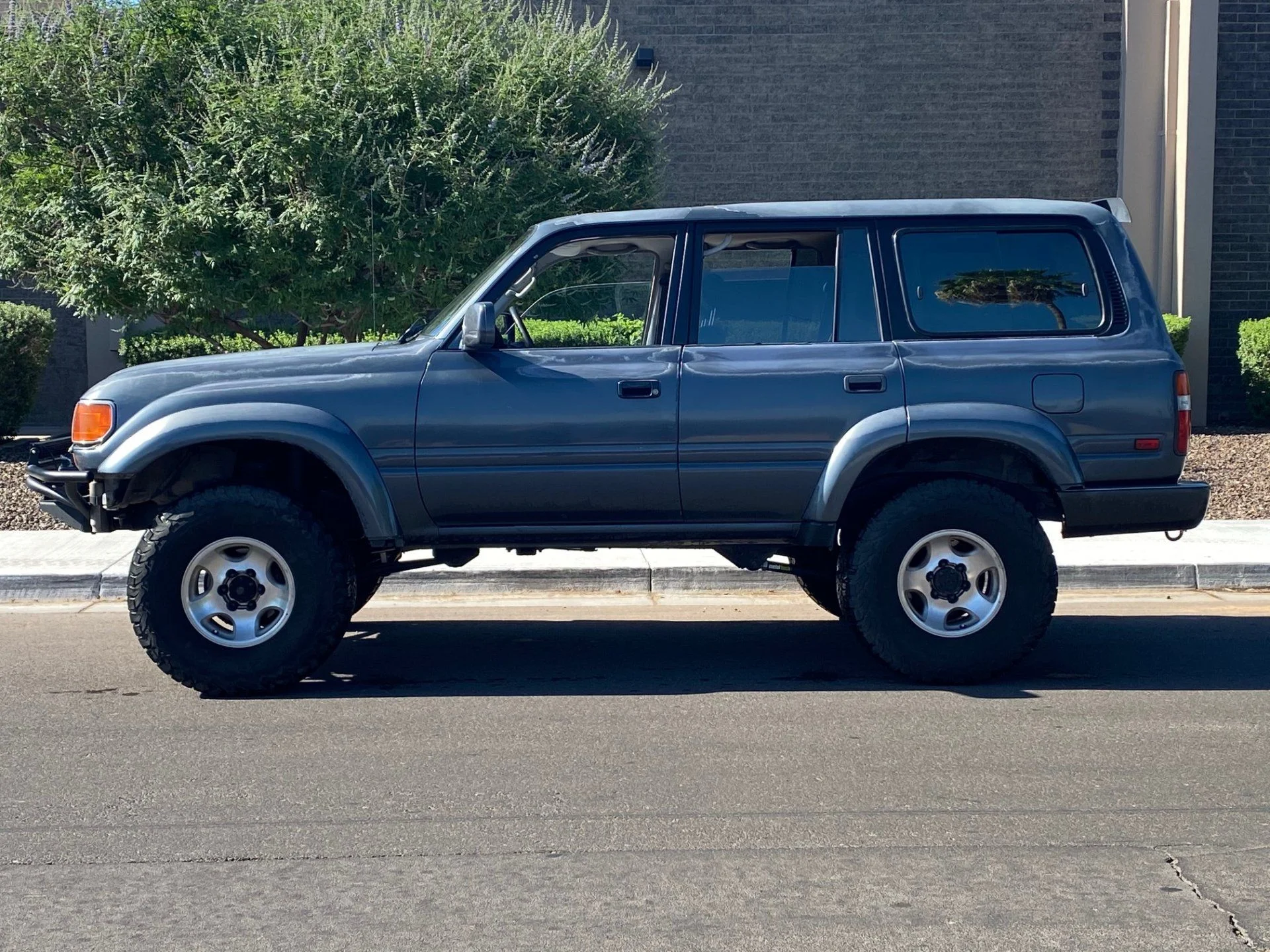

I am running the OME 850J and 863 with 30mm spacers on top of both spring with the longer OME shocks to allow for a little more travel. If it makes a difference, in the rear I have Metal Tech upper/lower control arms too. Here is how my LC looks from the side.
It's all subjective you could technically run 35s with no lift whatsoever. There are just too many variables when you say run does that mean go to the mall or run the Rubicon Trail. Is your rig fully outfitted to Overland are you running basically stock.
