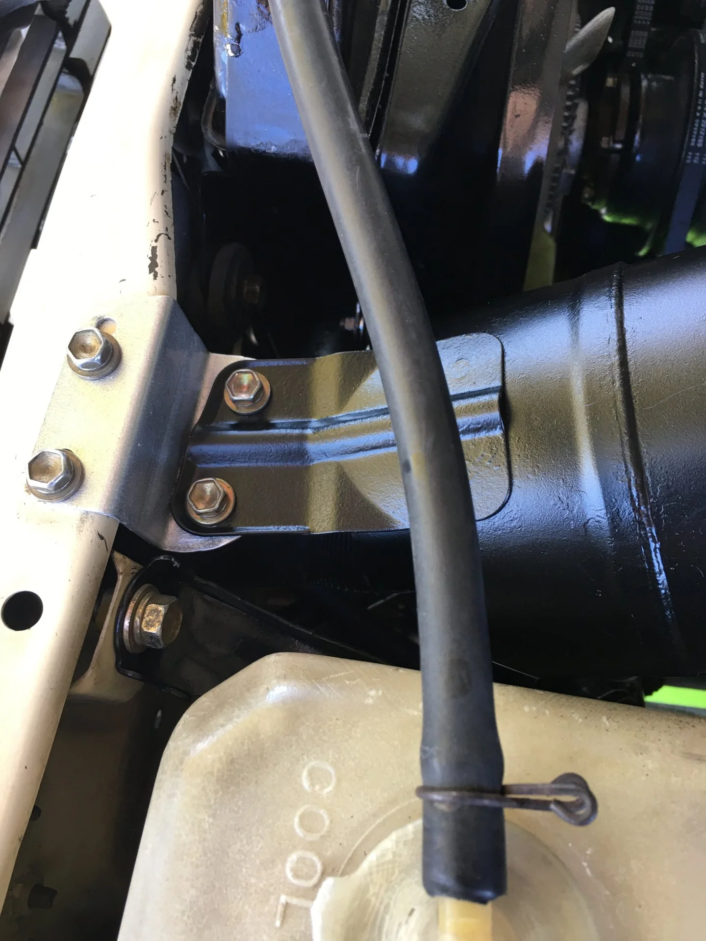

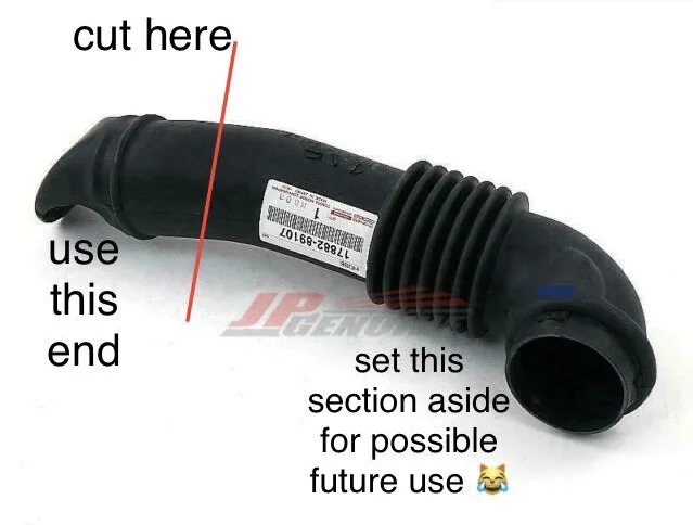

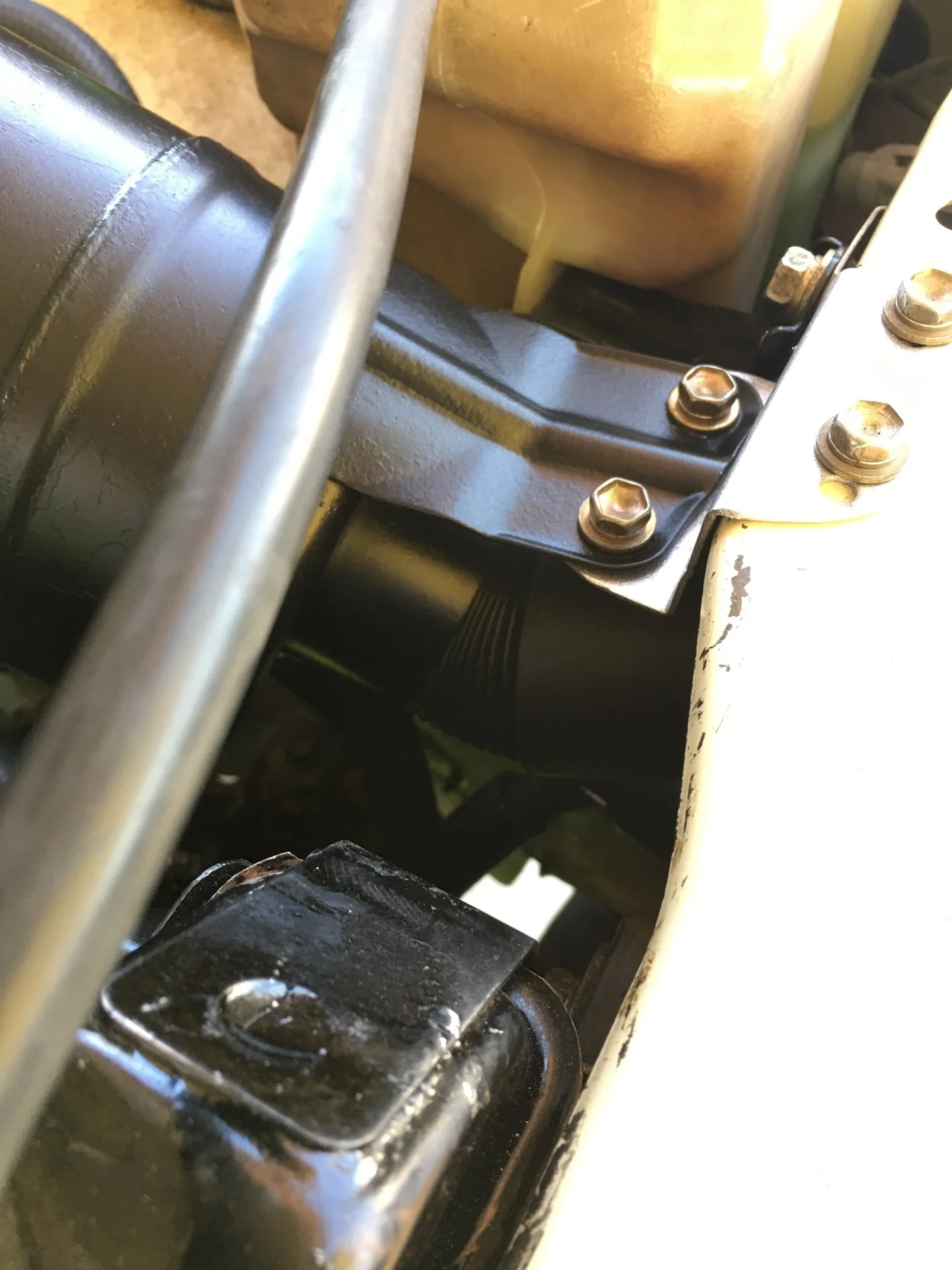

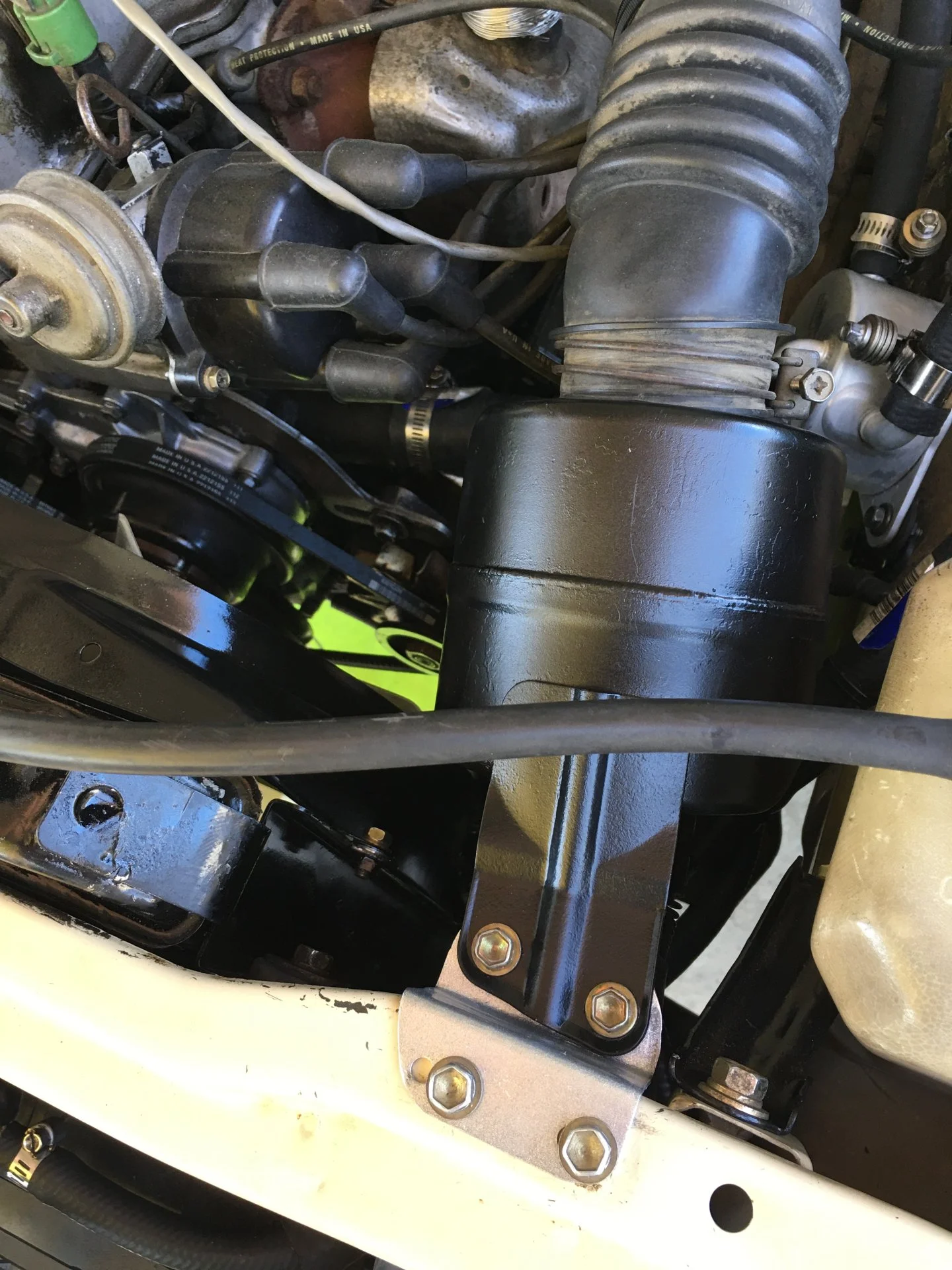

does this count:
couldn't find air snorkel w end that goes into rad support for '83 2wd
used to have plastic open "trumpet" suckin in everythin including bugs & crud
looked & looked oem nla
so ordered later snorkel & cut to fit
due to angle had to make bracket to step it down to meet up w metal part so wouldn't pull snout out of opening in support
used section of ribbed plastic was runnin before to bridge the new snout end with existing metal & it works - don't get nasties in air filter housing like before
