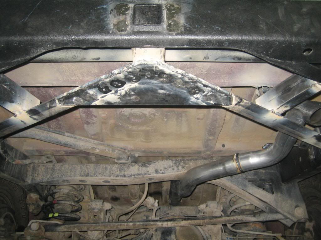

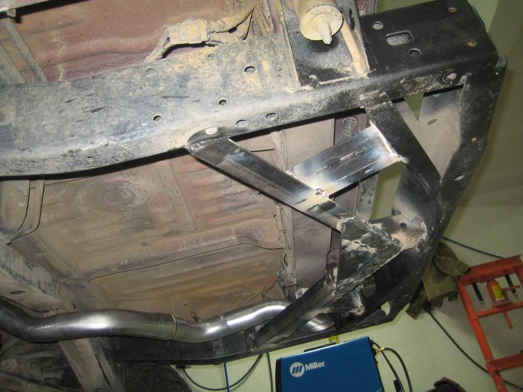

Finished product:
I like that you tied it into the frame rails in the pictures in your last posts. The original design and initial setup is pretty much just tied into the rear crossmember/bumper support. Even though those 4 bolt holes can bolt up an OEM pintle hitch or receiver I wouldn't trust it. IMHO, its a Class 1 receiver from the factory. Many people applauded your efforts initially, but remember your just tying into the rear bumper/crossmember support and not the heavier gauge metal frame rails.
The Class 3 receivers that are on most 80's are made up of a much heavier steal and tie into the frame with 6-8 even more bolts.
