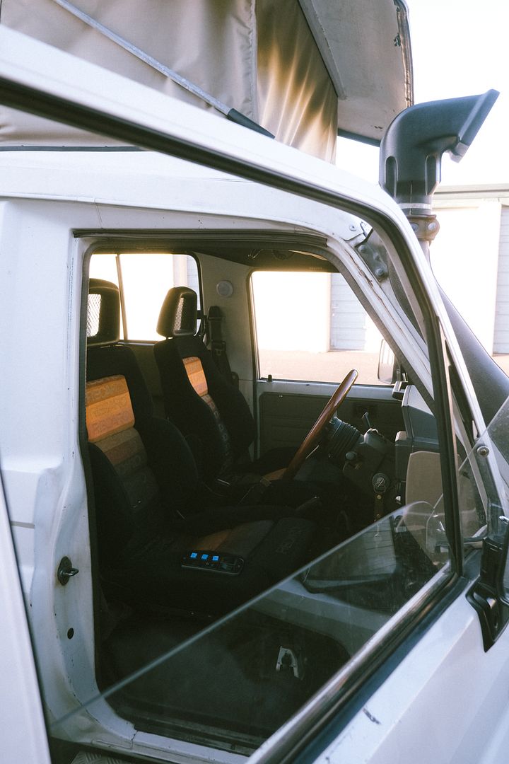

I made some brackets in a matter of hours to fit my seats. $30 worth of steel and a few bolts. I just have two 2" wide crossbars per seat fit to the Recaro, and then the Toyota sliders. 8 holes total per seat, 4 per crossbar. I'd recommend this route over the headache of trying to find some adapters, I don't think they exist.
