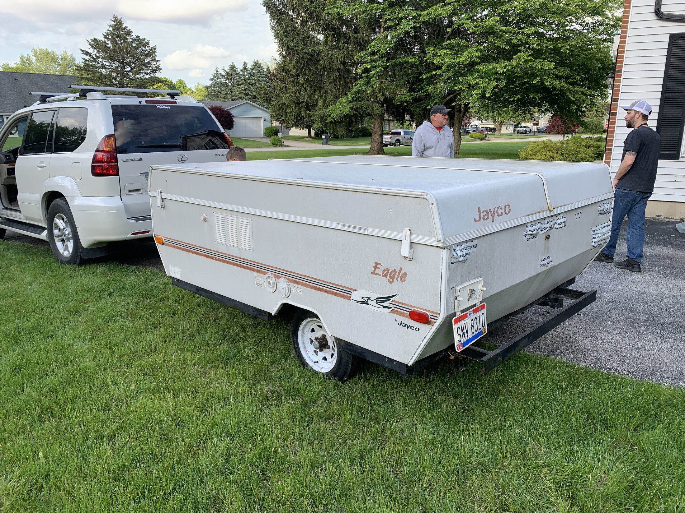

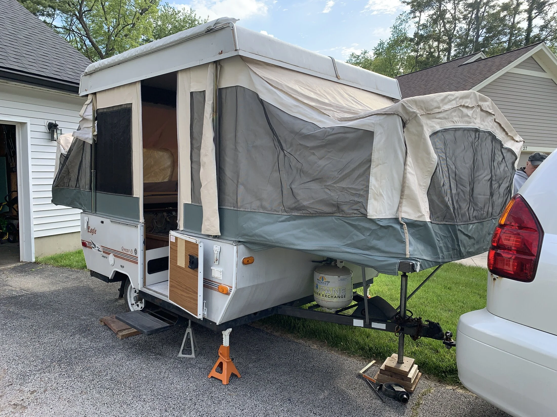

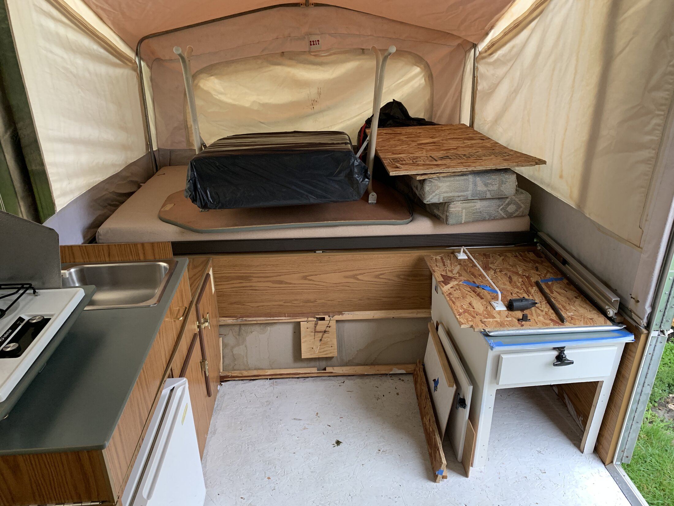

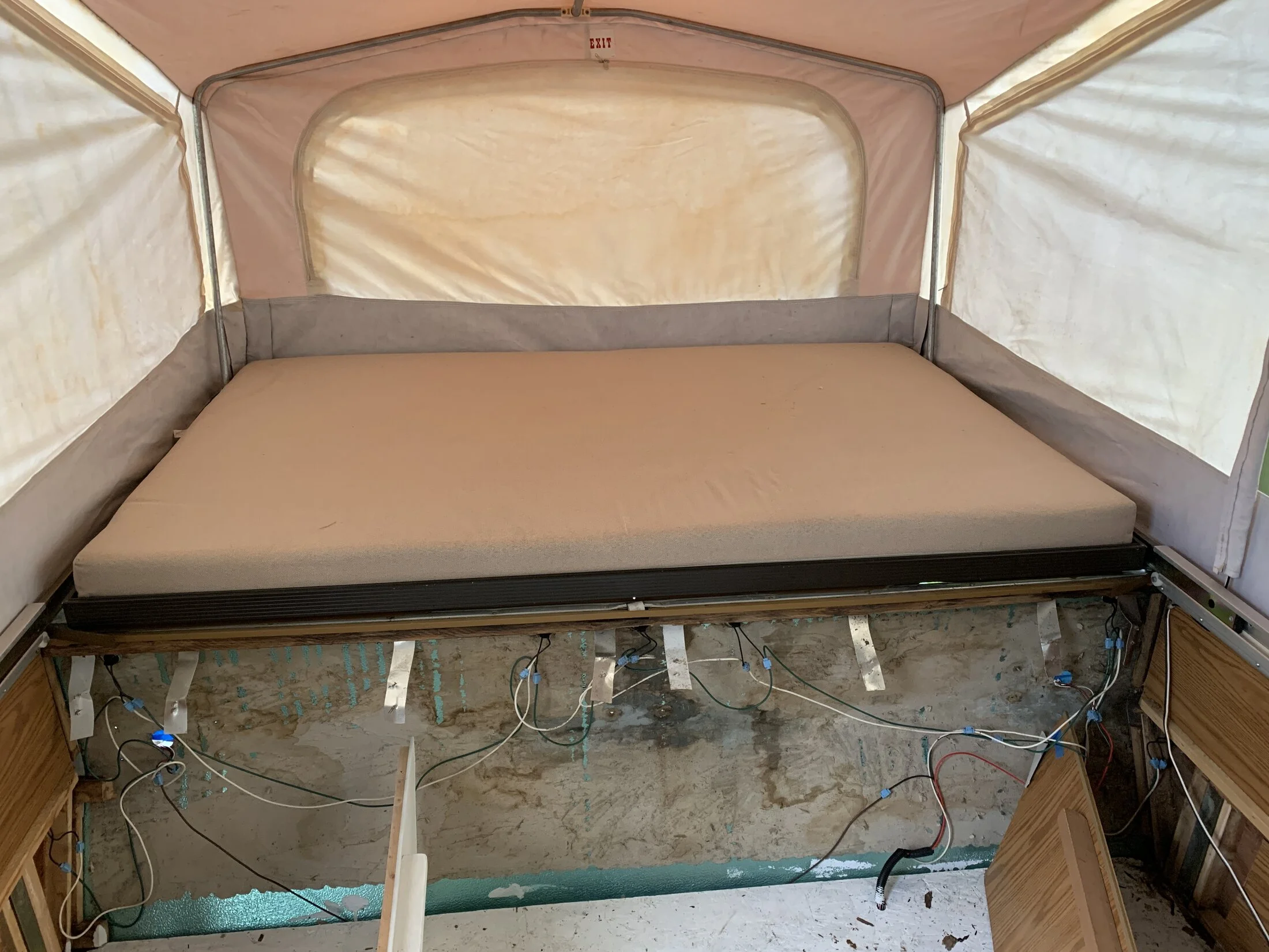

Removed all 4 Cabinets in Interior including the Propane Line and Electrical and Water Line - 1 Hour

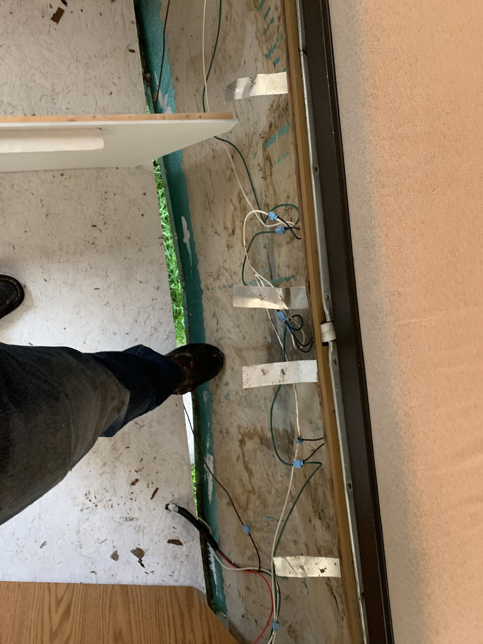

Removed the Floor. Found Rot at Front Right Corner and Along Rear. Water and Sun Takes these Trailers Out. The Sun Cooks the Sealant then water gets in unknowingly and Rots out the Frame.

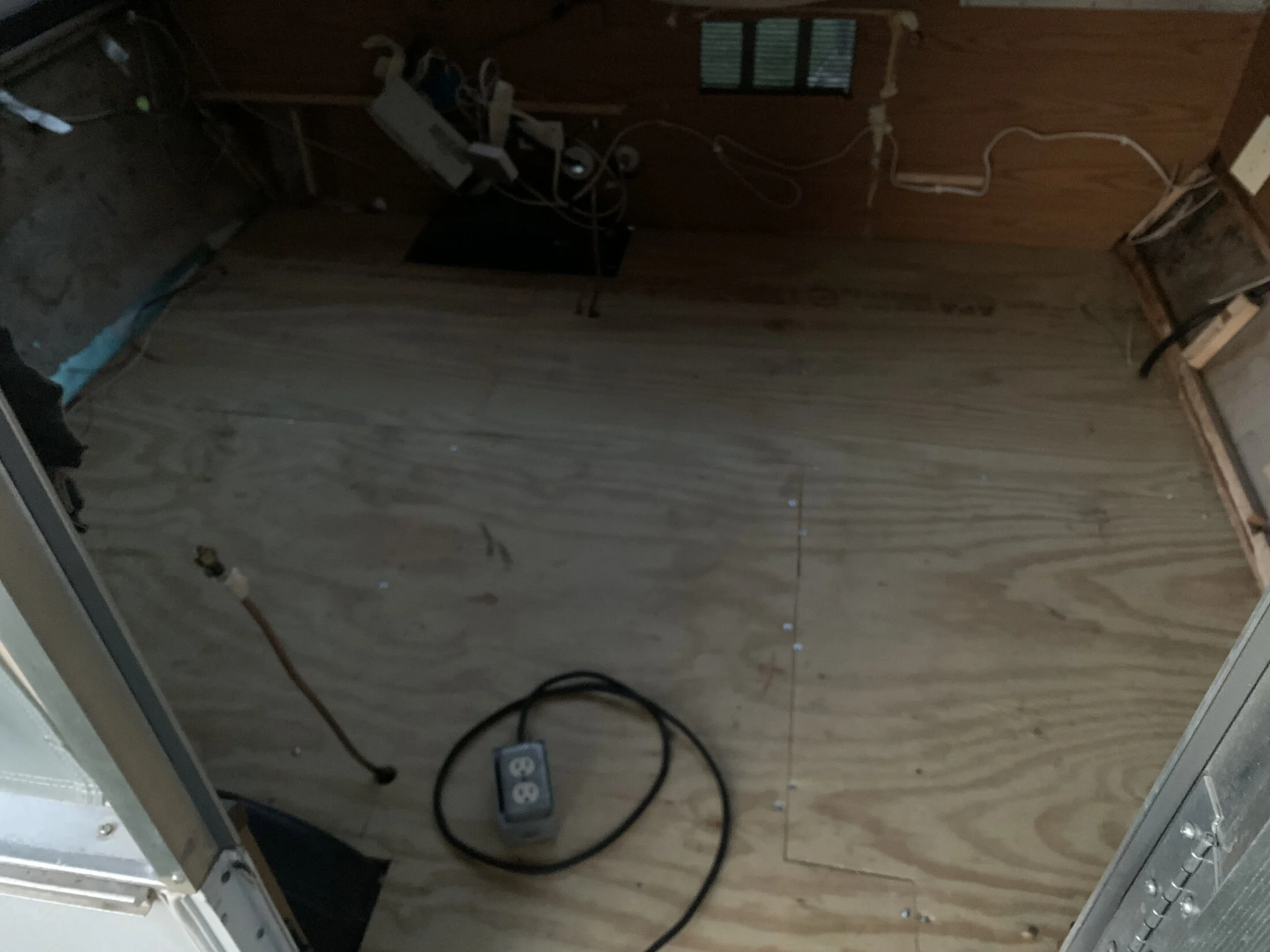

Removed 9/16" OSB Flooring and Replaced with 3/4" Treated Plywood (2 Sheets) $106 from Menards - Took 10 Hours
Screwed down with Tech-Screws
Had to Lift off walls using Floor Jack as Walls sit on Floor.

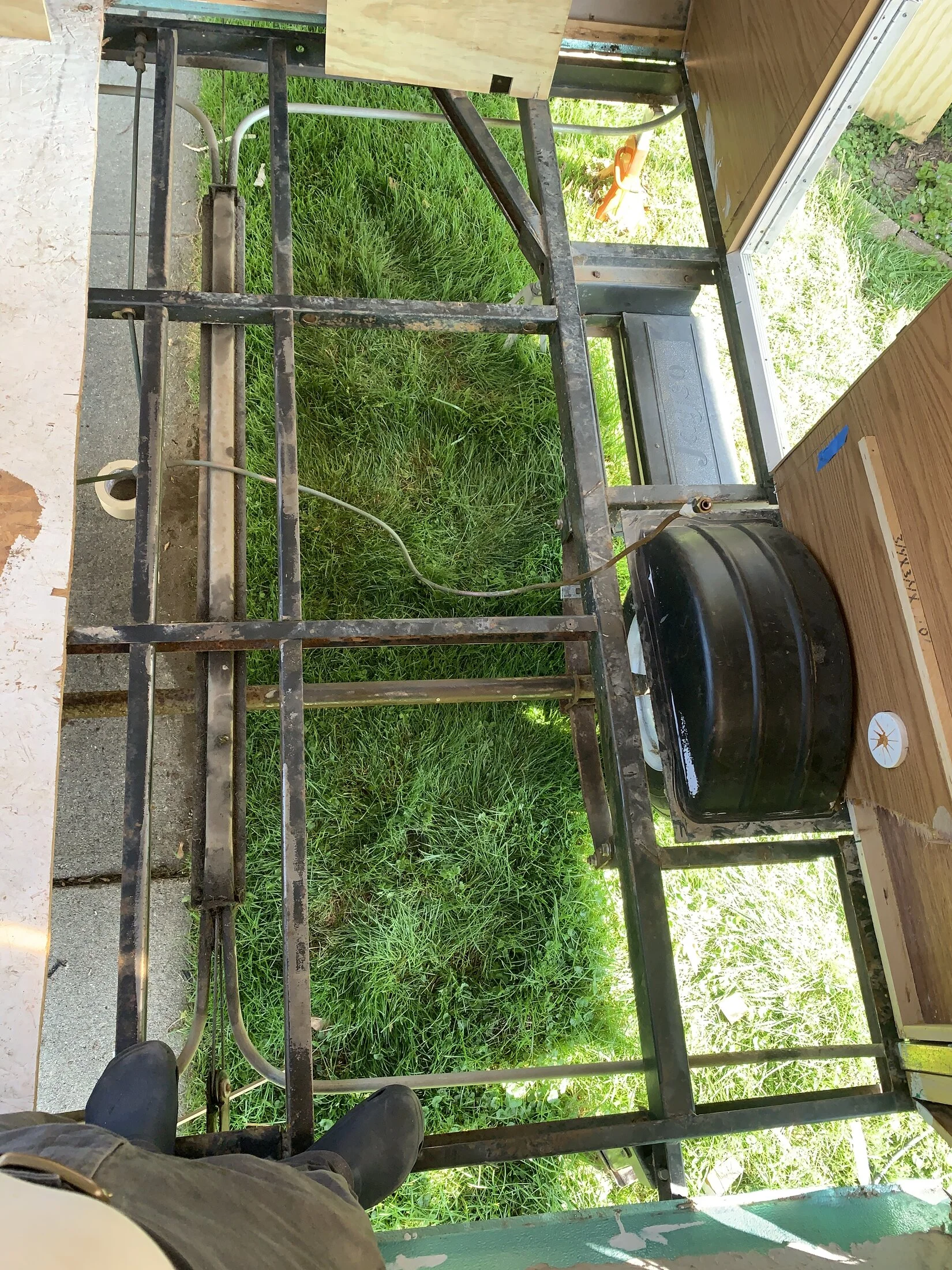

Trailer had Light Surface Rust.
Hit all that was Accessible with Wire Wheel in Angle Grinder & Drill

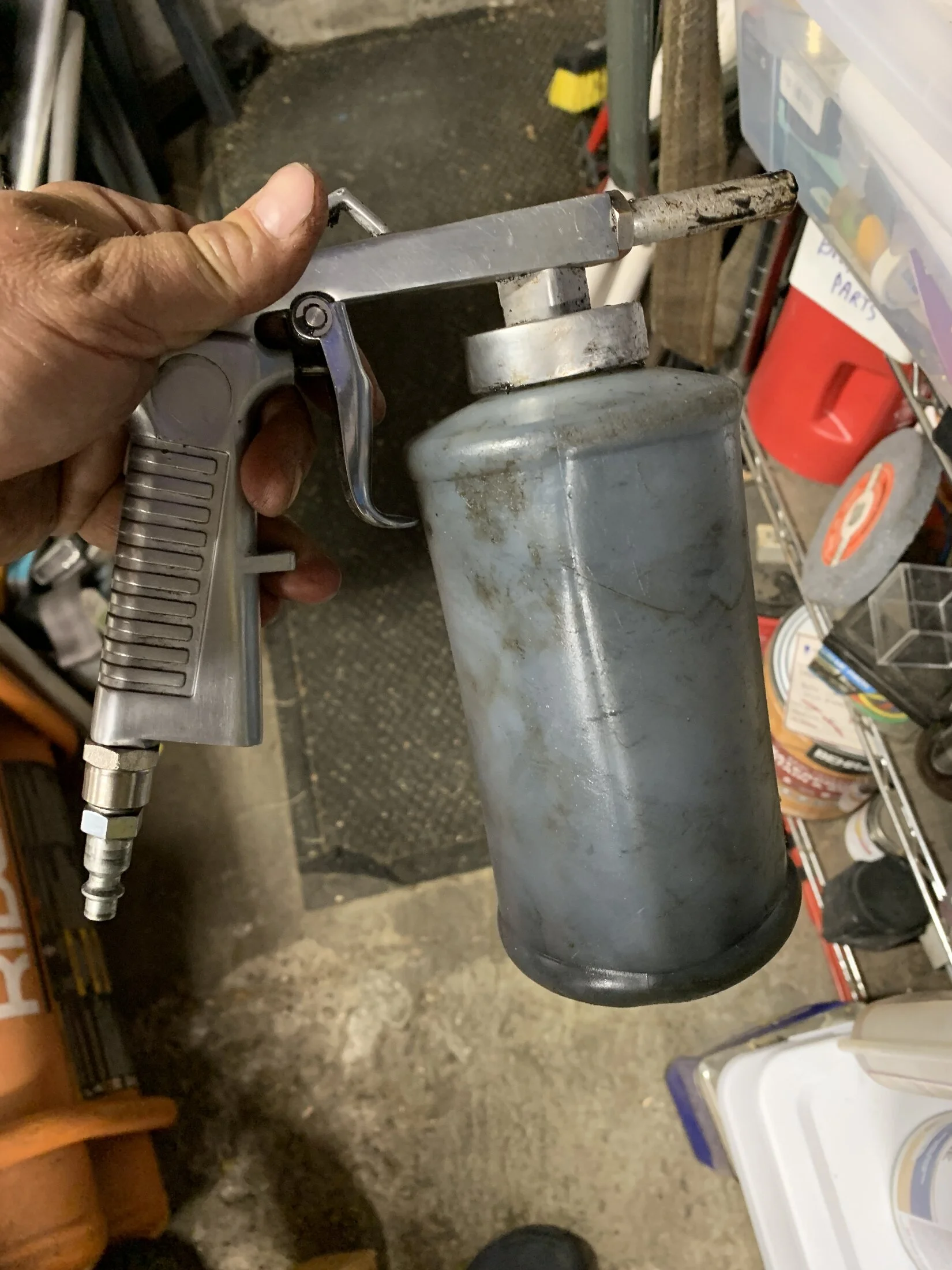

Sprayed with Fluid Film ($40 Amazon) and Astro Sprayer ($30 Amazon)

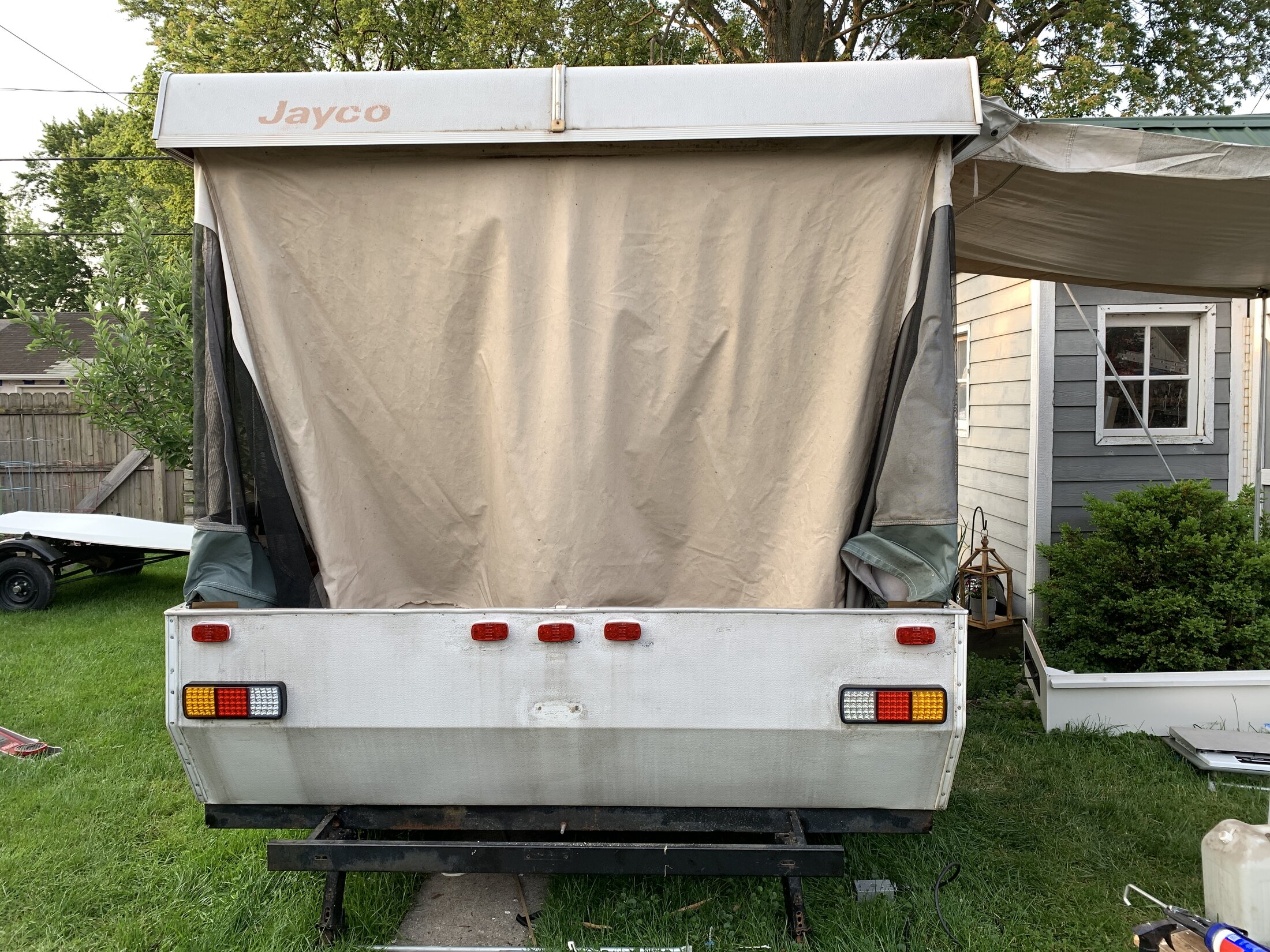

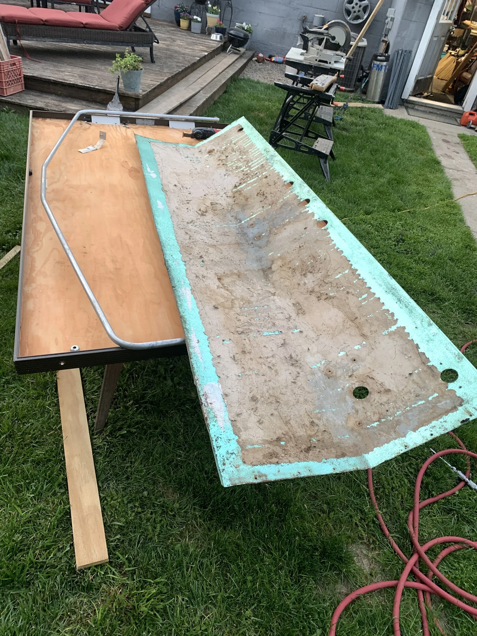

Removed Rear Bed - 5 Bolts
Remove and Replace Aluminum Skin and Framing.
Glued Extra piece of Flooring to Skin with Liquid Nails.
Replaced Framing with 2x4 Cut down to 1" Depth.
Took 1 Night after work till 10:30PM

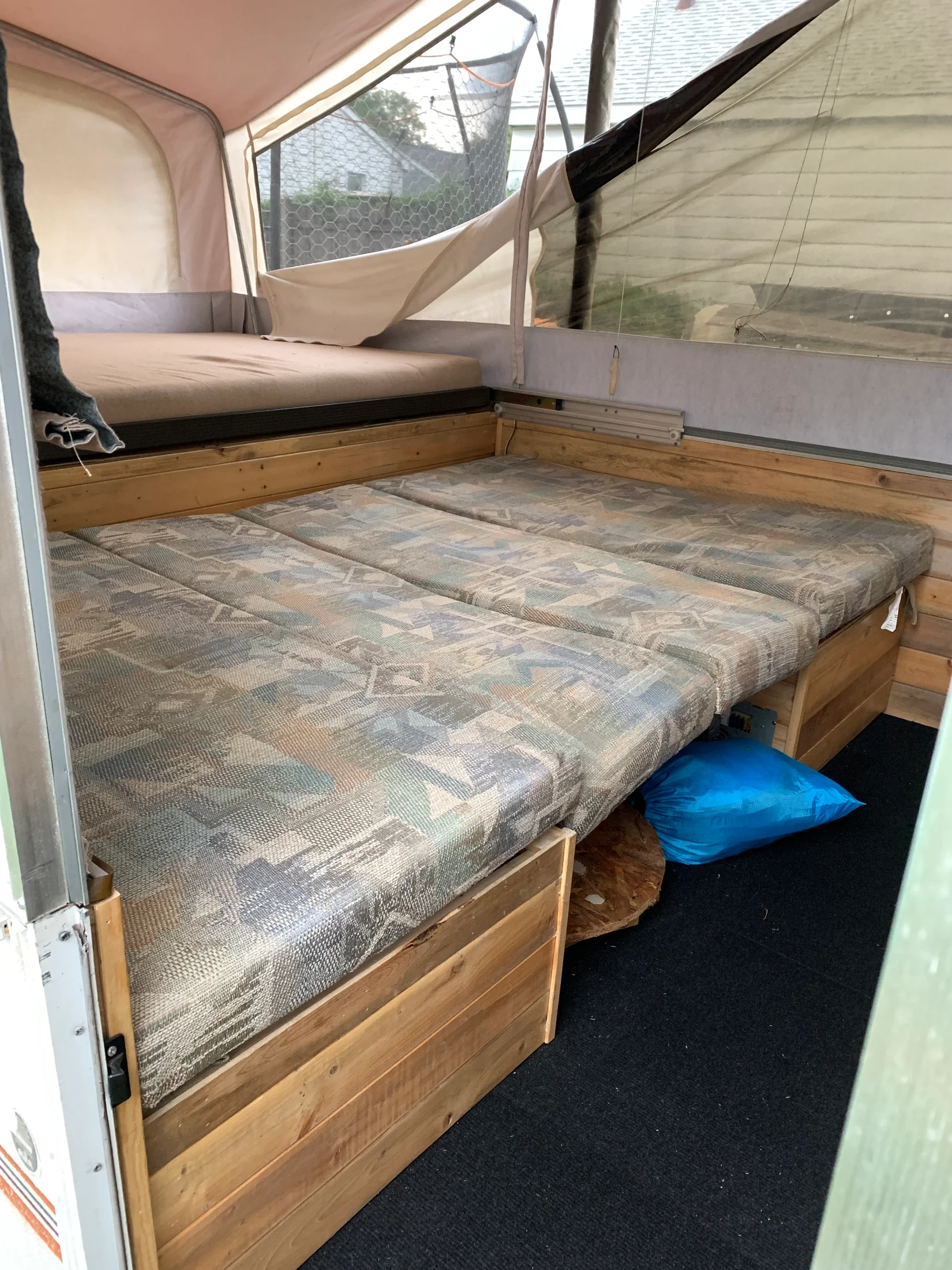

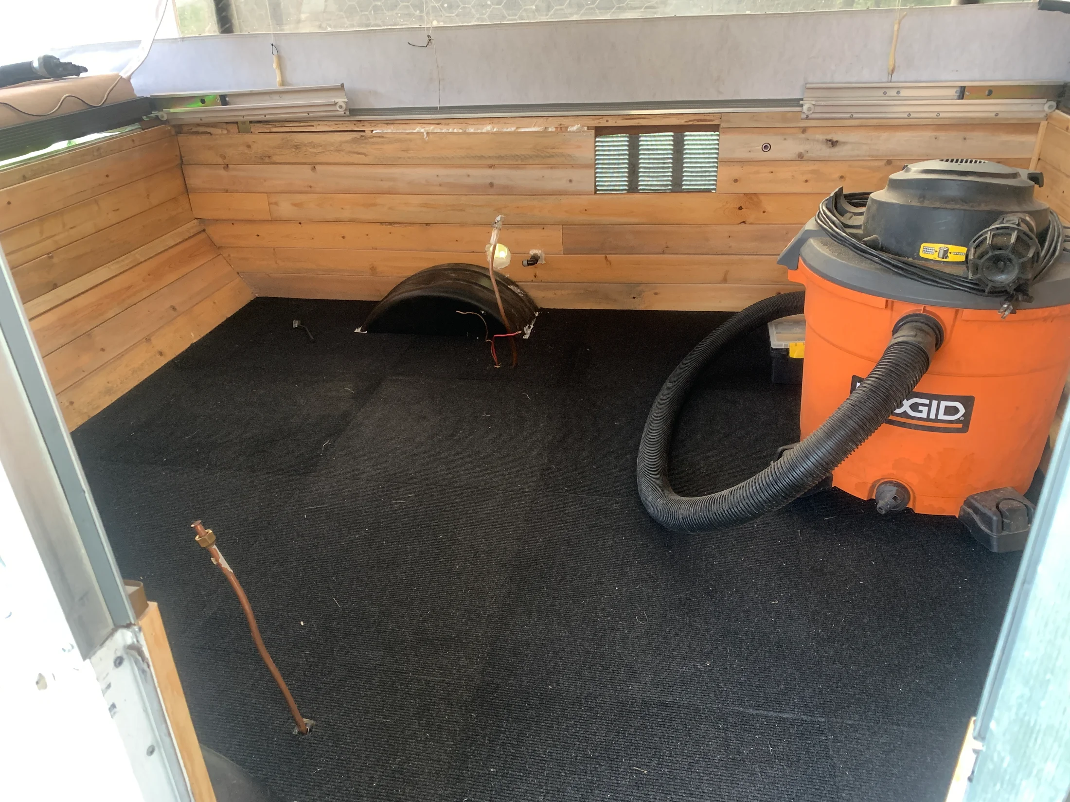

Glued 18x18 Commercial Carpet Tiles to Floor - Took about 4 Hours

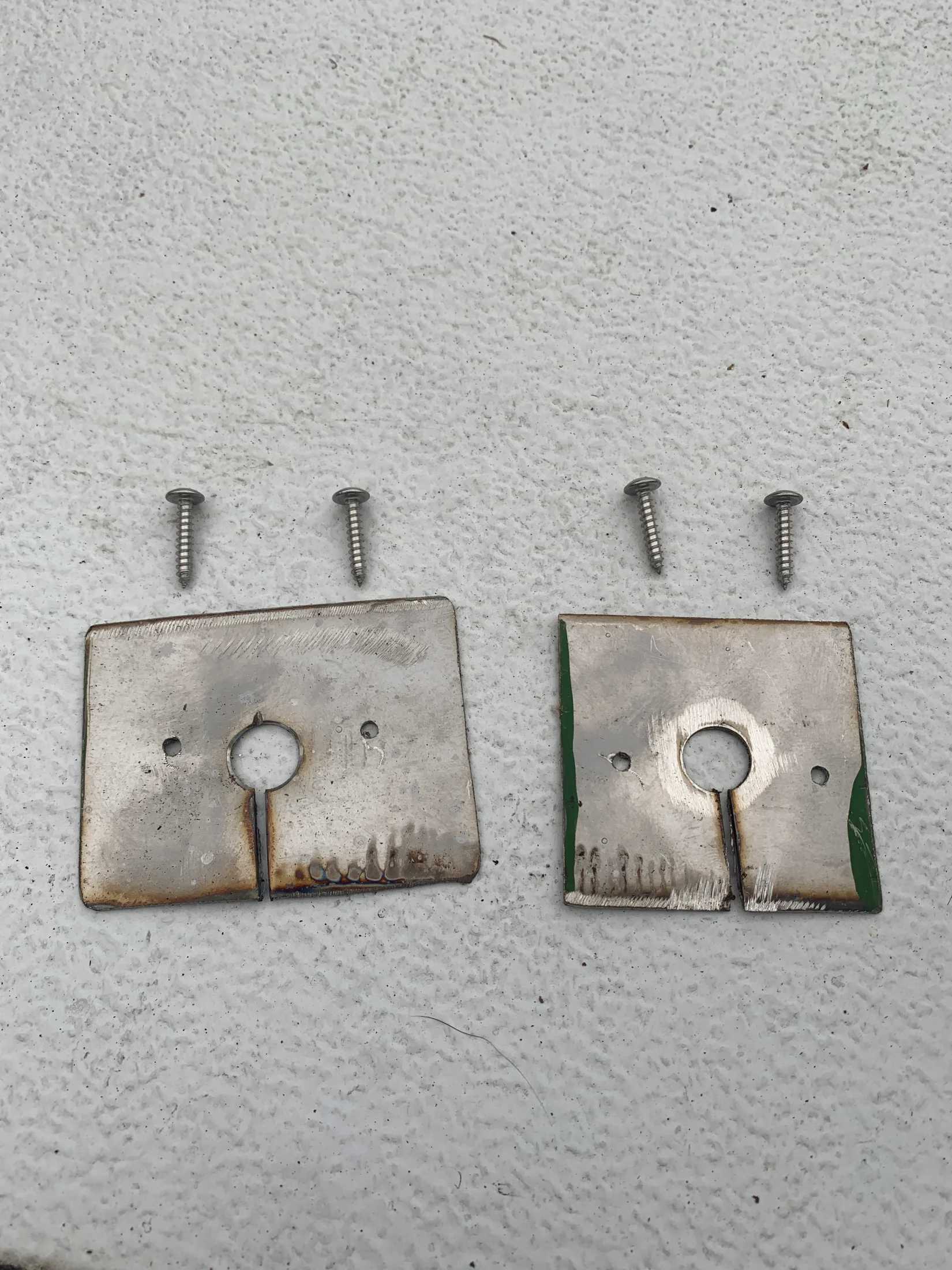

Made Stainless Covers for where Gas Line Goes thru Floor.
Redid Fender Boxes using Originals as Templates.
Added Toolbox, Fire Extinguisher, and First Aid Kit - Rodent Repellent from Amazon.
Boys Discovered the Built in Bathroom

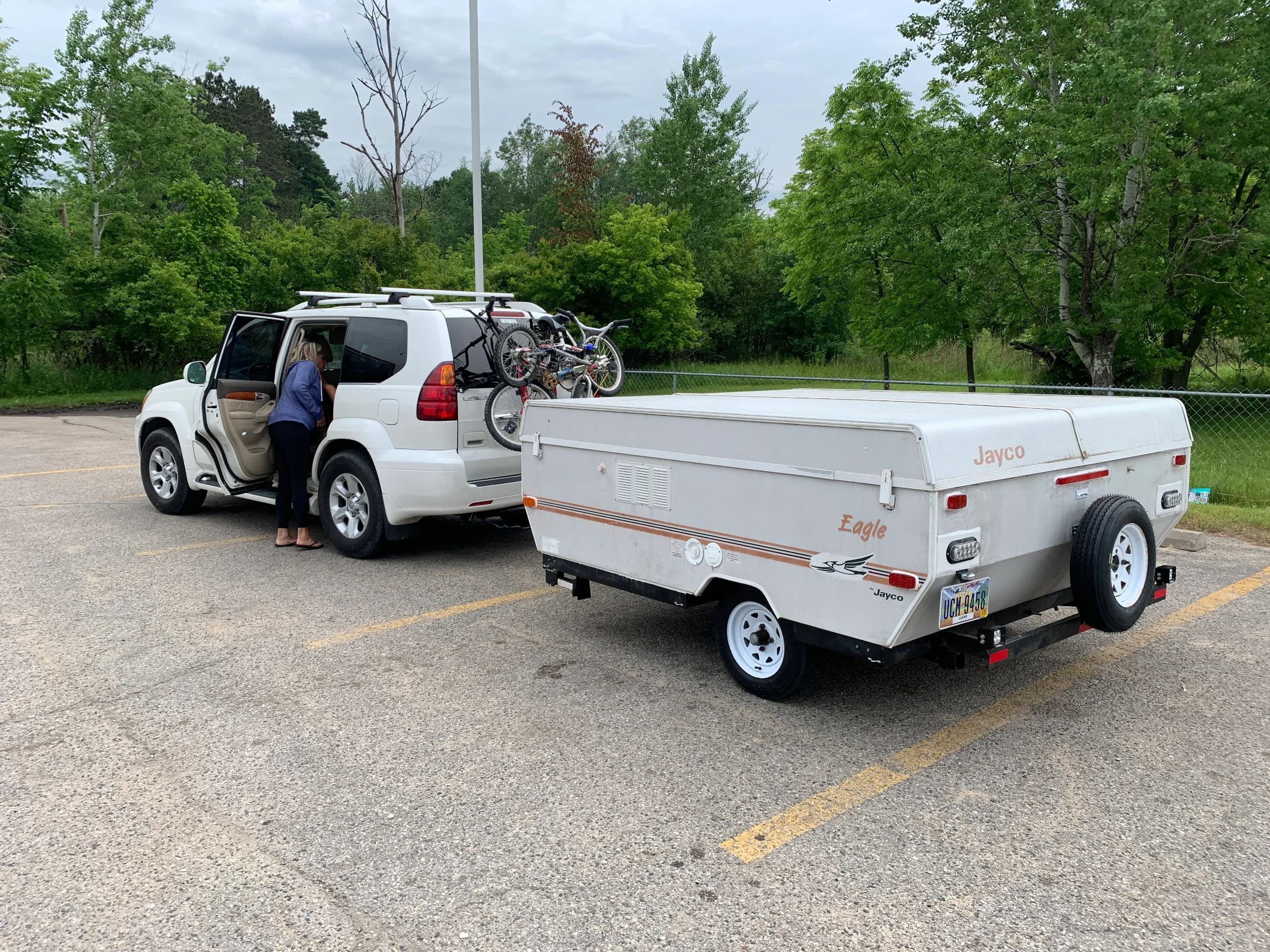

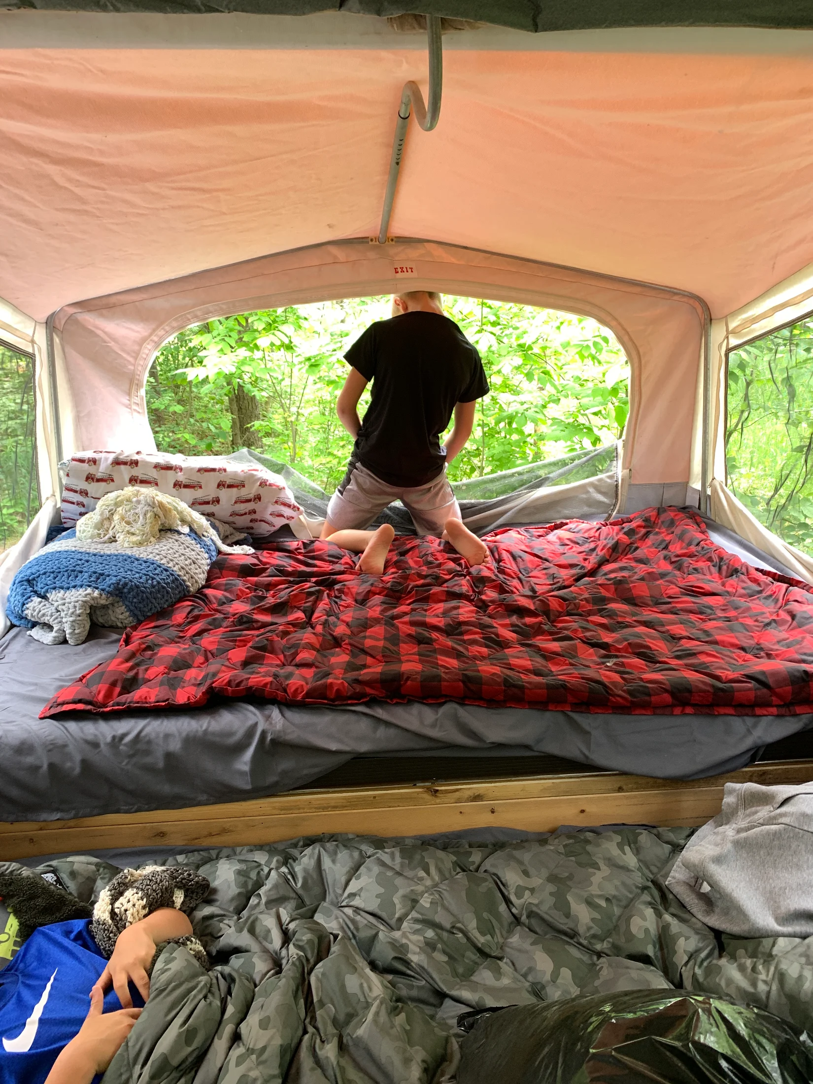

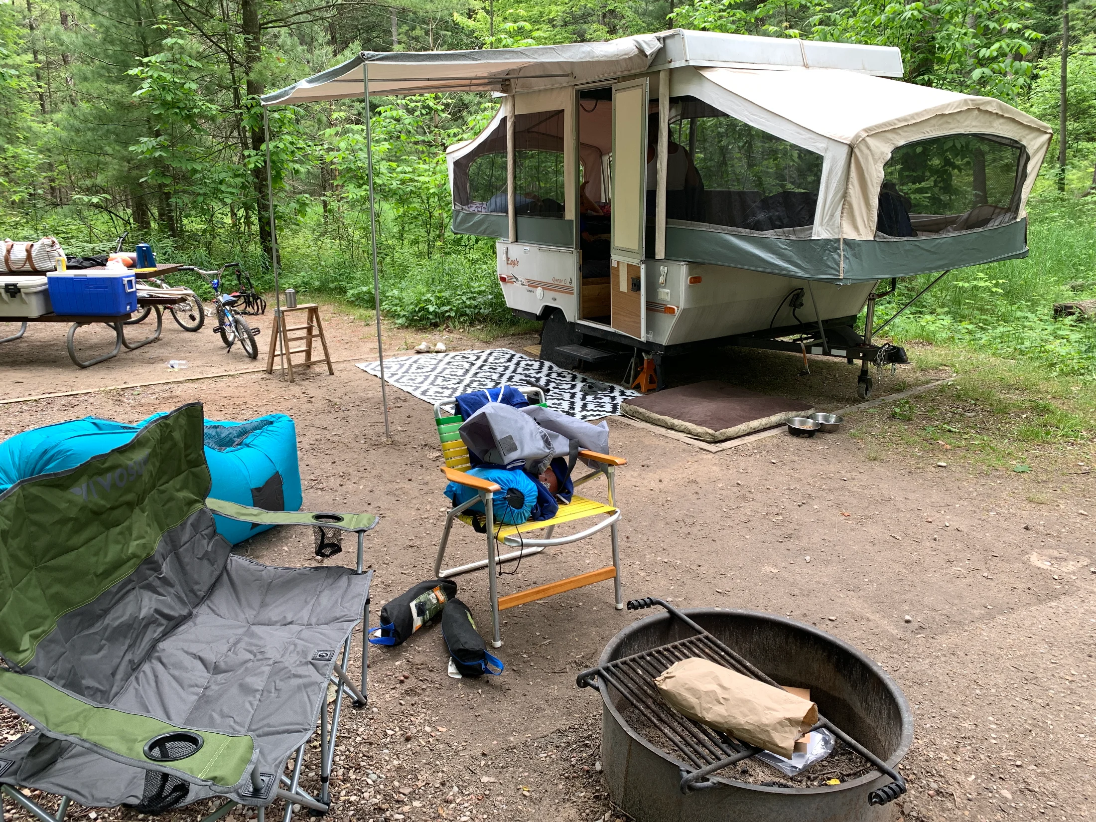

Took it on a Trip to Traverse City
