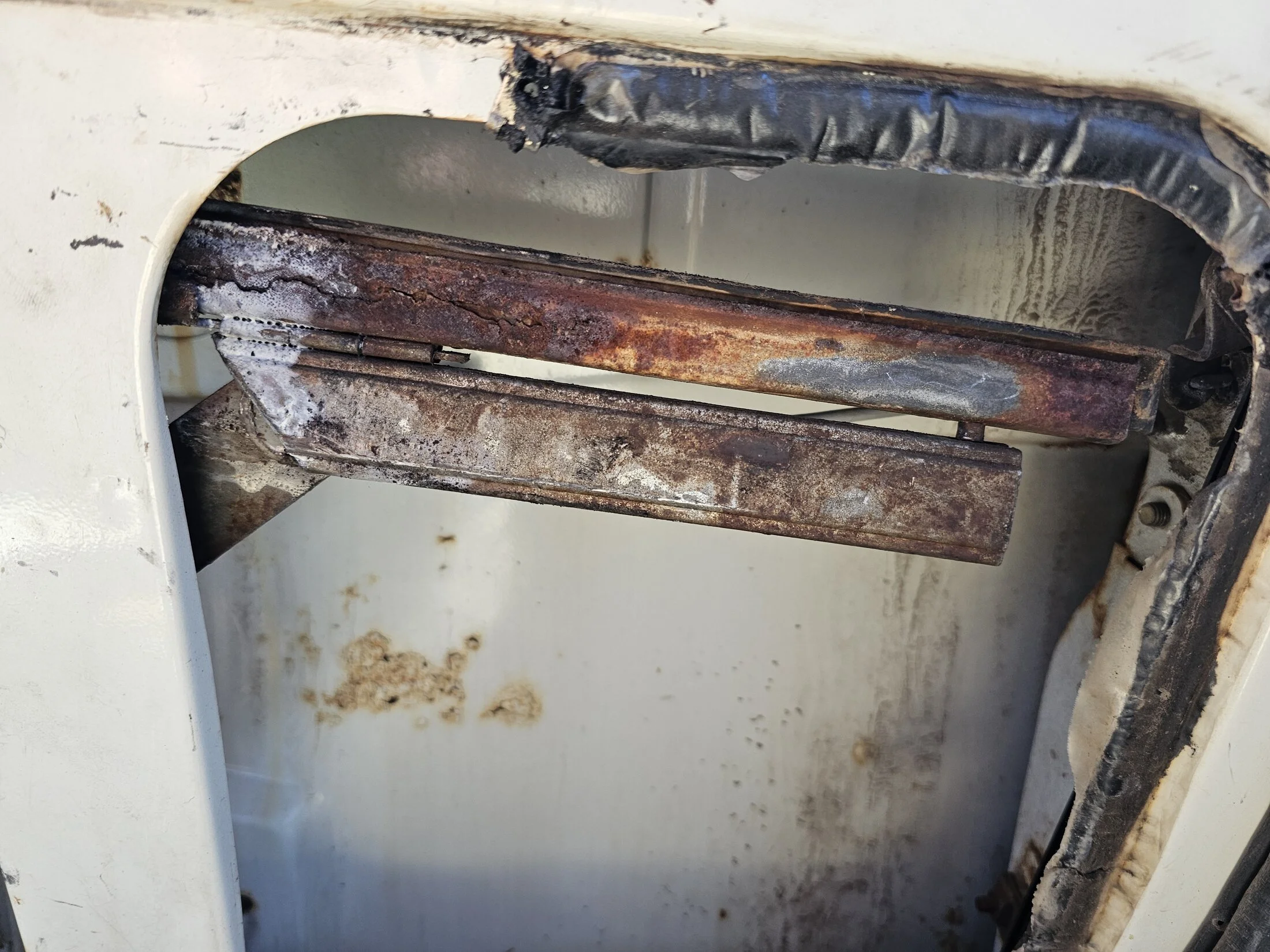

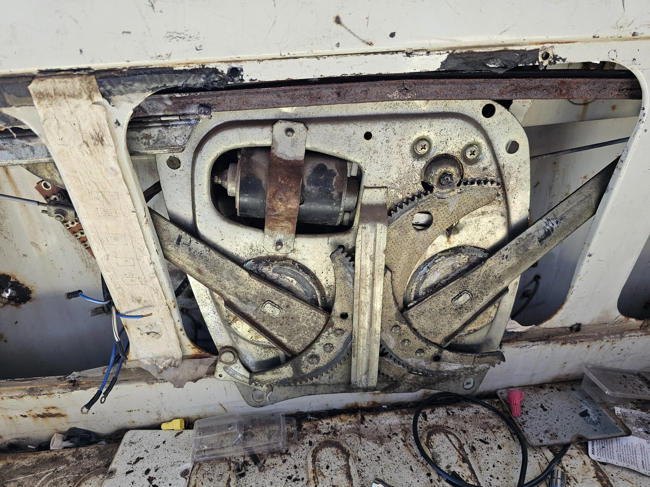

I have the rear window detached from the motor and arms but I don't know how to detach the part that holds the window from the arms.
I have seen people post about latches but I can't seem to find latches.
It looks like it slides out but I can't get the arm to move without the main bar moving.
I have tried moving the pin type things on the inside but to no luck.
Any suggestions would be greatly appreciated.
I'd use a bit of penetrating oil then use a flat screw driver and a small to medium size hammer to tap out the pin on each side. Striking it should break it free and get it out.
They are a pain, I've got to mess with mine soon too.
and if that doesn’t work… get a bigger hammer. 😀
