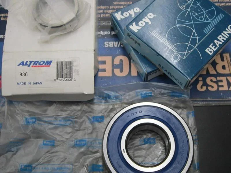

Just to clarify, if anyone orders the ATM bearings from NAPA, this is what they SHOULD be getting.
Front inner: 31.00
Front outer: 17.50
Rear: 48.00
The ATM brand sold in the Phoenix area NAPA stores is the NSK brand. NSK is an OE manufacturer for Toyota just so everyone knows. I looked it up when everyone flipped out about me not using Koyo bearings.
