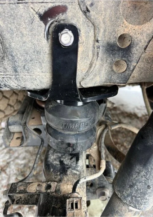

I installed the Timbren kit in the rear. Obviously no lift but it solved my cargo and towing issues. At some point I’ll go with higher capacity springs but for now this was an easy fix that stabilized the rear and kept me level when towing.

The install is simple, couple bolts, standard hand tools.
The ride quality when empty is not as good as stock. The OEM shocks have a hard time controlling rebound as these ramp up in “spring rate” quick when compressed. With some cargo in back it’s acceptable. When towing I’m really happy. I’ve got over 10,000 miles towing with them and I definitely wouldn’t go back to stock.
They come with a couple spacers to adjust when the initial contact is with the axle. First round I put one spacer in but quickly removed it. That gave me a little more suspension travel before contact and less harsh rebound for daily driving.
Would I prefer a firmer spring, yes. I’d rather have a more linear spring rate throughout the suspension travel. That would offer a better ride quality. However I don’t want much if any lift, no more than 1”.
