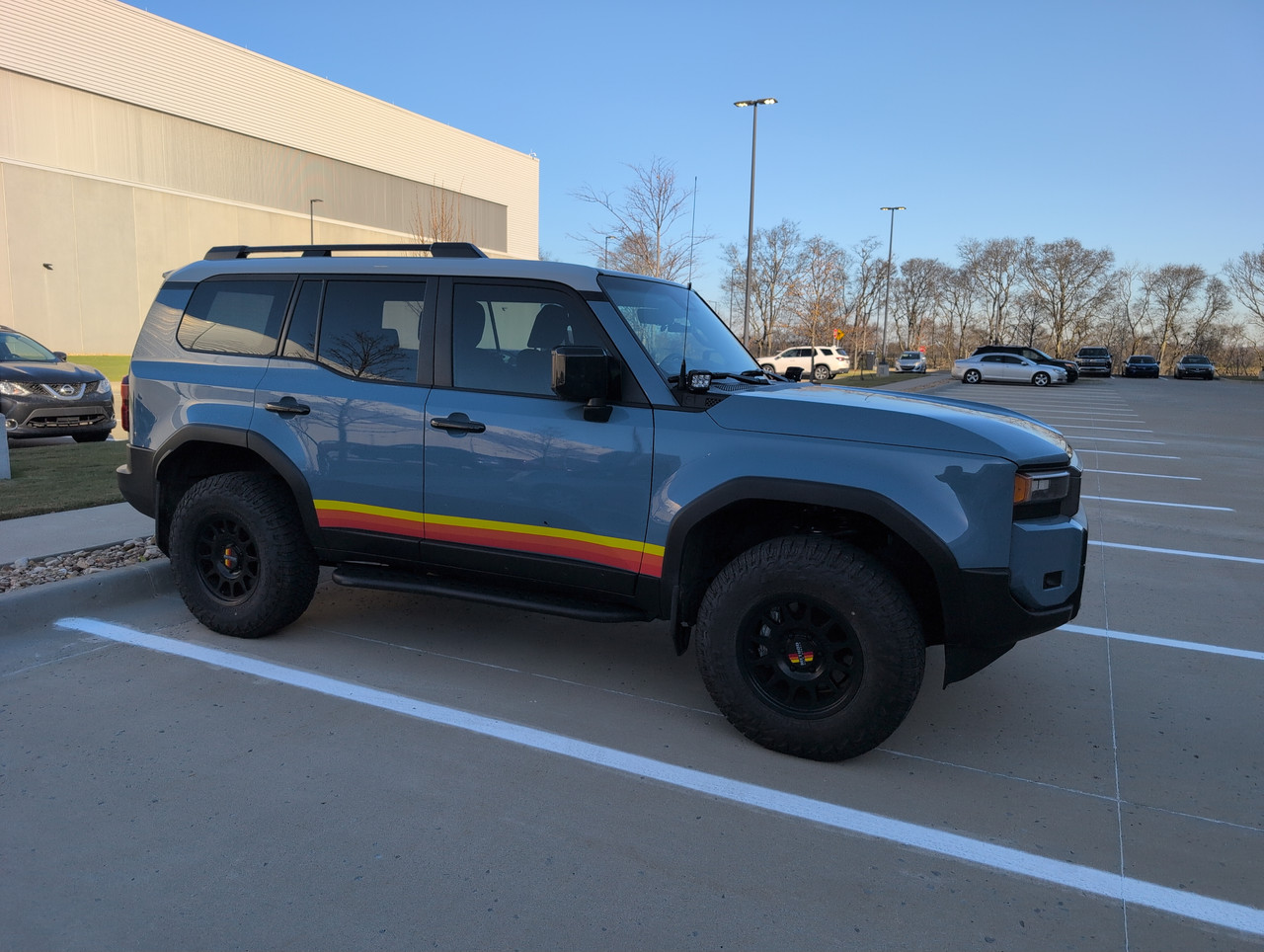

I ended up with almost exactly 2" in the front and about 1.75" rear right after install, I will measure again after some settling. I do have the TrekBoxx rear cargo deck which is 27 pounds of additional weight and Greenlane aluminum rock sliders. I'm also installing a non-winch front bumper and I tow a double axle 12 foot trailer with my side by side. Those things are why I wanted a little stiffer spring with some mild lift.
Not the best photos, but this photo is after about a week of settling. I run LT255/80R17 on method 703 bead grips +35 offset. I have about 3/4" rake front to rear. Once I have the bumper installed, I'll do my final measurements.

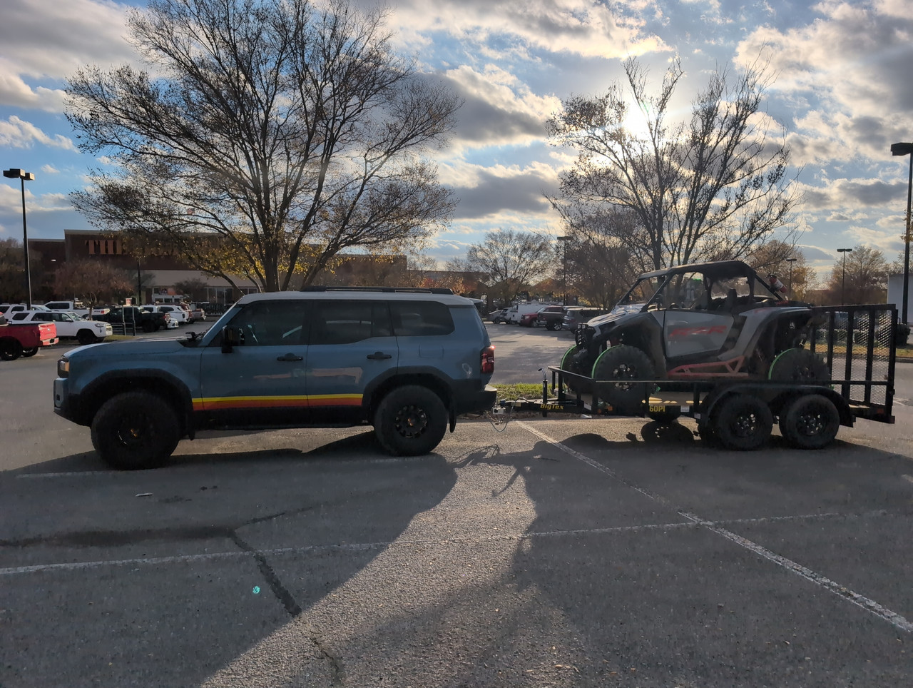

This is towing. I'm very happy with the handling of the towing.
Looks like you end up with a little bit of negative rake when towing. Do you know what the tongue weight is on that trailer with your SXS loaded? I've been leaning towards installing these springs and a set of the timbren SES bump stops to help with towing.
I don't know for sure. I keep meaning to determine that.
