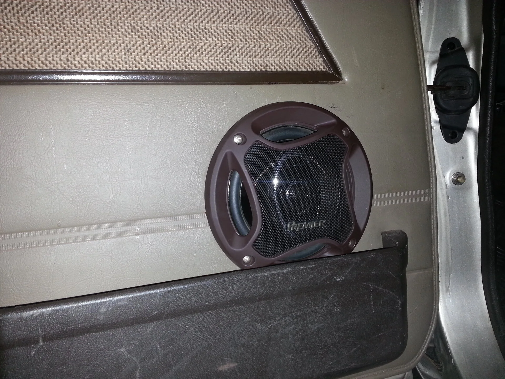

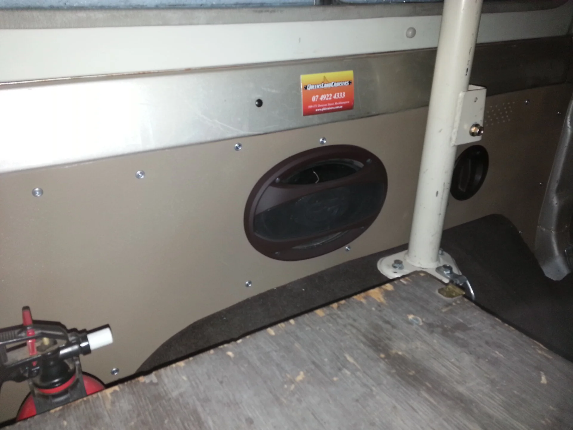

This is the setup for rear speakers.
Hope this helps.
Juan

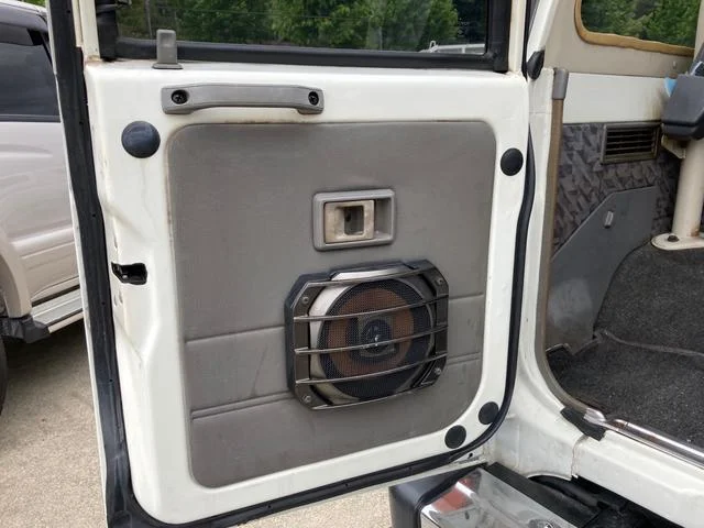

Hello,
A couple things I forgot.
Connectors are behind the rear panels. There is a place for an amplifier on the right side, near the rear wiper relay.
You may have to cut the door cards to fit the speakers as shown in the picture. I have not found the part numbers for the cards with the holes for the speakers, but I am sure they are out there somewhere.
The speakers and the parts for their mounts are available from Toyota.
Juan

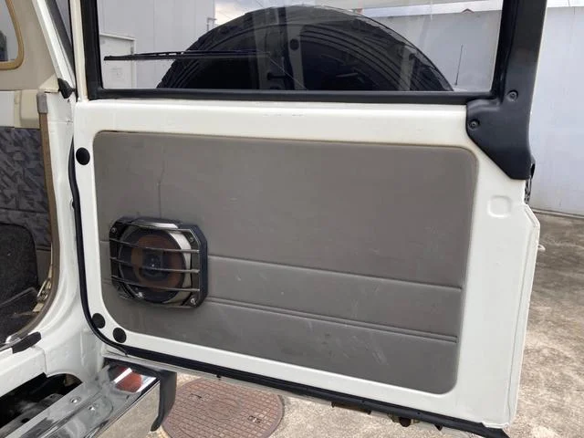

Thanks! And would you happen to know if 6” or 6.5” would be the right fit? I measured the old speaker at 6.25” diameter.
Hello,
The speaker grill is 6 1/2 in. by 6 7/8 in.
A 6 1/4 in. should fit inside.
Juan

Best place in a 73 for optimal sound is 2 in the front door using the Aussie speaker pods combined with some mounted in the side cargo panels in front of the rear wheelwell where there is enough space for sound resonating . Afaik there where no 70 series rear oem speaker options at least not for the European market . Toyota just installed the 2 horrible small ones in the dash and that was it . The dealers then started cutting up door and other panels to mount some , rear doors do not provide good sound .

Hello,
They screw on the card. You may need to cut a hole on it.
There is an OEM bracket and mounting plate. You can get all the parts from Toyota.
Juan
