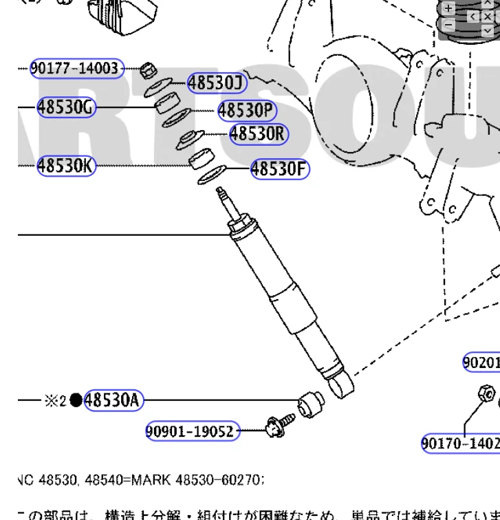

There's no washer on the bottom shock bolt, if that's what you're asking. Just a flanged bolt and the bushing.
partsouq.com is your friend.

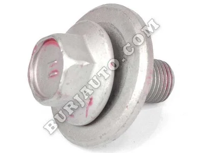

The simplest solution might be to buy two of the original Toyota bolts that come with integral washers and replace whatever is on your vehicle now.
Here is what the ones I took off my 200 look like:

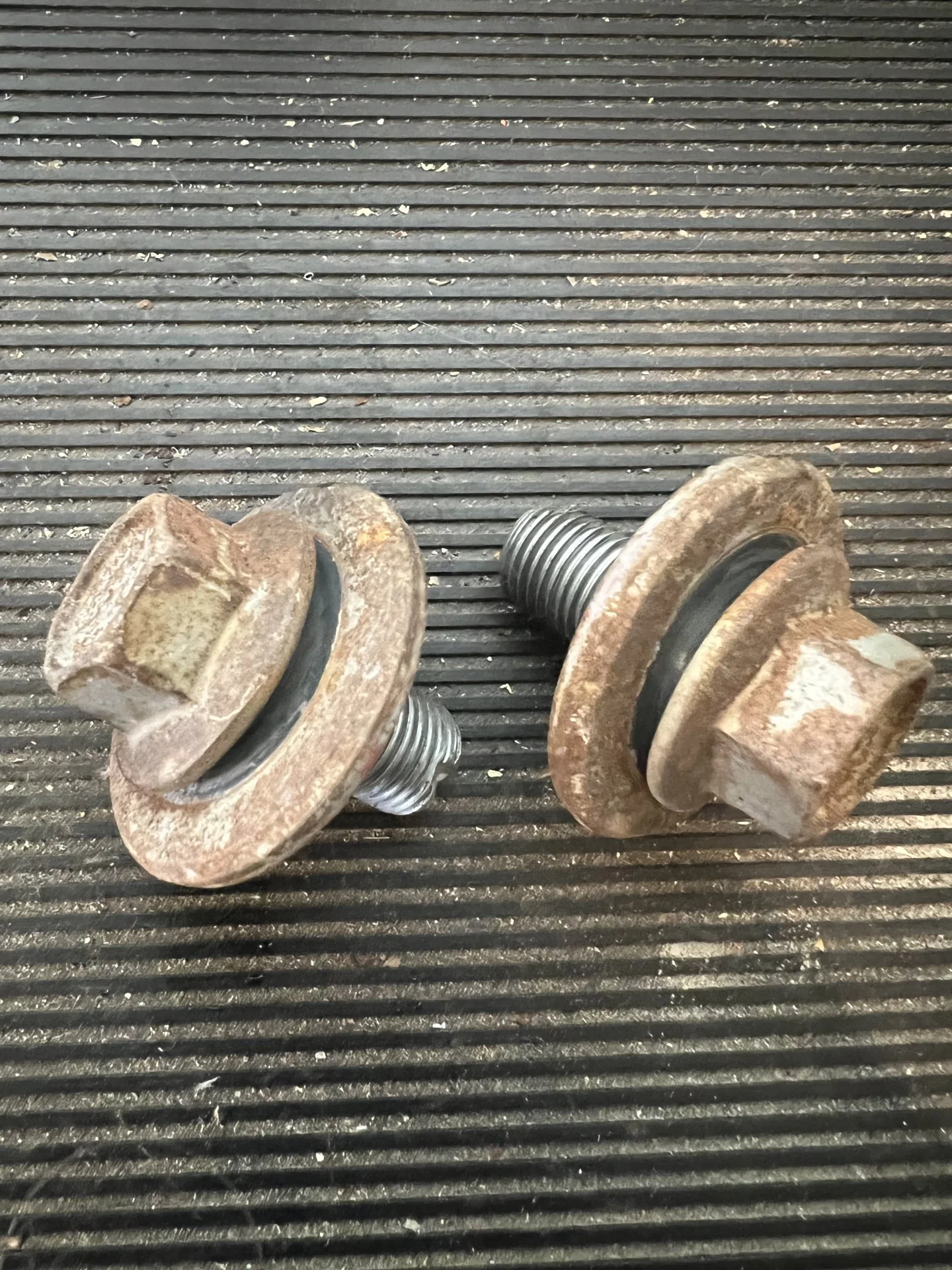

I have BP-51’s I bought my truck with them on it already so someone must have put it on there. I do have the original bolt and washer.
