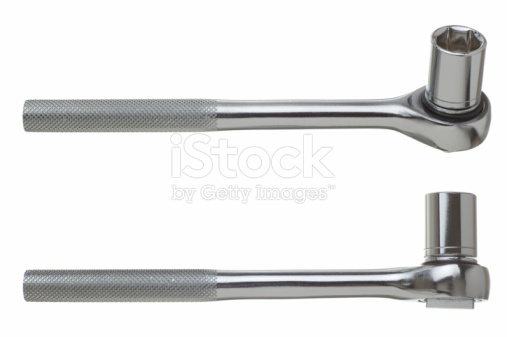

Here are my tools. Takes me a hair under 45 minutes to swap shocks out. It's a horrible location but :meh: . I would never cut a hole unless my truck sat in the ocean for a year and corroded away.
