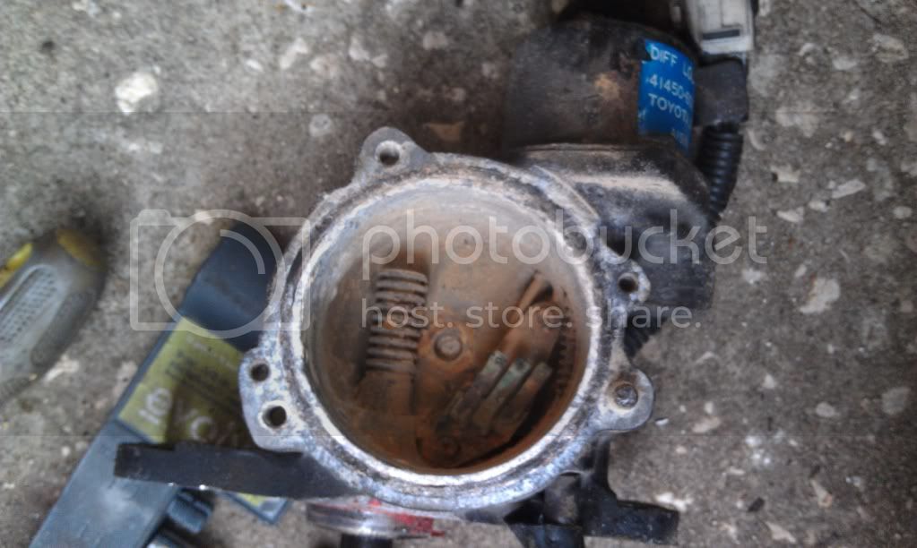

It's a lot easier than it looks to do it yourself. Mine was rusted solid and full of dirt.
Two days soak in deisel. Then i used a bench vise to hold the housing and a skinney screwdriver through the fork bolt hole in the pin to work that out. Scraped the housing clean. Took the motor out and re soldered the lead for one of the brushes. Re-attached the magnets with jb weld white lithium grease for the bearing.then i used a spray called chain break w moly to free up the springs. It works great now. My buddy the heavy equipment mechanic said there was no hope but these things are built really well. It's maybe a 1.5 :banana: job.then if u screw it up then send it out or buy one from cruiser parts. Just my .02

the only reason mine took so long is the fact that it was completly solid from sitting full of dirt for god knows how long. i have no history on the truck other than it lived in new york then miami. im sure the breather sucked up mud and dried into the dirt i found. most that ive seen on here have been no where near as corroded as mine was. has it ever worked that you know of? If its worked before it probobly just needs a little cleaning and grease. but you can pull it out in 15 minutes then open it up to see how bad it is then decide what you want to do.
