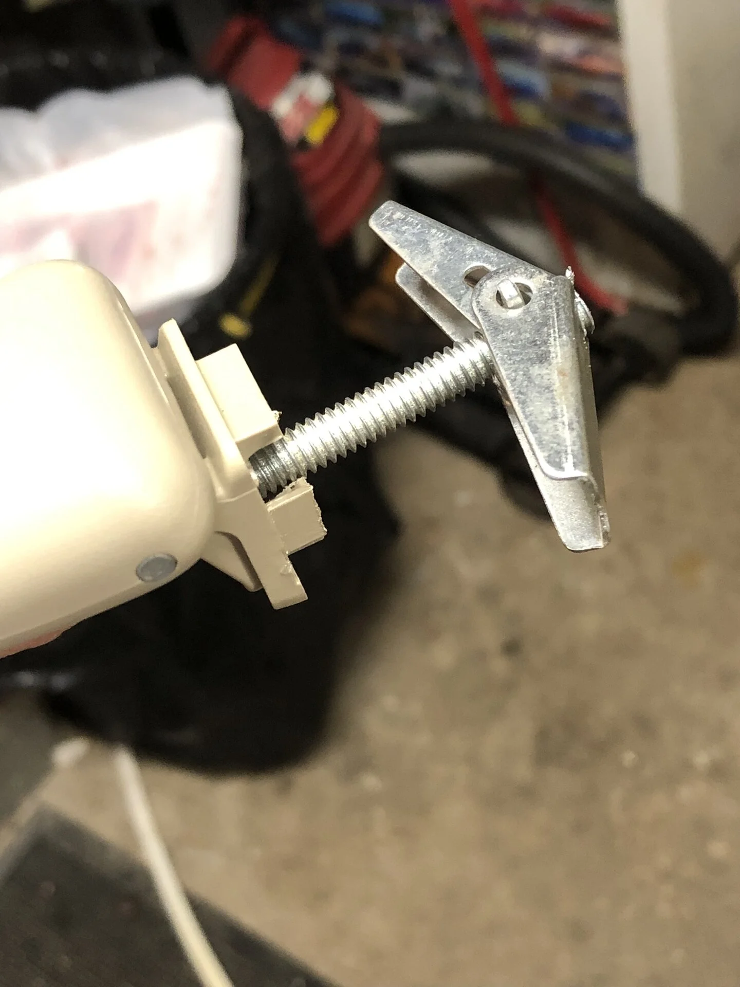

Get 2 - 1/4-20 Drywall Toggles with Bolts (see pic), Vise, Hack Saw, Chainsaw File and Screwdriver that Matches Toggle Bolt, Alex Plus or Similar Silicone.
  • If your Pull Handle Has Not Pulled Off yet it will.
  • This method is Cheap & Maintains the OEM Look.
  • I used a Bench Vise to Hold the Handle Mounts while I sawed - Too hard to Saw and Hold at Same Time.

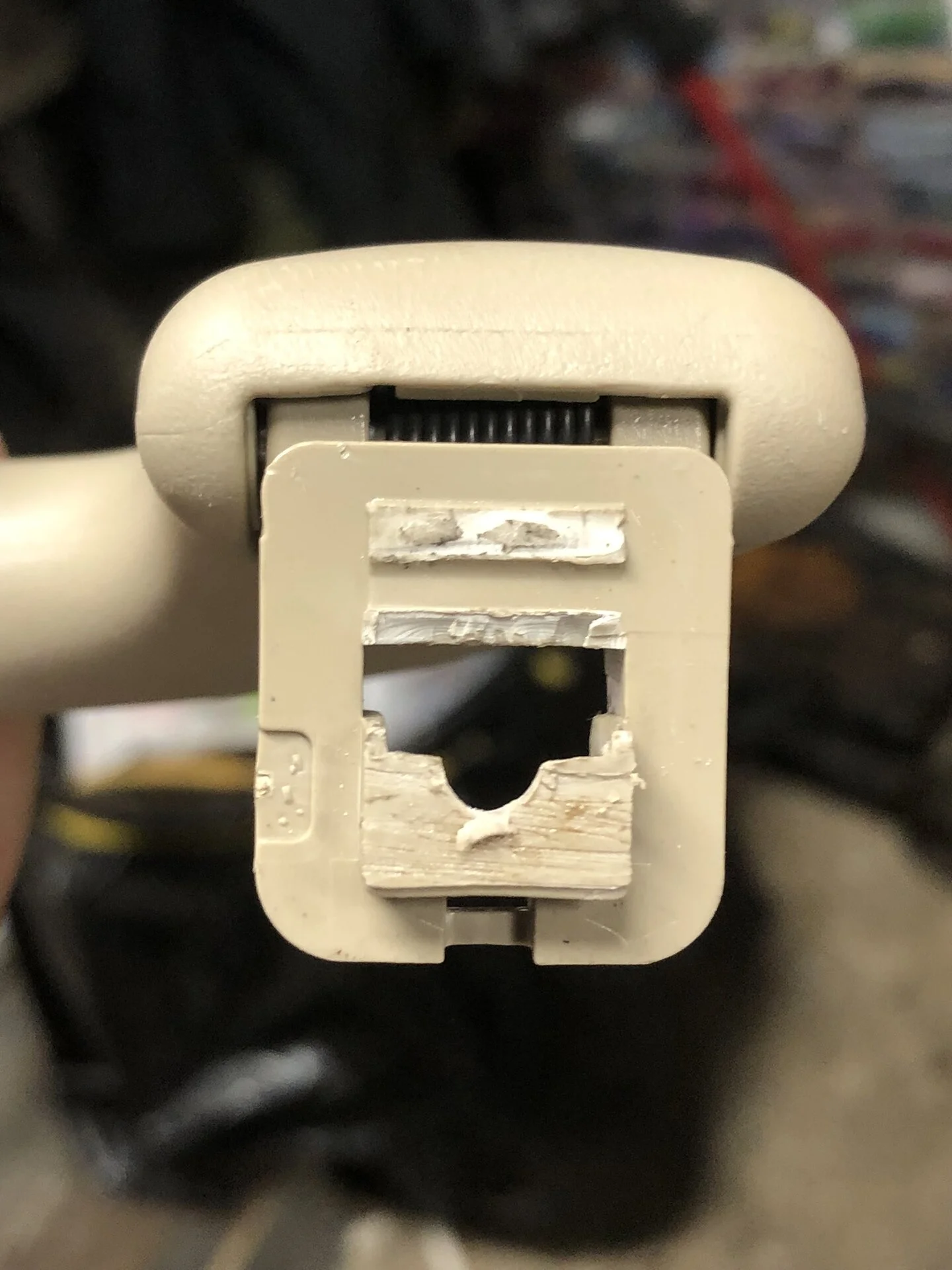

Top Tab - Saw (Hacksaw) or Break off if not Already Broken - Both Sides
Bottom Tab - Saw Half Way Off.
Using 3/8" Chainsaw File Make a Round Groove in Mount (see pic) to Fit Bolt

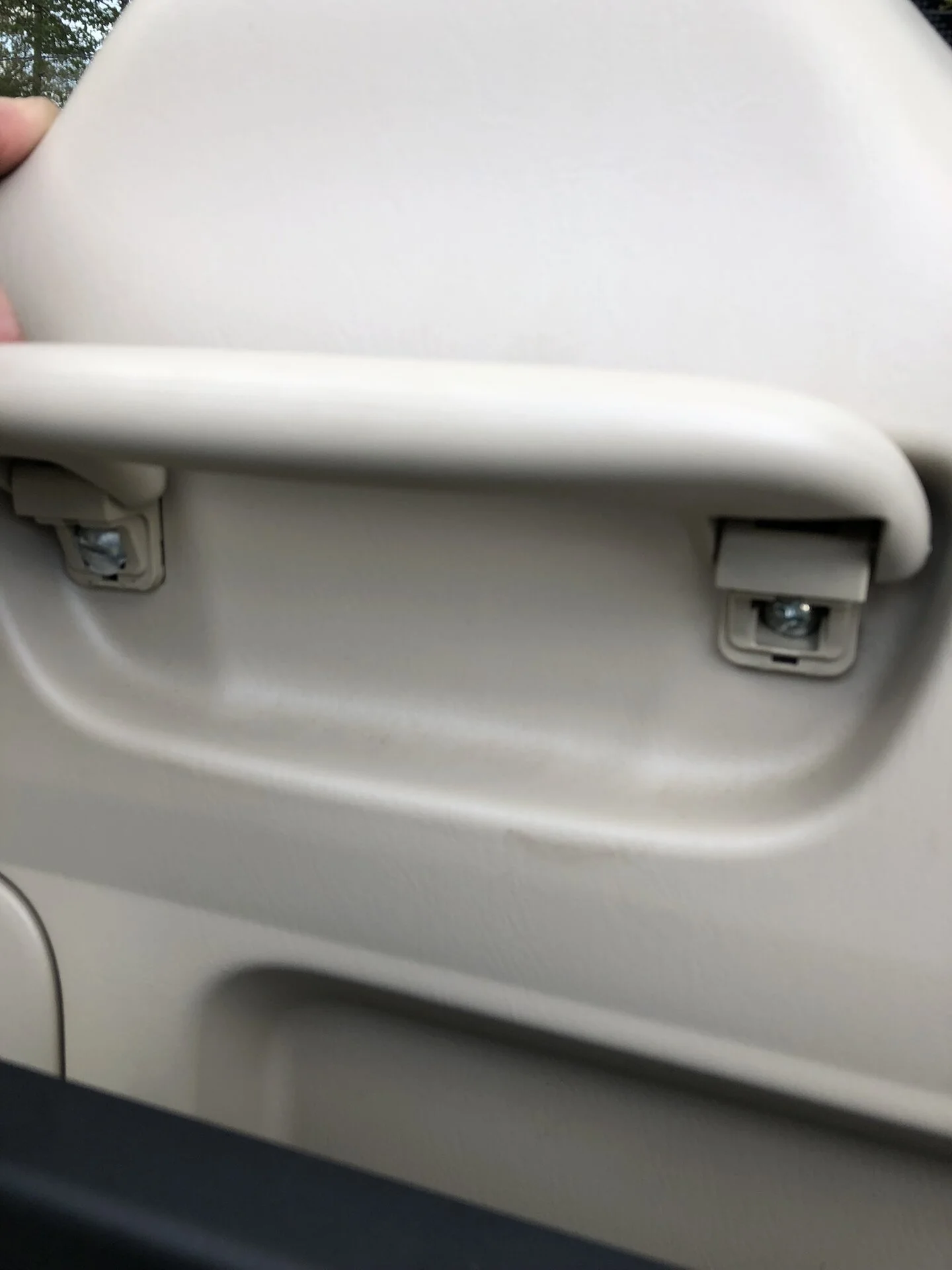

Fit 1/4 Toggle Nut with 2.5" 1/4-20 Bolt.
Push Toggle in Square Hole of Door and Tighten Bolts
Put a Dab of Silicone in Bolt Cover and put on.
10 Minute Task
**Use a Washer in Spring Loaded Hinge to Hold it open while you work.

Thx for the fix. Did it today. Great fix!
