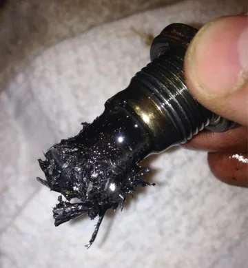

Just changed oil in my rear diff. Approx 8 small metal shavings on the drain plug magnet. Each was size and shape of an infants fingernail clipping. 85k on the truck; it's an 03. Should I be worried?
This is when you worry...and don't ask me how I know:
