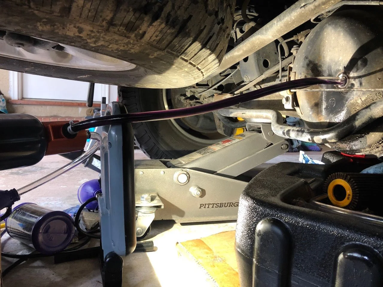

Just changed my TC and rear diff fluids, front will be done tomorrow. I thought I'd share my thoughts on a transfer pump I used that was a MUCH more positive experience than the soap-dispenser one that I bought at O'Reilly's last time I changed diff/trans fluids!
I used a Lisle Model 17282 Fluid Extractor/Transfer Pump and it worked awesomely! 17282 Fluid Extractor / Transfer Pump | Lisle Corporation I tried doing the ol' upside down bottle thing, and then putting a small section of hose on the bottle tip, but both of those were hassles compared to drawing out the fluid in one big draw and then slowly pumping it into the diff/case on the opposite stroke.
If I get pics figured out, I'll post 'em of my setup. Hopefully this spares your workspace a few cuss words next time you decide to tackle this job!

I used that pump today on both diffs and tc, I like it. Kind of spendy but it will last a long time.
