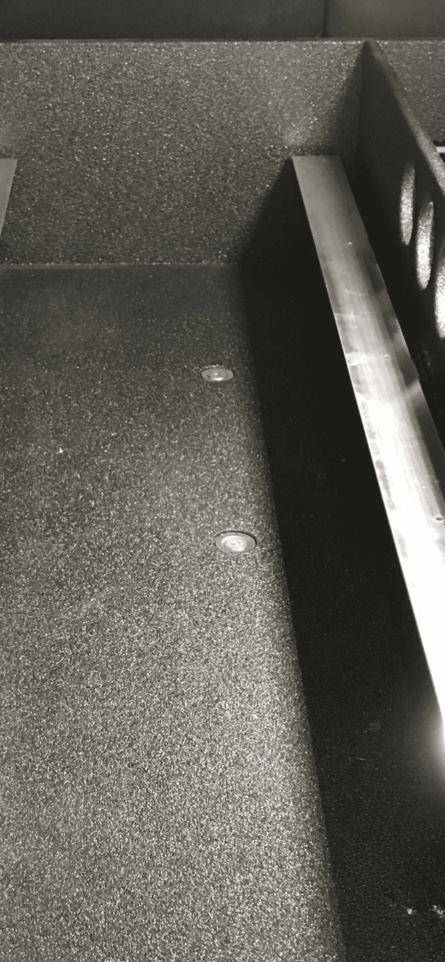

I'm making a rear deck and am looking at what would be the best way to mount it. So Far the only places are the rear tie down points . I think those would work with large fender washers. The third row seat bolts are not an option as they are exactly on the frame of the box.
I'm looking for additional options.

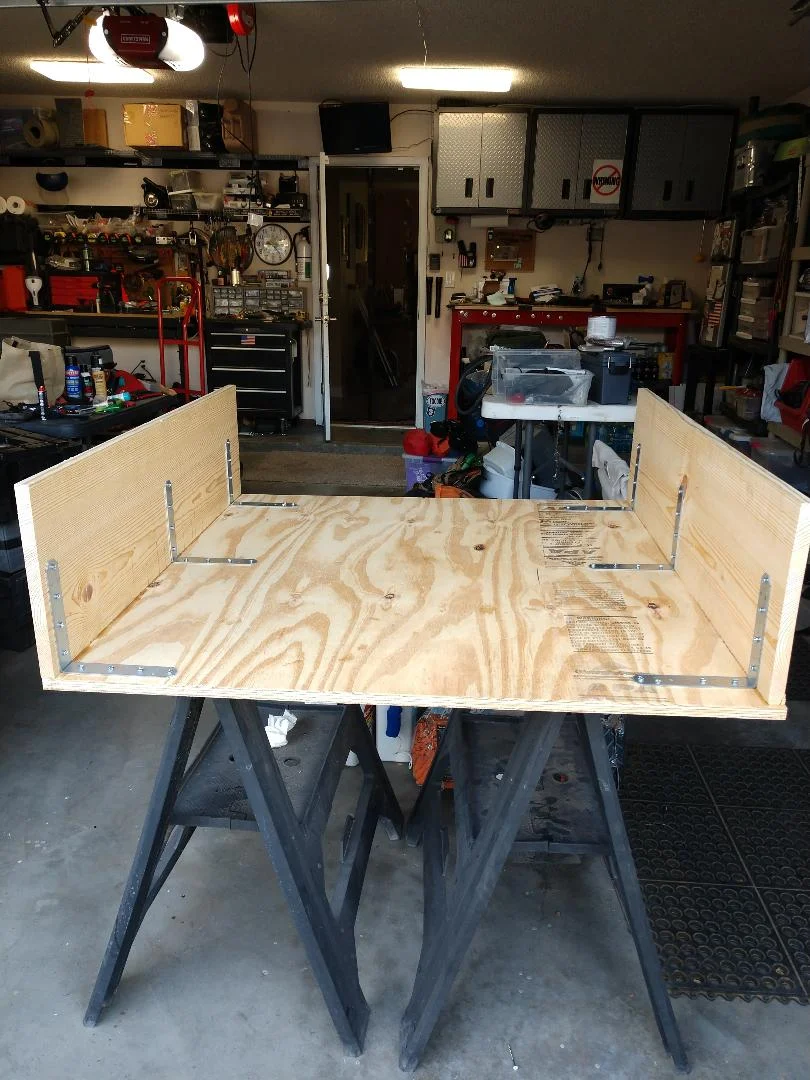

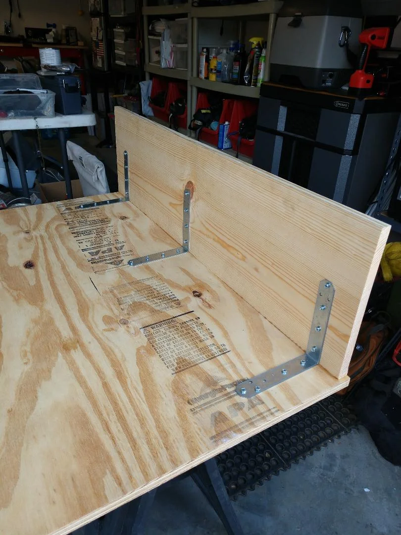

The first picture is the under deck configuration. the second and third pictures are the top piece. 3/4 plywood . The last picture is a 1/2 in piece of plywood. I will have a center 12 X 1 for support. Thanks in advance
