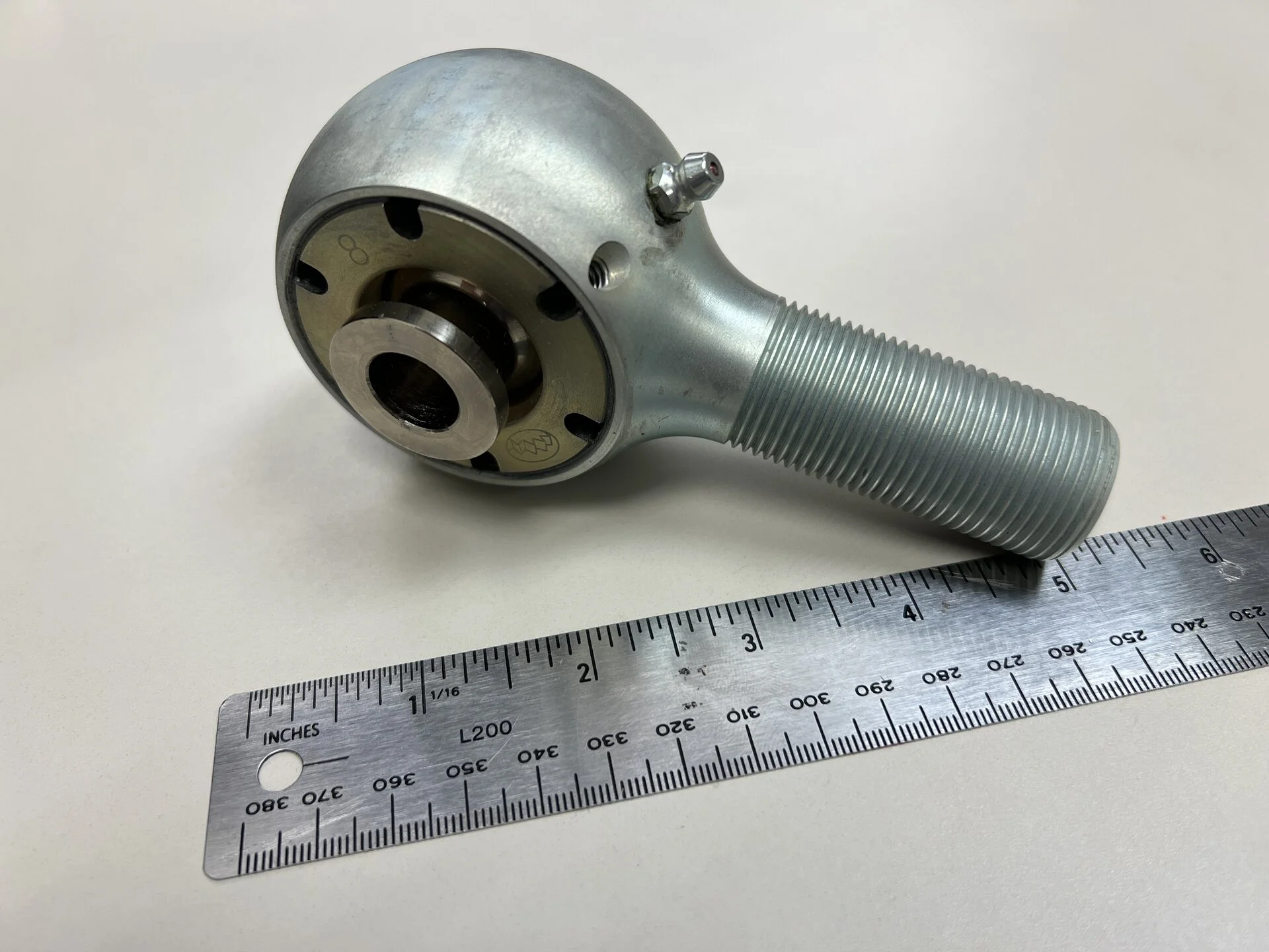

My current links were purchased from Summit Machine in SLC, Utah. The shop owner was great to work with and we communicated via email about 2 dozen times before I placed my order. Julene is very thorough and precise. The main reason I went with Summit is that her joints are built in house, not off the shelf johnny joints or heim joints. Summit's flex joints are no joke. They are greasable, serviceable and rebuildable.

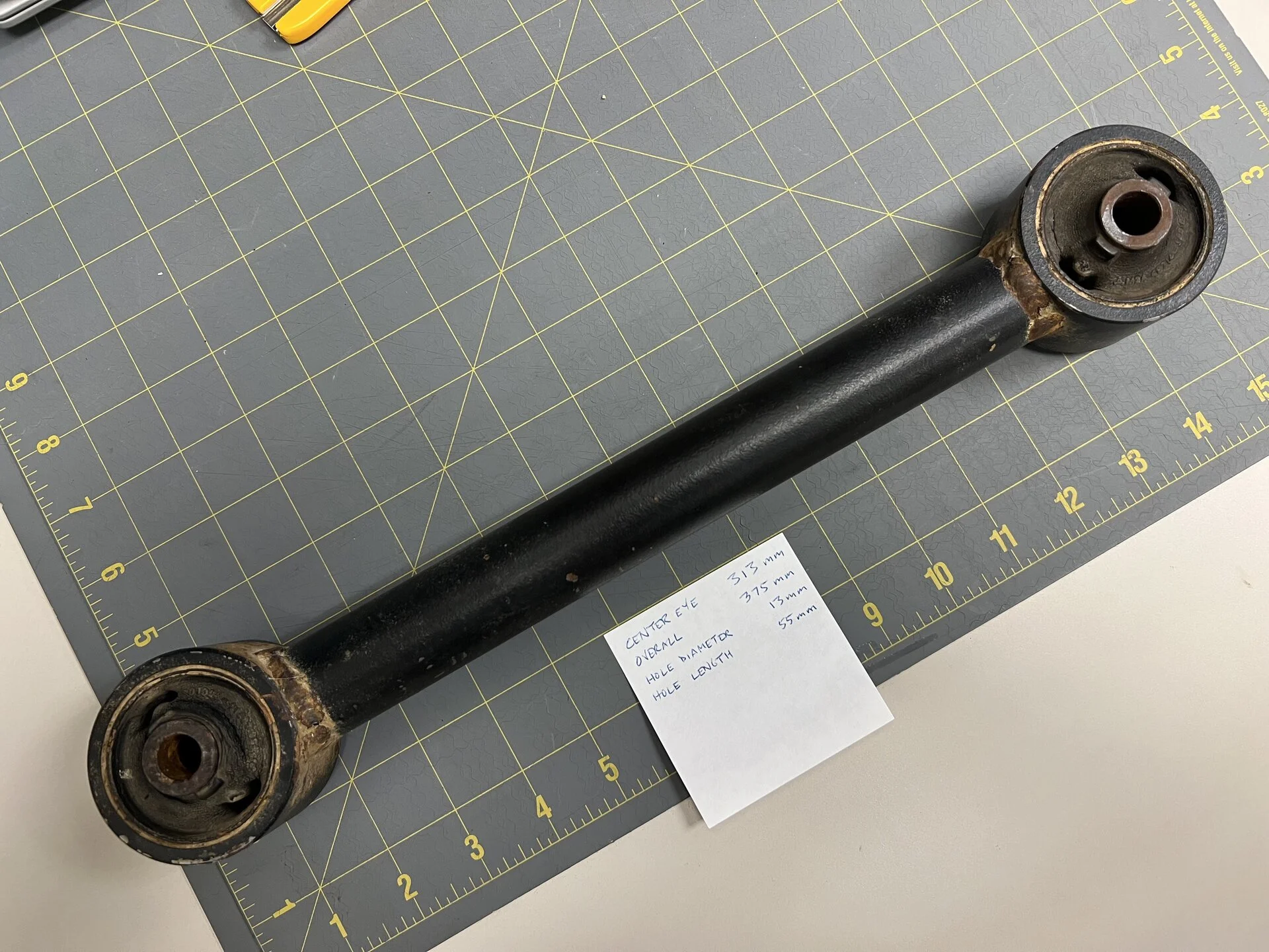

Rear factory uppers

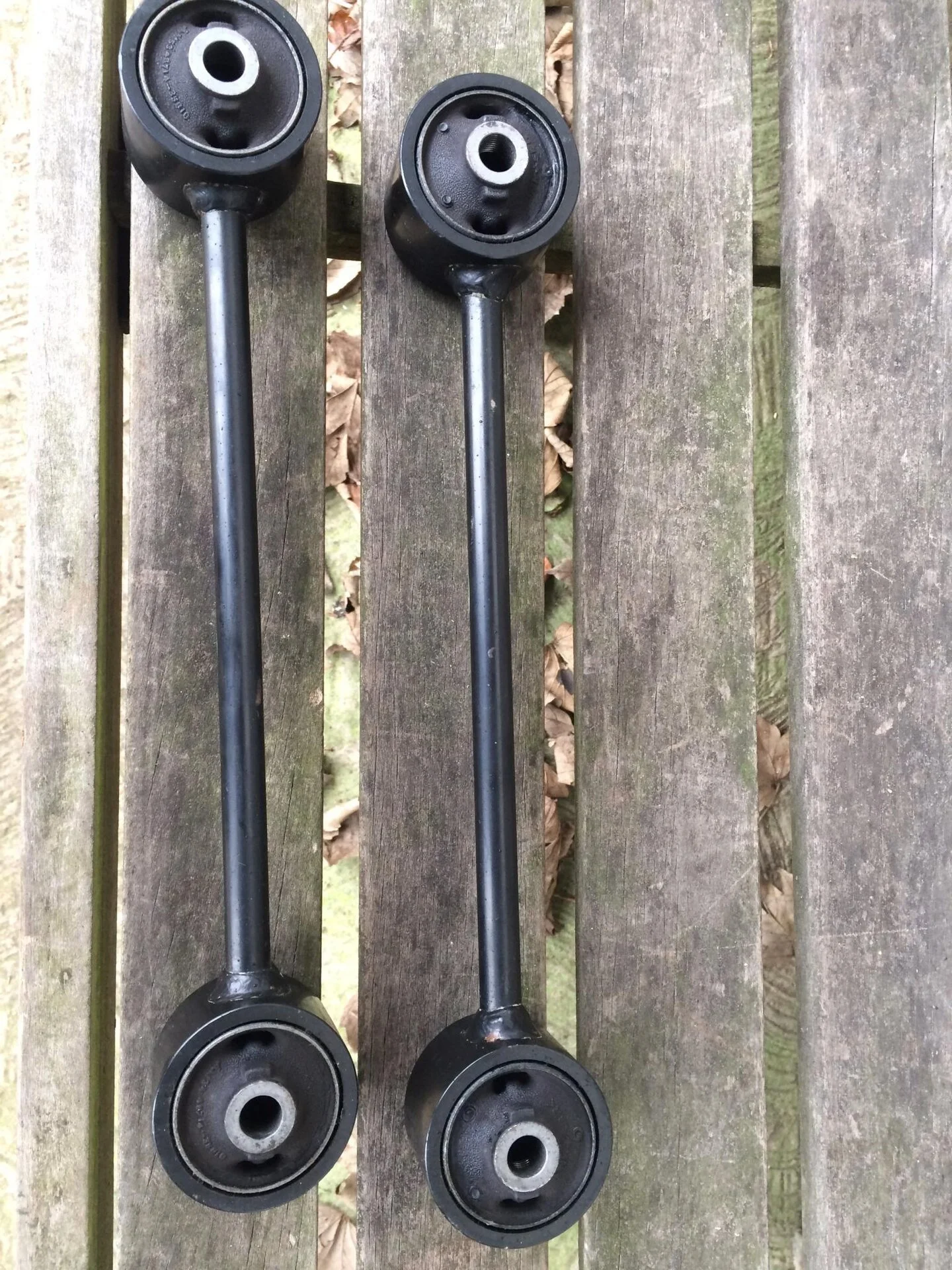

Retubed factory uppers

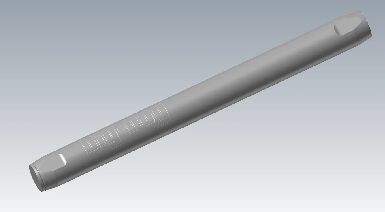

Summit rear uppers

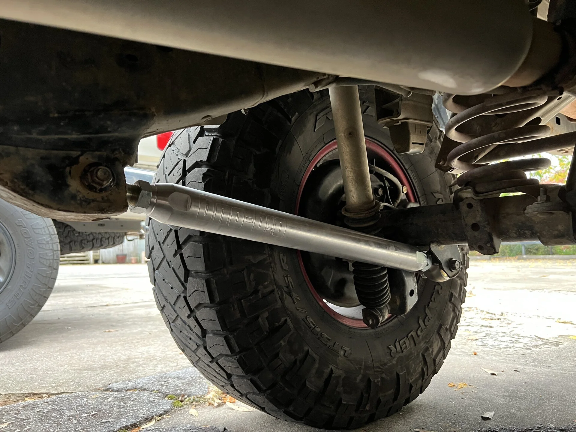

Summit rear lowers
