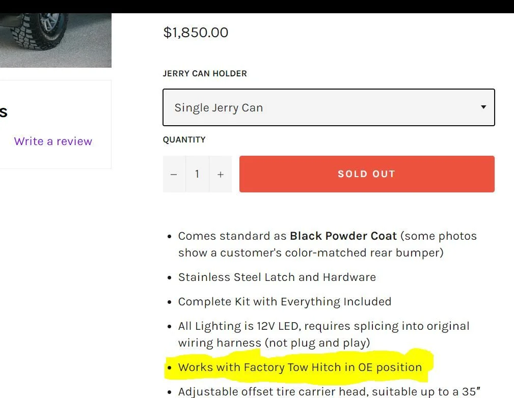

I agree with you that retaining the factory tow hitch is known, proven, and free of risk. However, there are aftermarket bumpers that are well constructed and bolt directly to the frame. I know that I was told by Dissent that their no cut rear bumper retains the factory tow rating - although they only towed a bit with it themselves and there is no industry certification. I was hoping some one here might share their personal opinion of their bumper's beefiness, and perhaps their tow experiences.

Heard & read good things about the BIOR rear bumper. You can get it with an integrated hitch, but I believe both the bolt-on and high clearance versions are also compatible with the factory tow hitch so it doesn't change the tow capacity of the truck. Once again he says it's not intended for towing but that's to release himself from any liability. Mike's a great fabricator and I have his front bumper.

Of course, nearly all armored bumpers are not rated for any towing at all. That doesn't mean they can't tow safely, but it does mean it's hard to say exactly what they can handle and if an incident occurred you could be looking at some serious liability. I spoke with Mike of BIOR (nice guy, BTW) and he was unsure if a regular factory-configured hitch would still install under the BIOR bumper if the integrated hitch option was chosen on the BIOR bumper.
