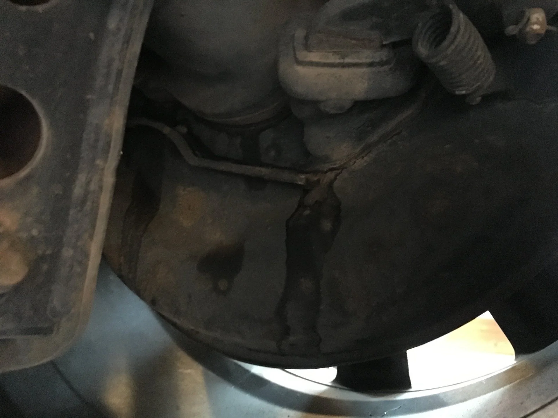

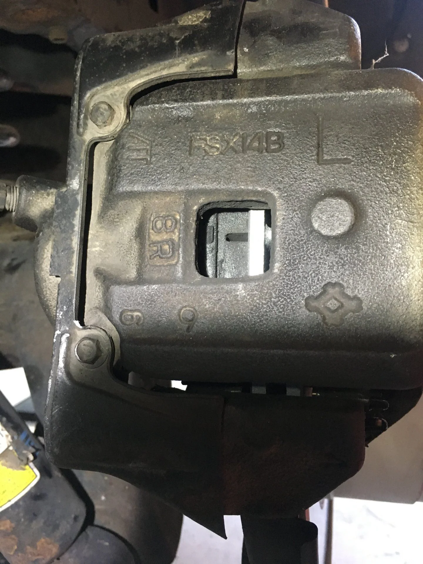

I finished putting new rotors and pads in yesterday and for some reason I have a weird chirp, squeak from the Left rear.... should I be able to see both pads from the little caliper window or is it normal to only be able to see the rotor and inboard pad? The pins were sliding smoothly so I don't know what else the squeak would be? Also, wondering if my axle seals are leaking? Or if that could be brake cleaner runoff? It's on both sides so makes me hope (fingers crossed) its brake cleaner?
The sound should go away with few miles of driving. Did you use OEM pads and rotors? Are wheels binding or spinning smoothly? Also did you install the brake wear indicators correctly?
It's the hardware, those little clips thingys. One of them is to close to the rotor.
Nah I used Bosch. I'll take a look and move the clips around, those things are a PITA. What's funny is it only happens when I turn leff

Your leak looks to be dried brake cleaner runoff. Gear oil is viscous and has a particular aroma.
You'd be able to check for leaks by removing the rotor and looking at the area between the hub flange and the axle. While you're at it, check for the functionality of your parking brakes.
