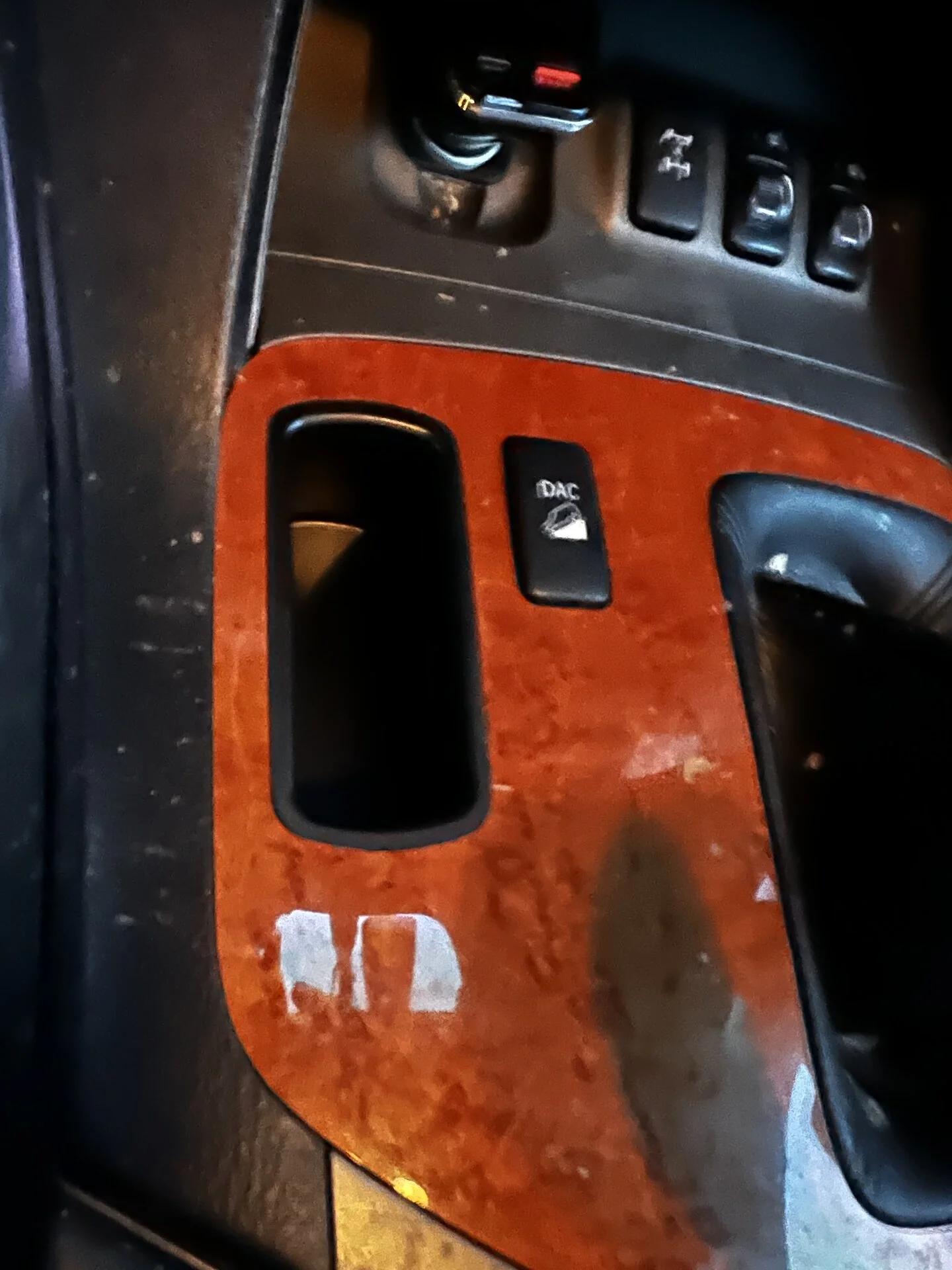

Was the rear air suspension on the GX470’s an option or standard equipment?
I ran across a very much stock 2005 GX470 and there’s no air/suspension control panel. Just one of those small pockets. From talking to the owner, they didn’t have any idea. Of course, they’re not the original owners.
I haven’t taken a look in person. If I do, I’ll have to see if the compressor and air lines are still there.
All GX470’s had airbags. When they work, they work great. When they break they’re far more expensive than a conversion.

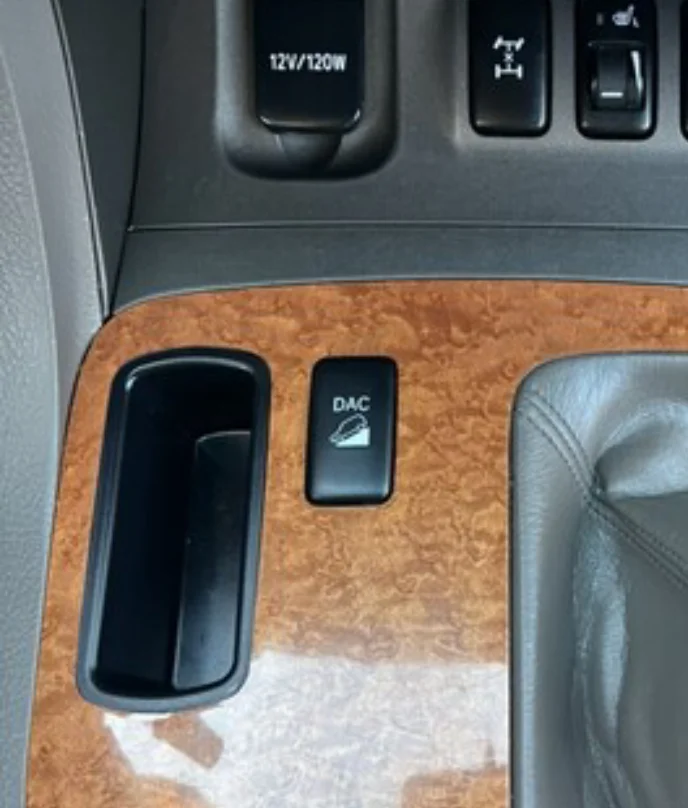

That console part is from a Prado methinks. Toyota part number 58839-60040.
By the way, a few people replace that factory console plate with more practical console plates from Bluedog Designwerks
You can turn that area into dual cup holders, or a cup holder with one switch opening, or auxbeam 6 or 8 switch plate, etc.
Just another option to the prado coin holder
Someone definitely ripped out the factory air springs. All years of 470 had air ride from the factory.
