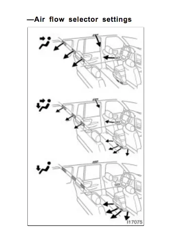

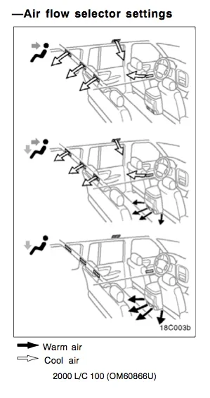

I don't know how you guys are getting warm air form the upper vents unless the system is just recirculating what the floor heater puts out. The rear heater is under the DS and is fed by coolant lines. It has a blower and as you can see from the diagram, the only vents go to the floor in the center console. The rear AC feeds directly into the ceiling vents.

Definitely not recirculated. What would be point of selecting heat and that you want it to come out high, if that's not even possible? Bad pic.
I'll have to double check my '02. IRC, when the overhead selector is set to hot, the hot air comes out from the little vent located under the center console. I think there's a fan motor under the seat with a heater core just for the rear heat.
Correct. You can see the pipes for it on the firewall directly above the engine.
For those feeling hot air coming out of the vents on the roof, my guess is that you are just feeling ambient air flowing through those vents. Similar to if you turn off the AC on the front air and just blow air with the temp set to all the way cool.
