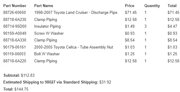

I chose to keep mine alive by replacing the line. Its within reach, just plan to spend a sweaty afternoon in awkward positions under your rig fishing the replacement line thru your frame. The job is pretty straightforward - assuming there is no pressure in the line - you remove the 3 or 4 clamps that progress down the line from the frame. A bolt holds the line in on both ends (front and rear). In addition to the line, you will need new clips, screws, and get new insulator piping because all of that is probably toast at this point. And if its not, good chance you'll snap the clamps when you remove them.
The key to the job is not snapping the new line. Fortunately it has a little flexibility, just enough to allow you to maneuver it through the frame as necessary. When I was getting the new line in place, I kept both hands on the line at all times to make sure I wasn't putting too much stress on it as I maneuvered it around. I think I had to remove my spare to get more room in the back during install. Once in place, you bolt it back up with the new clamps, and recharge the system. In my case I also ended up needing to replace the ac compressor as it was making a growling/gurgling noise, and I figured it wasn't helping the equation. Has blown cold with no issues for the past year. Good sale going on at Serra Toyota of Decatur right now, you can probably beat this pricing (this is for a 2001 btw, so might not be exactly the same for you but its close, figure out specifics on partsouq):
