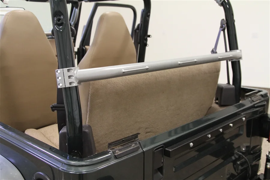

I was hoping someone could help me figure out if there is a logical way to affix 4/5 point safety harnesses for a factory rear seat in my FJ62.
My model was manufactured in 9/‘87 (1988 model) so I don’t have any shoulder belts. I’d like to add some better harnesses for my kids, but I know I’ll likely have to build a bar behind the bench back to affix the harnesses like some 40 series and Jeep Wranglers run.
Athoughts on where to secure some sort of cross bar too?

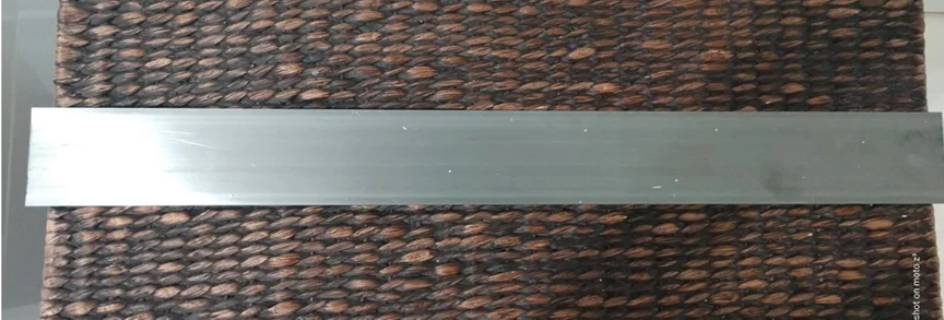

I bought a 1/8" by 3" by 28.5" Cold Finished steel plate from Speedy Metals (Speedy Metals Online Industrial Metal Supply - https://www.speedymetals.com/).

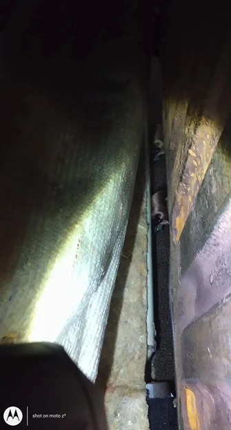

I don't have an intact cargo area carpet, so I figured I could use the space between the rear seat and cargo platform where the rear seatbelts mount to mount the 1/8" plate beneath the rear seatbelt bolts (I sourced longer, 1 1/4" bolts from SeatBelt Planet for this purpose) once I drill four 7/16" holes through the plate. I will also drill 3 7/16" holes opposite those four mounting holes to attach the tether anchors to (will buy these from Toyota as aftermarket/retrofit items).
The plan is to use the factory lapbelts and the tethers that will loop over the rear seat back and down to the plate/anchors to prevent forward tilting of the car seats. This type of plate may also work for attaching harness straps.

Bring it on over, we will bend some pipe and make a halo with a cross bar behind the seats for the 4 or 5 point whichever you want

At some point in the future, I am thinking of welding the V or Y shape belts shown here to the plate that I attached above. Right now I am using the plate under the retracting belts to fasten car seats to. But in the future, I will add some better belts than just the lap belts.
