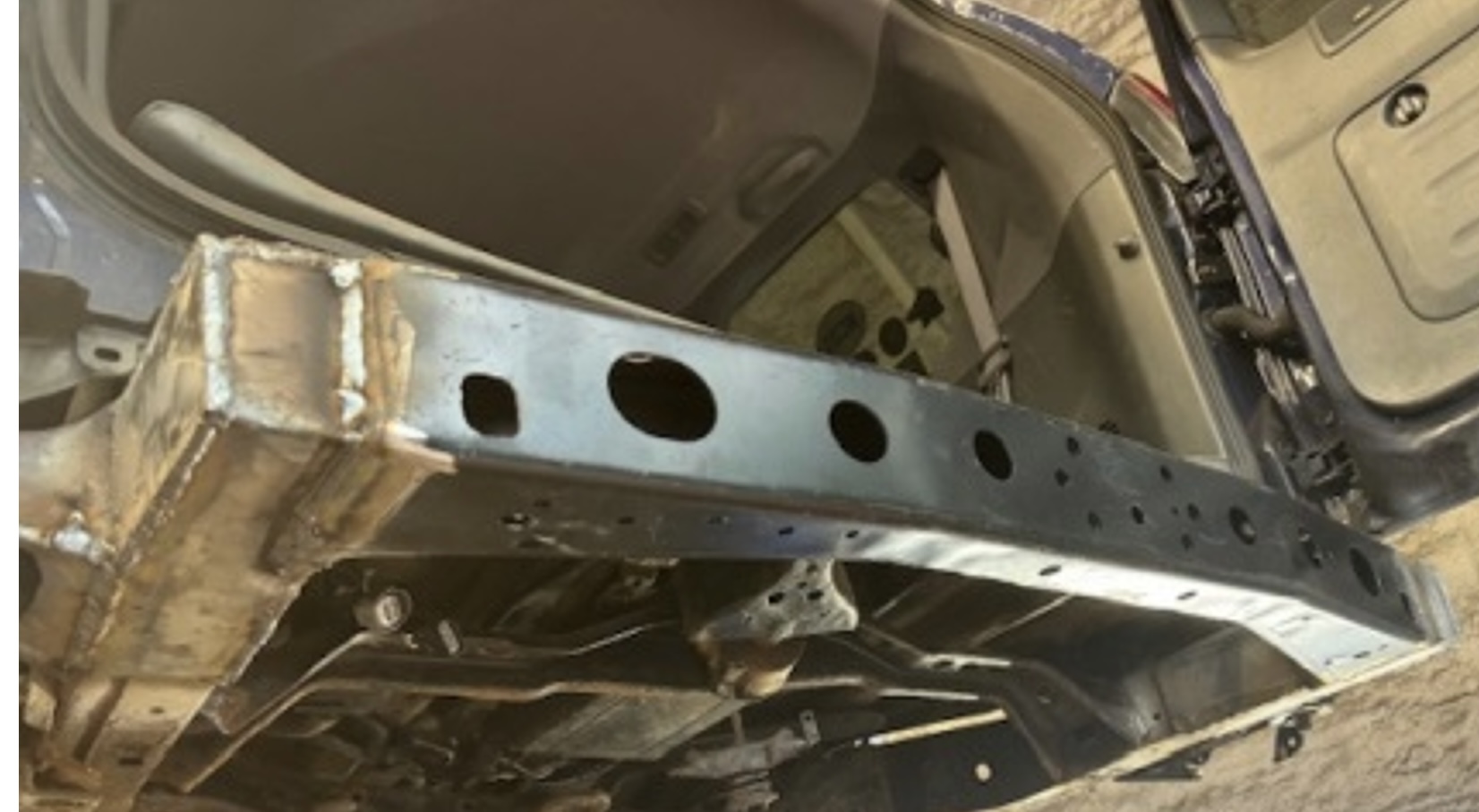

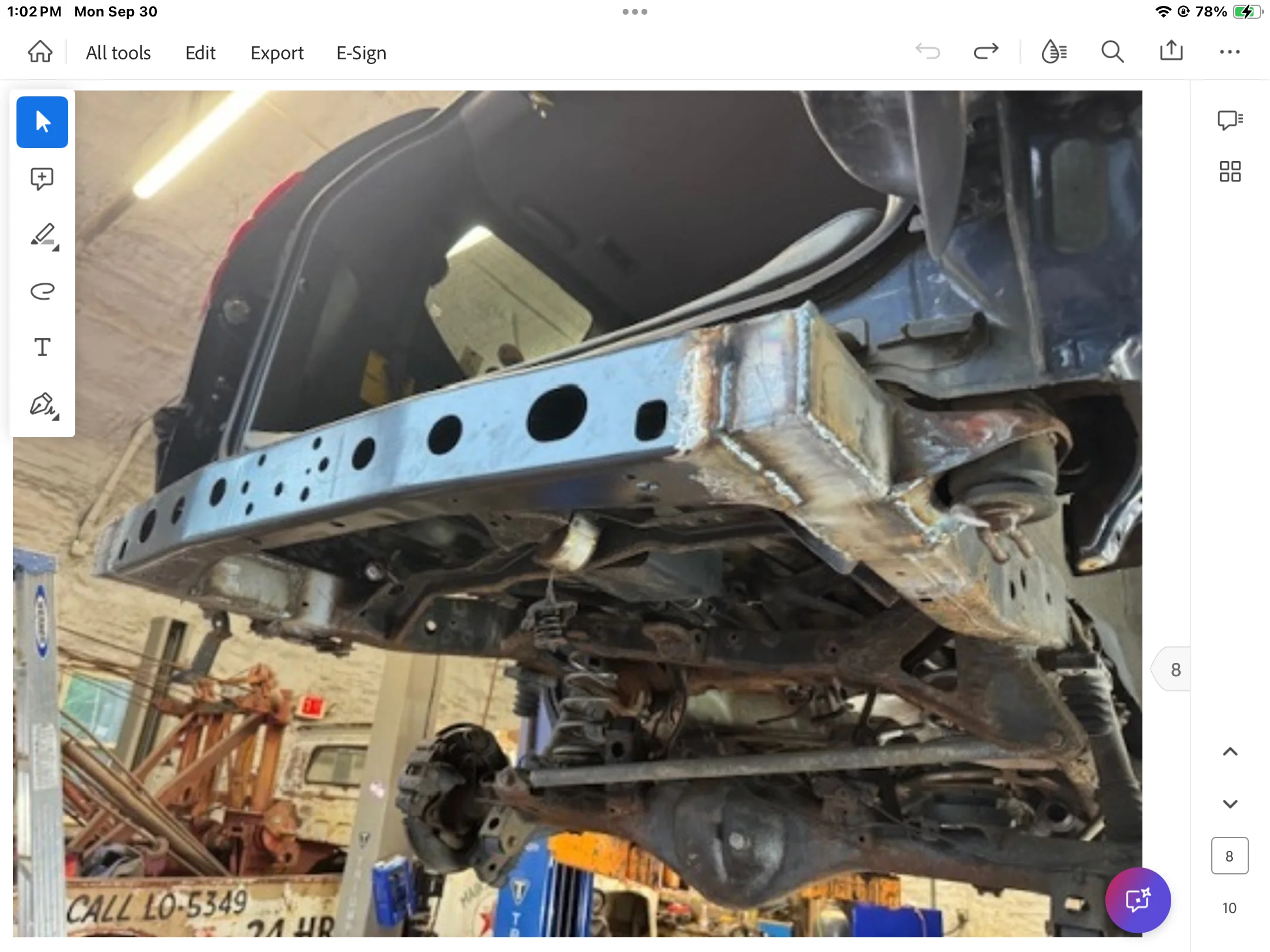

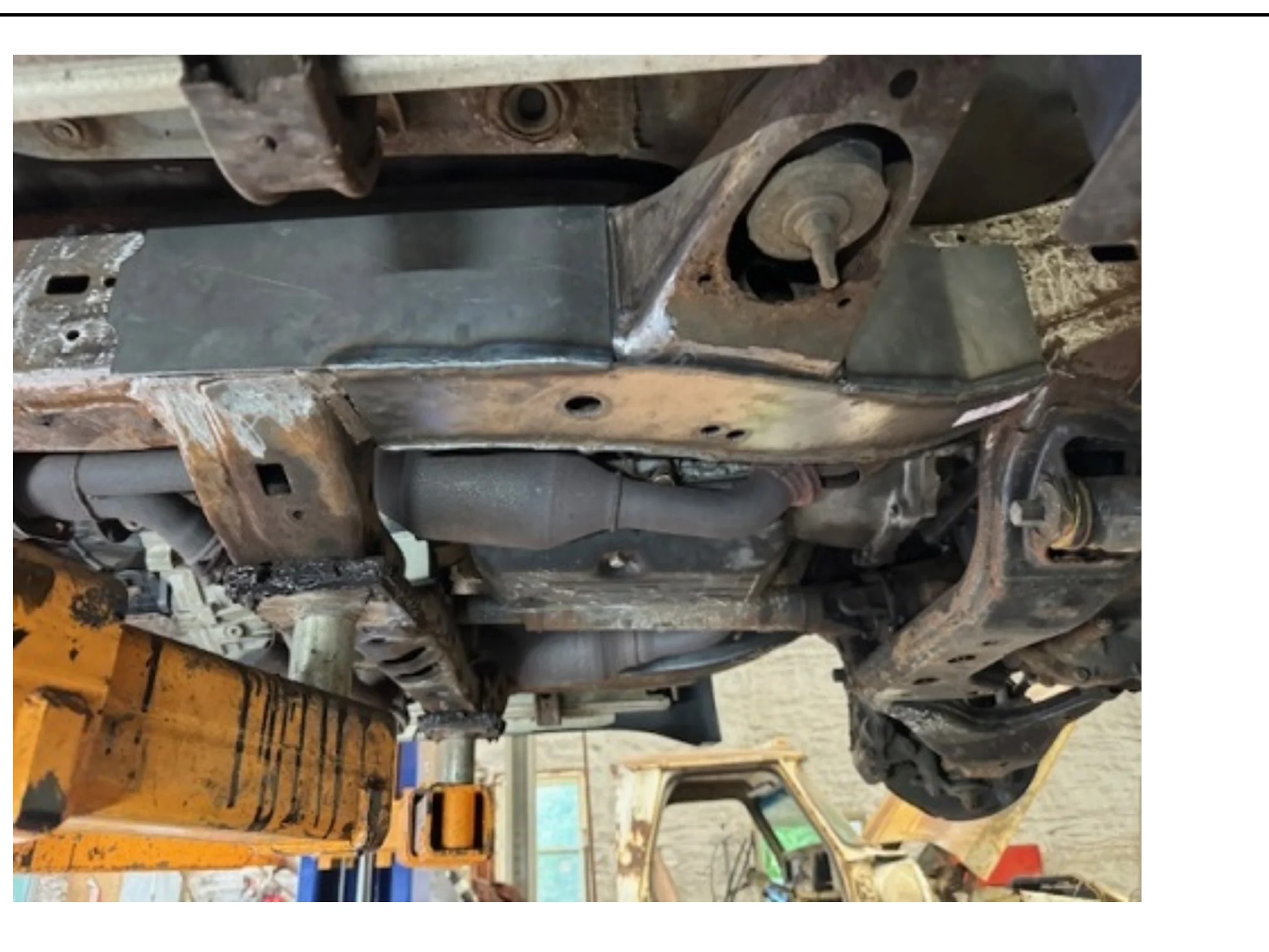

I recently had my gx frame repaired and then coated in por15. It was not cheap, and I understand it wasn’t a permanent fix, but it will buy me a few more years. My entire rear crossmember was gone and if I hadn’t gotten it fixed I wouldn’t have felt safe driving it.

That's interesting. I have a lot of questions. Did the body have to be lifted from the frame for this procedure? Was the rear segment manufactured or cut out from a donor? How much did all that cost? Did you do any rust proofing afterwards?
The body did not have to be lifted from frame, but they did drop the gas tank. The rear crossmember you see in the picture is a part from Lexus, it was about $650 I believe. The frame is now coated with por15, I will try and take a few pictures today but it’s definitely a lot better than it was. It cost around $3000. I have quite a bit into the gx and, aside from rust, it is a great ride. So for me, a few grand to keep it going was worth it.
In hindsight I would have bought a southern, rust free gx and gotten it undercoated, but I bought this years ago before I knew much about them, I just liked the way the gx looked at the time! Overall it’s been a worthwhile and enjoyable experience despite my many mistakes.
