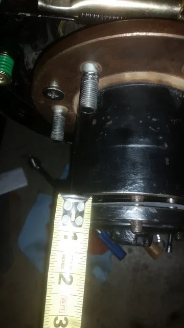

Well, I got the lock nut appropriately torqued and preload within FSM specs but now I can't get my short side axle in. I engaged the cable locker before starting the job. Any trick to getting it in the last 1/4"? I had to lightly tap the the long side axle with a rubber mallet but it went in just fine. Short side ain't budging with light taps :bang:
