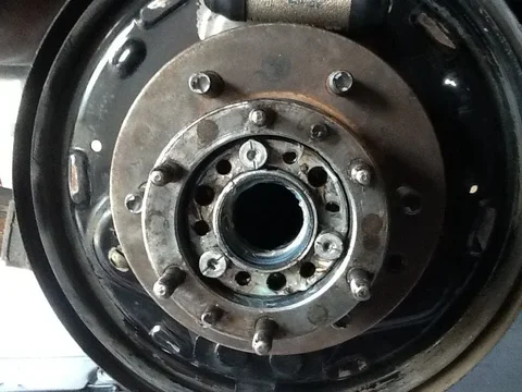

Here's a pic of the rear hub lock nut

Is the hub assy. seated all the way back correctly on the spindle?
Is the thrust washer seated all the way back against the outer bearing assy?
I believe both are fully seated but will recheck
Did you post in another thread about buggering up your hub where the race seats? Were you able to de-burr that and get the new race properly seated? Your preload being high like that without the nut even tightened makes me think something isn't fully seated properly.

Just re-read your first post and read the service manual. One silly question ... Have you measured the frictional force of the seal and added that? The service manual states that you need to measure the frictional force of the seal only (step 4 e in picture) then states the spec is "frictional force plus 0.4 - 3.3 kg"

Not such a silly question when dealing with a moron of my caliber...you caught a big one! Note to self and others: FSM only good if you read it and follow directions provided. My preload numbers above are the frictional force at the seal. As long as I put the drum on and gain no more than 3.3 kg of tension I'm good to go. I think I'm still going to procure the spindle lock nut tool to ensure correct torque. Thanks for telling me how to read a book:doh:
