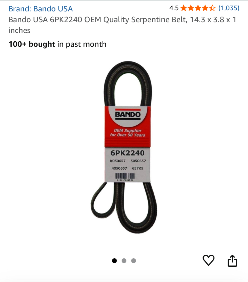

My Serpentine is 83" parts store says 88" even with toyota part # cross referenced.
This is the correct belt. My last dealer invoice shows both this Bando part # and the Toyota part #. I believe Bando is an OEM mfr. ~$18 on Amazon rn.

Got it. I have an uninstalled Bando 6PK2240 and it measures about 88”. Maybe you had the wrong belt, or it lost a chunk?

Belt above for the 2UZ shows 2240 which is the millimeter reference and is approx 88"
