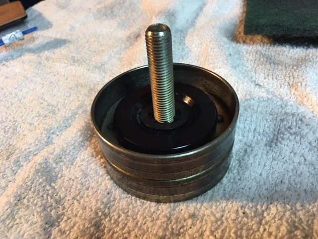

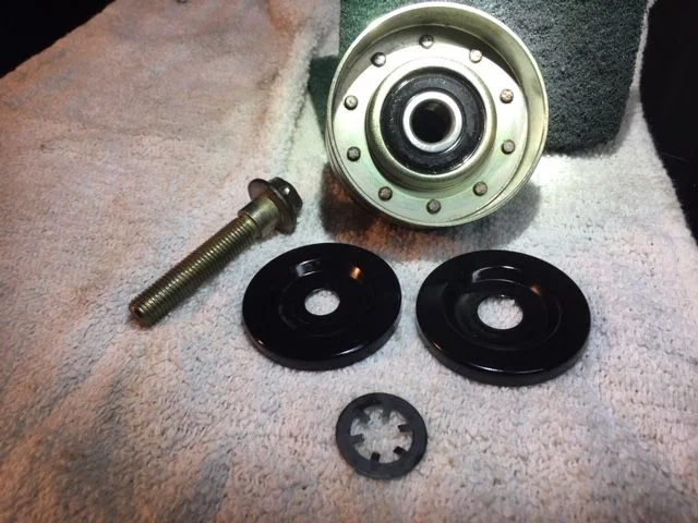

If you really want it fixed for your daughter before you leave and can't source a replacement, some members here have drilled out the rivets to separate the assembly and replaced the internal bearing. A quick search found this post, but I remember other posts as well:

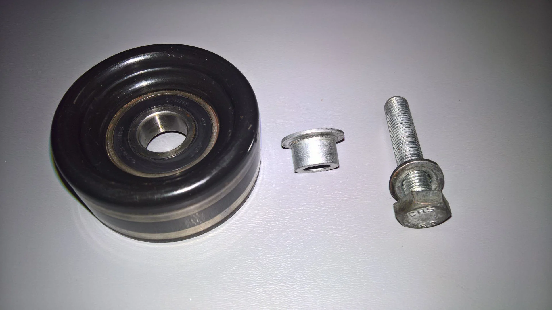

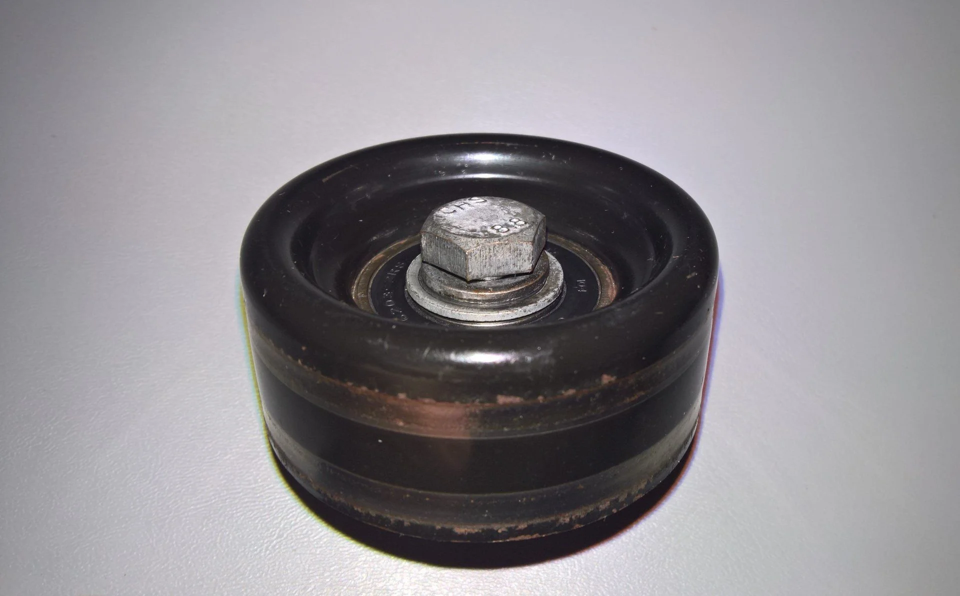

When I bought my 97 model a couple of years ago it had an aftermarket
pulley (see photos) that was a different design, a bit wider (2-3/4") than the OEM part. It worked OK, just pushed on the belts a little bit more. Might be able to match it up at a parts store?

The bearing on the Toyota alternator belt idler pulley cannot be replaced, the halves of the pulley are riveted in place trapping the bearing between
them.

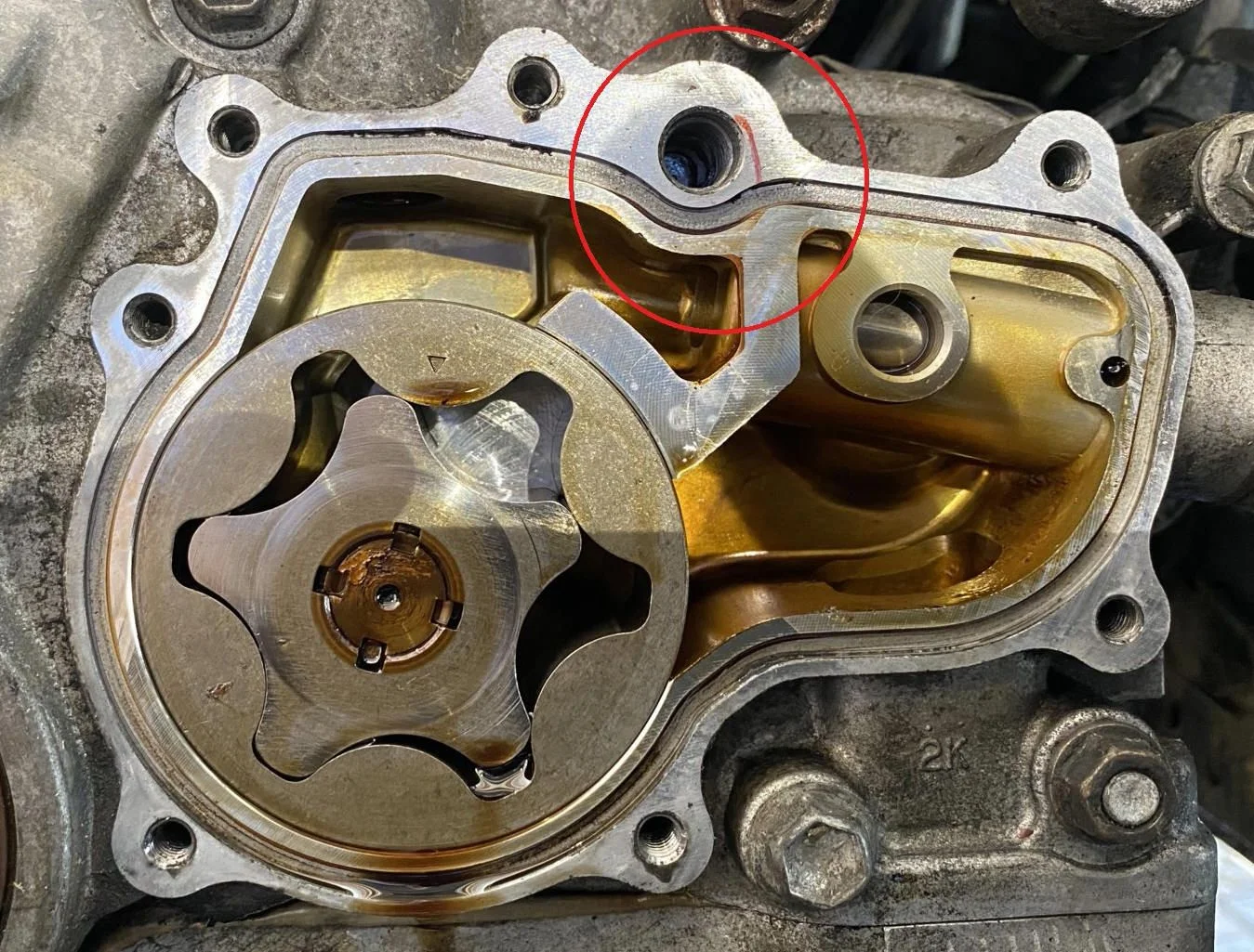

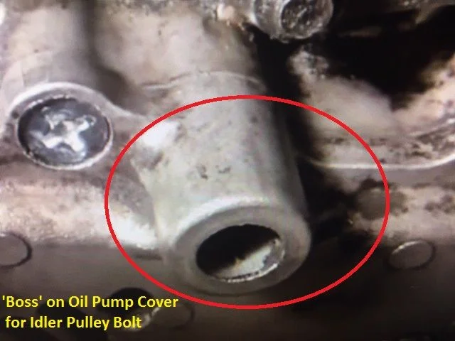

Doug, as mentioned above...it is a 'blind hole'. However it IS possible for oil to leak from the 'boss' in the Oil Pump Cover that the idler pulley bolt goes through IF the oil pump seal is leaking in that area.
As you know...the Idler Pulley Bolt goes through the boss on the Oil Pump Cover and then threads into the hole of the timing chain cover. The bolt thread is M10 x 1.25 (by 55mm long IIRC)
Some folks (without idler pulley) that have had leaks have used a shorter bolt and silicone to stop the leak. The OEM set up (Idler pulley) does provide clamping force against the Oil Pump Cover in that area (whether needed or not).
