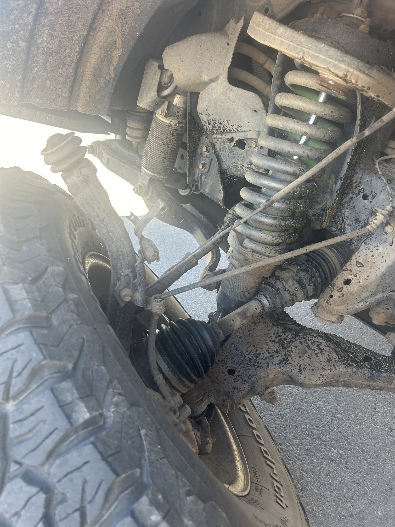

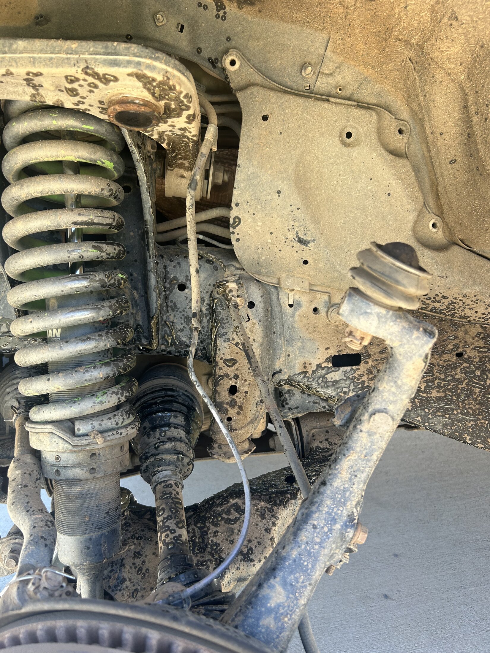

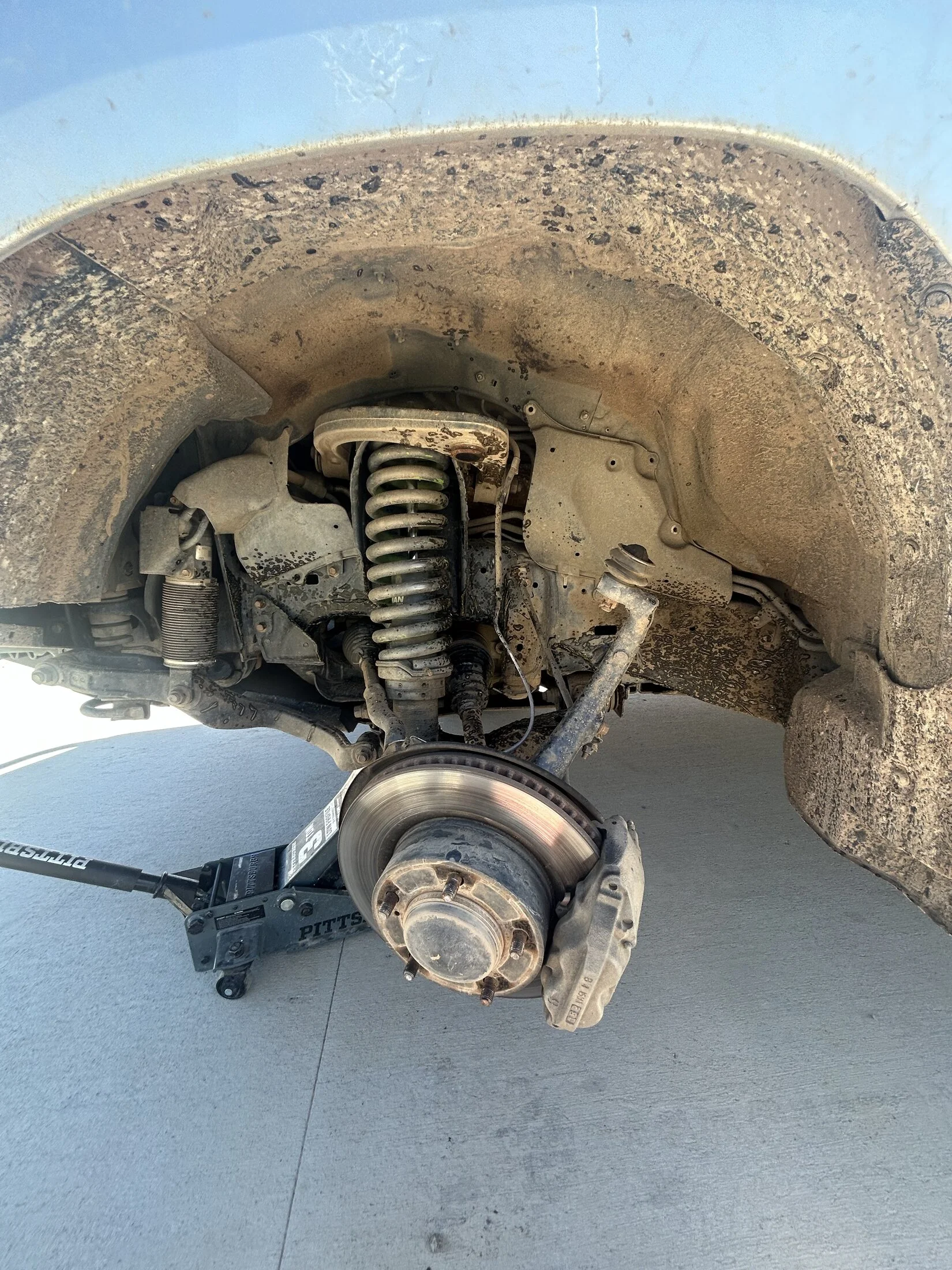

After I fixed the ball joint I thought we were in the clear. However the cv was damaged as we had to move the car roughly 8ft to get to the median we didn’t know this until we were about 20 miles down the road and the cv gave out with grease everywhere.
Perhaps the most interesting thing in the entire saga was that the week before I had the car inspected at a very reputable offroad shop in Denver due to a “clunk” in the front end and the shop said it was the KDSS bushings which were replaced... but the cluck was still there and I was told it could be the sway bar bushings. Now wondering if the ball joints just blew or could this entire mess have been prevented ?

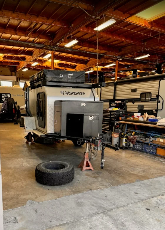

Here's another nightmare in the making. Even with top shelf Timbren suspension, a friends Vorsheer had so much play in the axles after our last trip with a disturbing amount of camber. Glad it held up enough to get it into the shop where they discovered the issues. It's only 3 yrs old, and of course, Vorsheer is also out of business. Maybe too much playing in rocks, but I think it was the washboards that did them in.
With these off-road trailers, I'm strongly against fancy articulated suspensions. Give me a standard oversized Dexter (or equivelent) beam axle that has proven their durability in farm equipment. With bearings and parts that can be found everywhere.

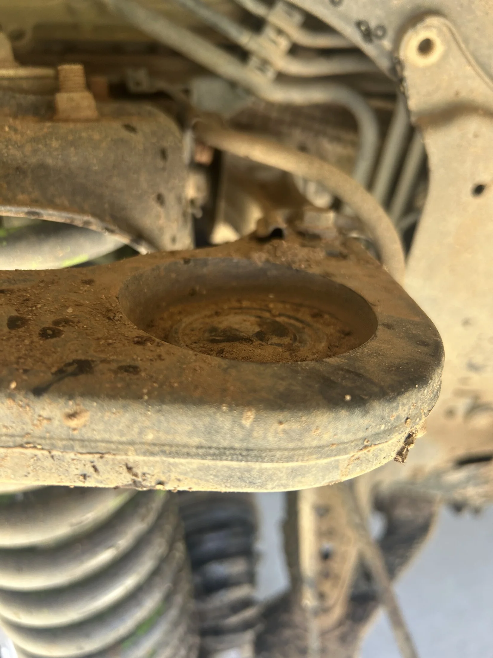

Is the Ironman UCAs that were recalled?
@overrovers you mentioned the UCAs are Ironman but didn’t confirm if they were part of the recall. For posterity and others who might still have the recalled units, was the failure on the recalled part # or had you already replaced the ball joint on the UCA?
They are the recalled ones but I was never contacted by Ironman so had no idea there was a recall 🤷‍♂️
Thanks for clarifying, hopefully it can help someone else before they experience a similar situation. Either way, a crappy type of adventure, glad everyone and everything is back home safe!

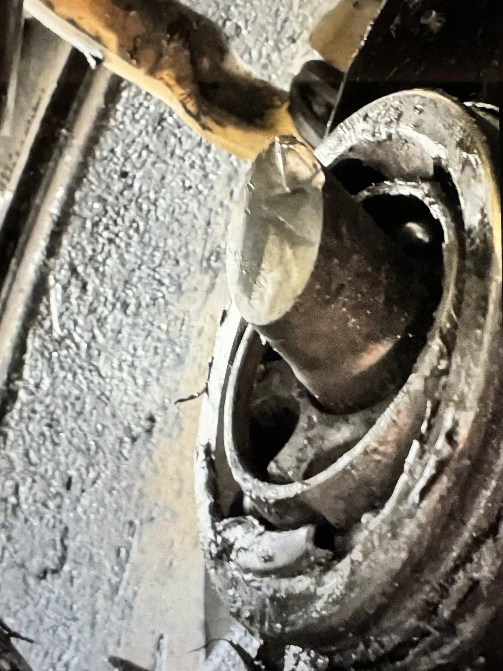

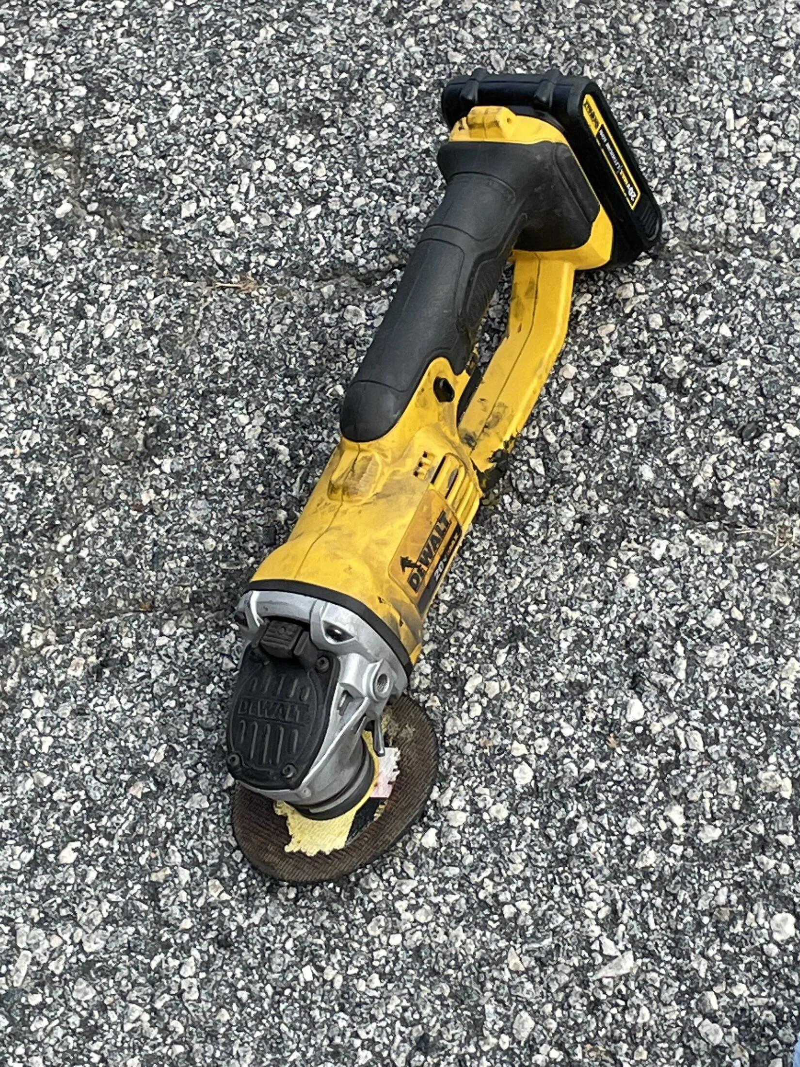

A cheap and easy option could be to get a grinder with a cutoff wheel or sawzall, and cut most of the CV shaft out. Leave the stubs on both diff and wheel side.
Yup. .Ive had to do it a time or two. You really only need to cut the outboard side as the inboard is easy enough to disassemble under the truck.A cut off wheel is the ticket. I carry them with me at all times. They come in so handy when needing to cut through axles and such. I carry a sawzall too but it doesn't like axle shafts. The cutoff wheel zips right through.
Yup. .Ive had to do it a time or two. You really only need to cut the outboard side as the inboard is easy enough to disassemble under the truck.A cut off wheel is the ticket. I carry them with me at all times. They come in so handy when needing to cut through axles and such. I carry a sawzall too but it doesn't like axle shafts. The cutoff wheel zips right through.View attachment 3641581View attachment 3641585
Glad to know this works. I'll be carrying an angle grinder on adventure trips from here on out.
Oh, most definitely, they’re super useful for a lot of various things, and also at camp.
Although not the safest thing out there, a wood specific cutoff wheel is magical in various trail situations
My redneck tool of choice!
