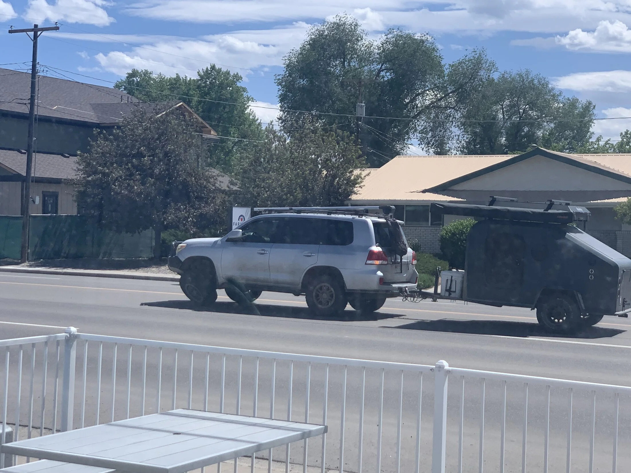

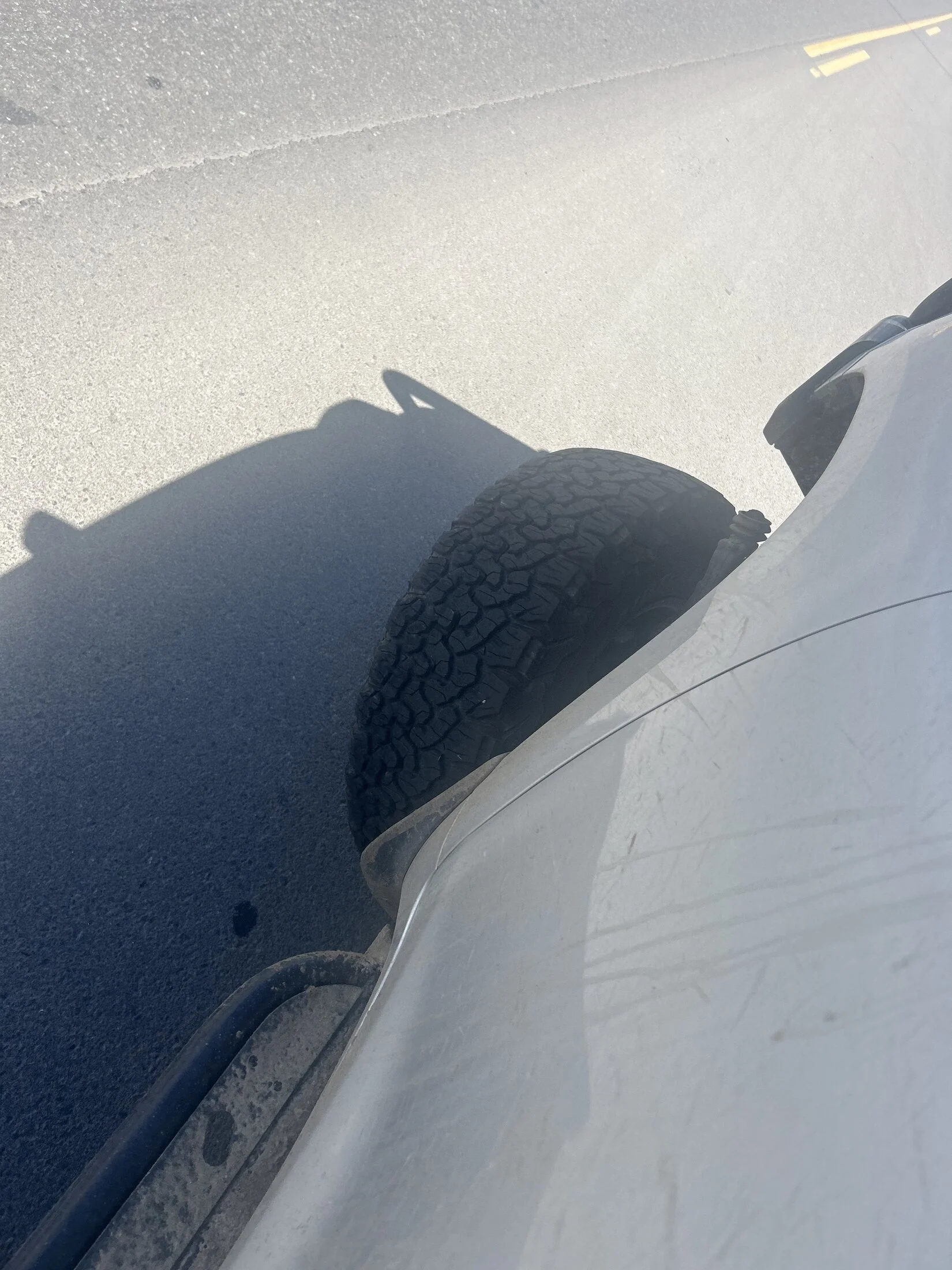

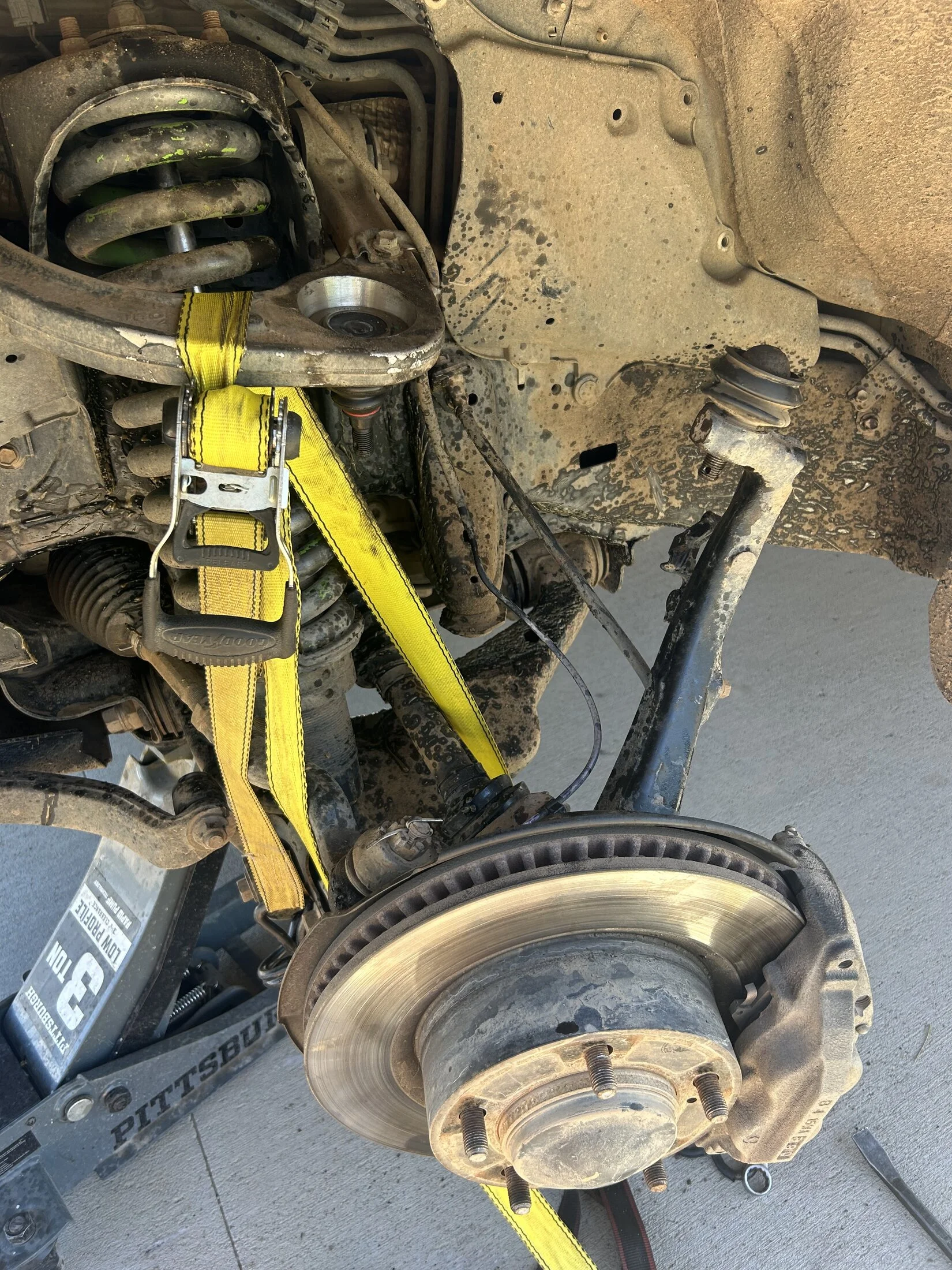

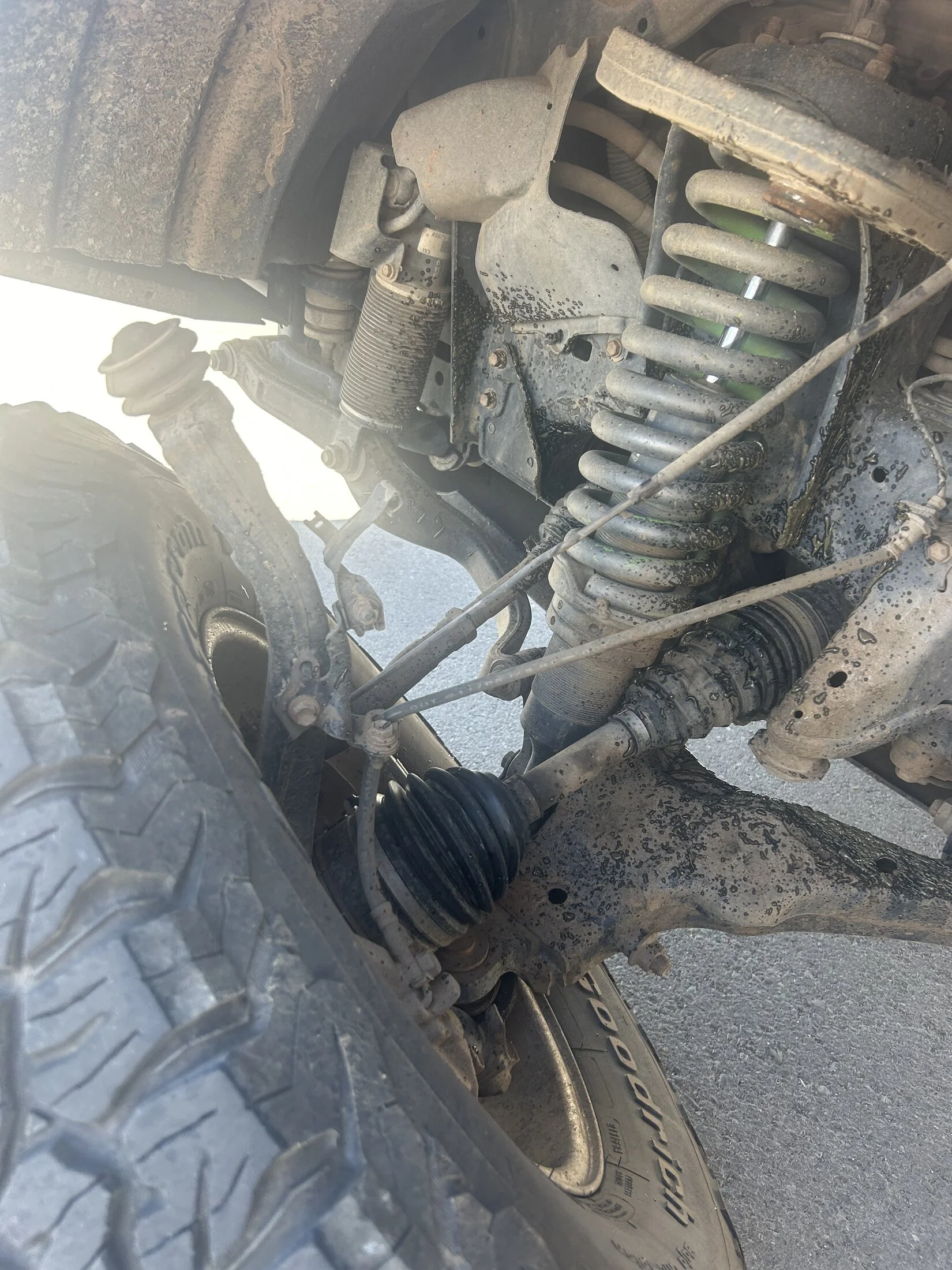

Had a heck of a day ball joint blew got a new one and replaced but about 10 miles down the road we lost a drivers side cv.
Question is can we remove the drivers CV and drive home ?

You can leave the CV cups in the diff and knuckle to prevent leaks. Engage the center diff lock to send full power to the rear driveline to avoid smoking your torsen center diff.
Separating the CV shaft from the knuckle-side cup will be tough but it’ll pull out with enough force to compress the c clip. Then dig out the star, cage, and balls, if possible. Just to keep them from flying once you get up to speed.

A cheap and easy option could be to get a grinder with a cutoff wheel or sawzall, and cut most of the CV shaft out. Leave the stubs on both diff and wheel side.

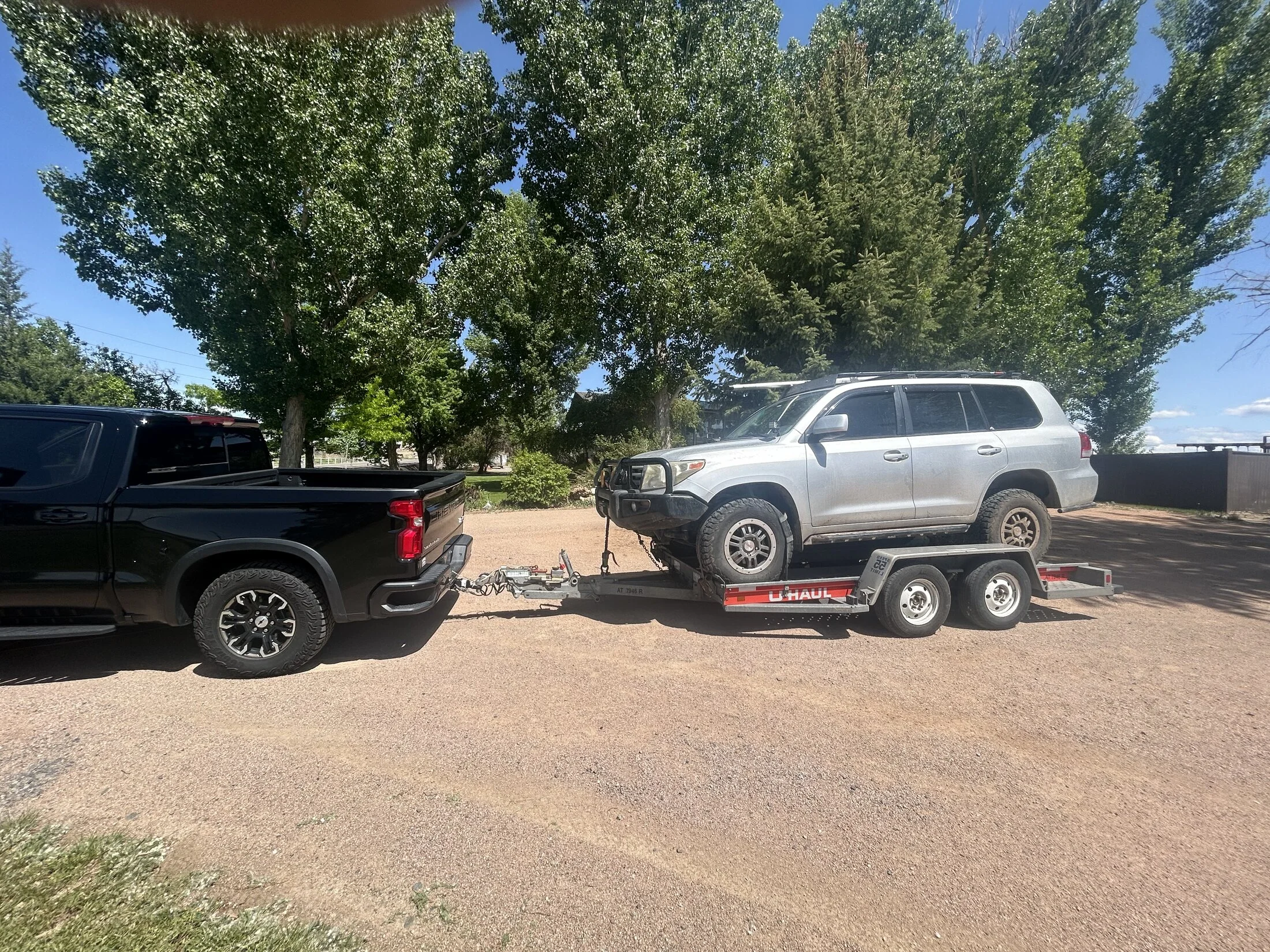

Aftermarket parts = towed by a Chevy.
