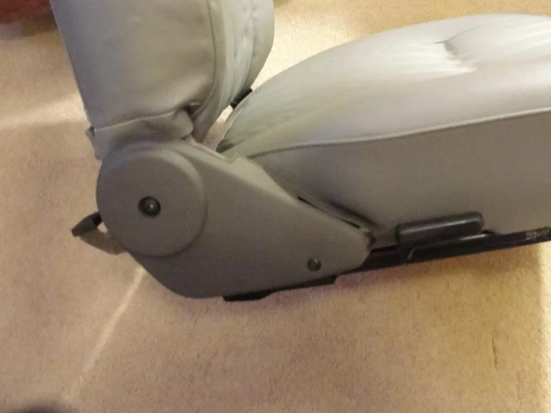

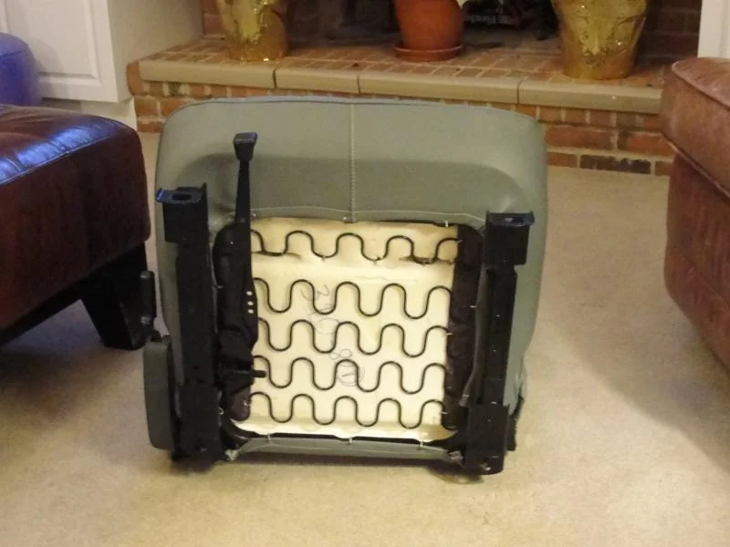

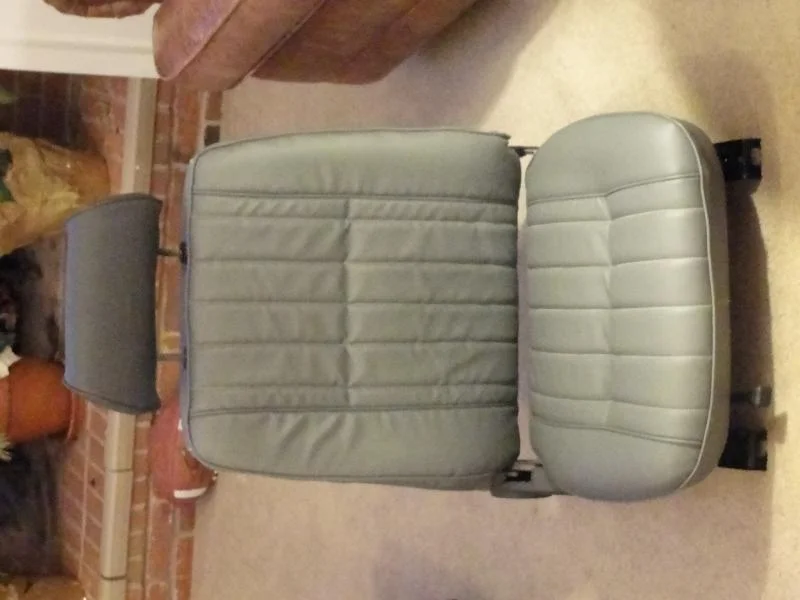

This is my re-furbished front passenger seat. I used AATLASX1 (Shane was a huge help with very helpful tips) covers, original back and SOR bottom cushion. I had the frames, rails and metal seat back powder coated, painted the plastic hinge cover with Dupli-color vinyl paint and refinished all the hardware.
Overall I am happy with the outcome. I think for the drivers side I will add a little batting (sp?) to the back to make the cover a little tighter.

The back looks loose as you stated, is the listing pulled tight into the frame? If you have a upholstery shop close by that has a steamer for "refreshing" foam, this is a great option.
Is it my PC at work as the look very light in the picture.

I am not sure what you mean by "listing". I only pulled the two "ends" in front and back together until they met. It didn't seem like a could really pull them any tighter. I did run a wire through the fabric loops and hog ringed them to the frame.
The look lighter is contrast to the SOW headrest cover which I believe it darker. I am happy with the color.
Imagine if you will the cover inside out, there is a listing that is a 2" fabric pull that the wire goes through that is hog ringed to the frame and it is pulled through the foam in the middle of the seat., its a bitch to do.
Yes, I hog ringed the heck out of that.
