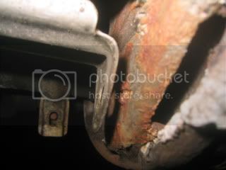

On the back of the resonator there is a little bracket that was hitting against the resonator. It was more noticeable when cold but it would also rattle when taking off from a stop. I just bent it out of the way. I noticed my resonator was shot while I was under there. It's coming apart at the seams because of rust and has a nice solid exhaust leak. Toyota wants $380 for a new resonator but I can get an aftermarket for $75. Is there any downfall to just getting an aftermarket resonator for $75?
BTW- Let me know, I can take a picture of the bracket I bent out of the way if you want.
Please post a pic, new to this stuff and am not sure what it looks like also where under the car? Im determined to start doing this by myself and lessen trips to mechanic.

This is the back of my muffler. It's under the PS rear. See the little bracket flange about a quarter inch from the rusty muffler?
I think it's supposed to have a bolt or screw going into it. It apparently fell out or rusted out and seperated from the muffler. I just bent the flange away from the muffler a bit. It was really close and tapping against the muffler making a horrilbe sound. I'm pretty sure this is your problem if it's not the cats or the heat shield. Mine would rattle when in drive or rattle after a cold start for about 20 seconds. It would also rattle pulling away from a stop for the first 10 seconds. Glad it's gone. Now I need just need to get a new cat back exhaust.
