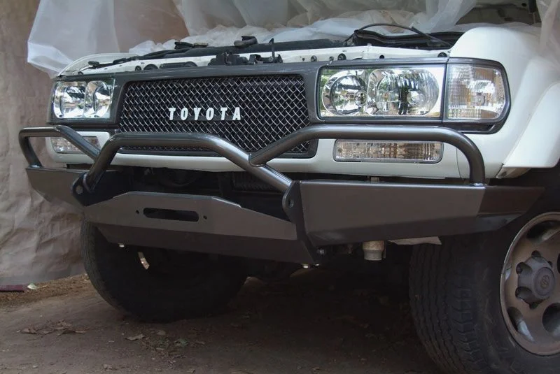

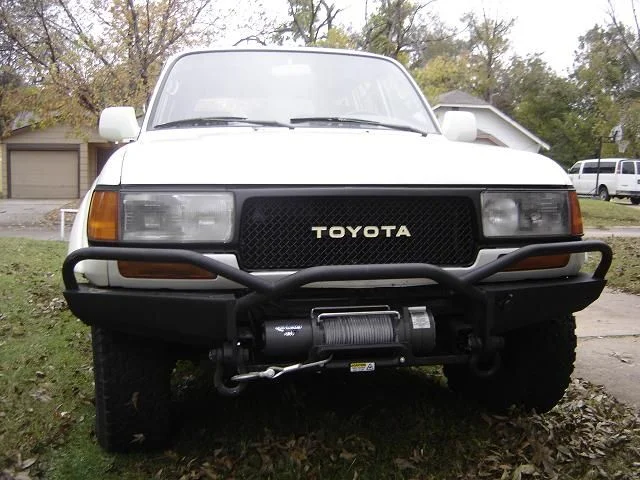

The Ford Raptor style grills seem to be all the rage lately on the Tacoma/4Runner sites. Anybody ever done this on an 80? Seems like it'd be easy to do, kinda like the Satoshi style grills. The only hard part would be finding a mesh in the right contour for an 80, since it has a raised portion.

I really like this mesh, no raised portion. Anybody know where to find this one?
Or "expanded metal". That's what the Setoshi grills are. It's actually cheaper in my experience than perforated metal too.
That grille is woven wire mesh/wire cloth. Not available in stainless to my knowledge.
Expansion is another animal. I use it for reproduction 79-84 40 series grilles.

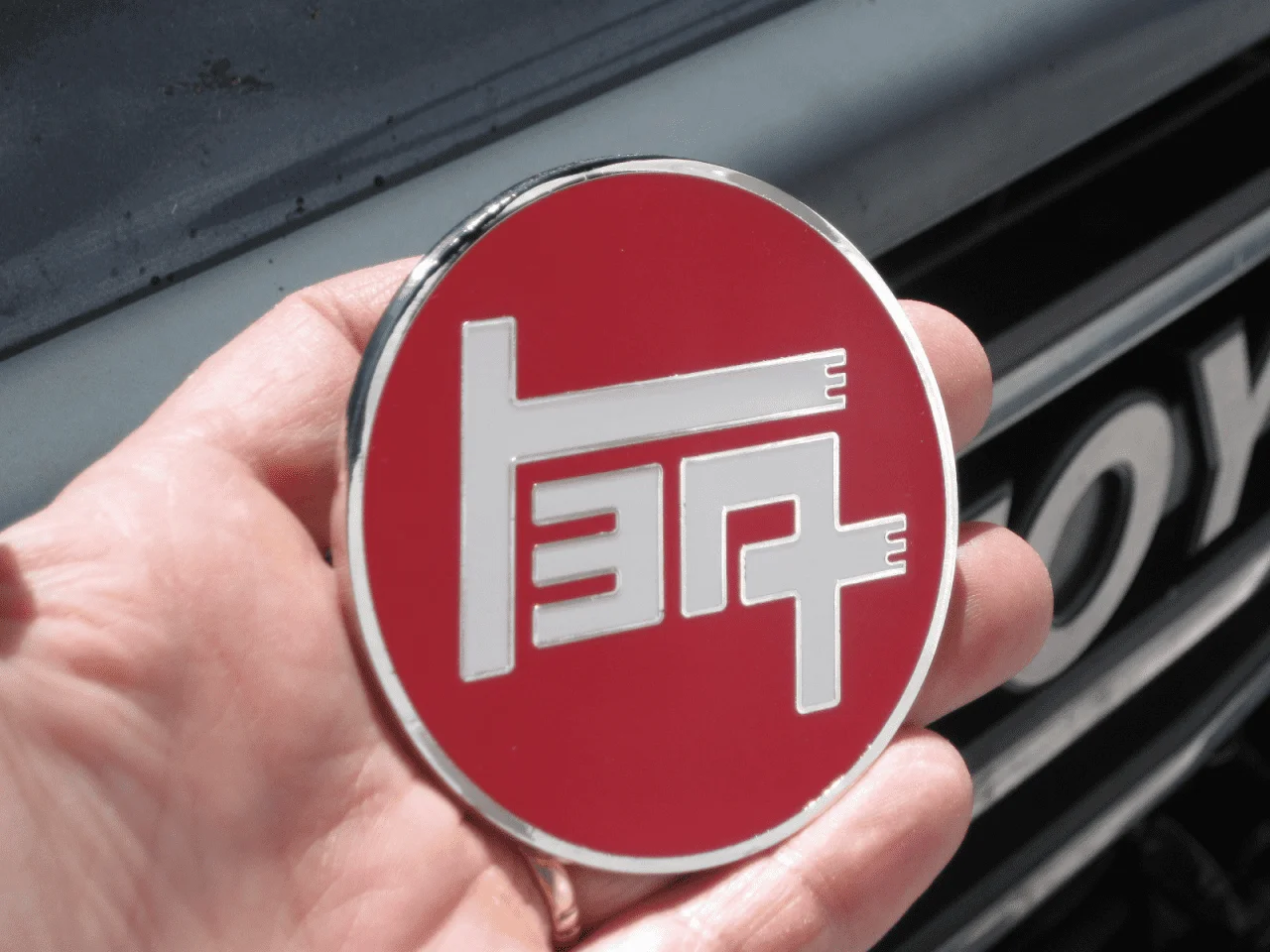

I'd like to make the mesh grille and add this to the center...
http://woytovich.com/cruisers/designworks/teq_badge/
https://forum.ih8mud.com/threads/landcruiser-custom-label-emblem.795186/
Shane...the Satoshi grille material is "shaker screen" woven wire. Your local rock quarry will have rusty used pieces laying around in 3/8" mesh, 1/2" mesh, 3/4" mesh and so on. Stainless should be available. Used in food processing (nuts) where only stainless will pass health inspection.
