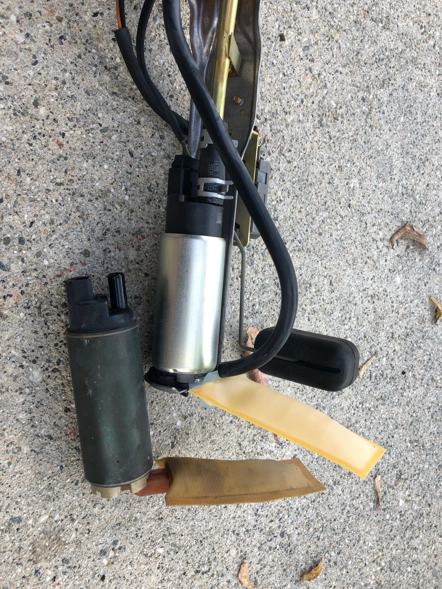

Hey all,
I've been experiencing some random crank no start (3-4+ turns of the key to get started) and occasional shut offs while driving. While it drives, and after starting, there are no issues and it runs fine. I did notice it really only happens when i have around a 1/4 tank of fuel or less. If I keep the gas level above that, the issue goes away. No CEL and it's definitely not the immobilizer issue (had that and have the EFI bypass in place).
This may sound out there, but can the pre-filter on the fuel pump get clogged? Like maybe the bottom of the filter bag is clogged so it's only an issue when low on gas? Once it starts though, it runs fine, so i don't think it's the pump itself.
It definitely seems like a fuel issue. Just wondering if anyone else has had these symptoms before.
I've done a lot of little work on it lately, so most maintenance parts are new(ish).
-New starter
-Timing belt done
-newish fuel filter
-Injectors cleaned
-MAF cleaned
-new alternator
All of that within 6 months.
