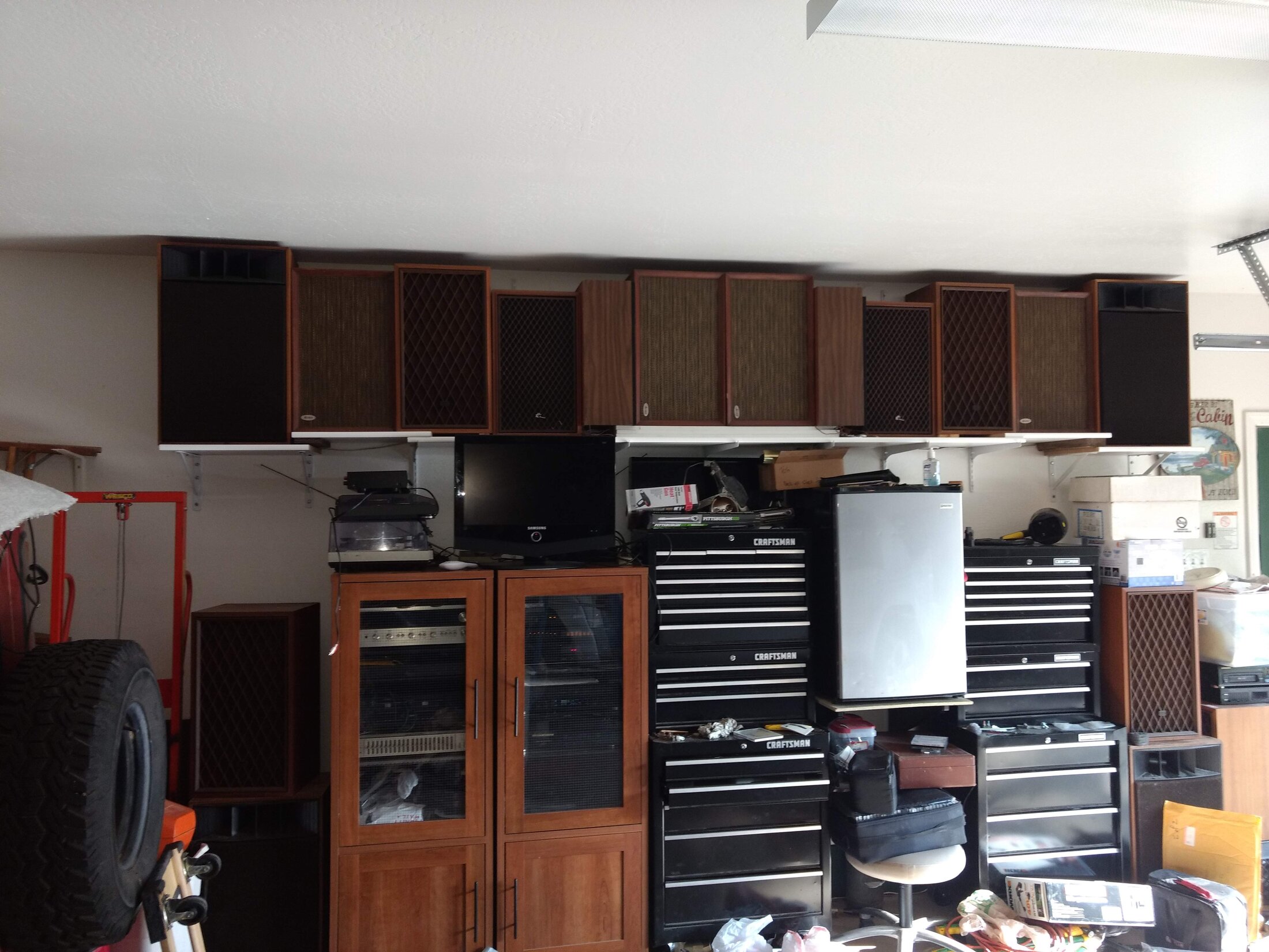

This is my garage audio which mostly dates back to the 70s and 80s.
Is that a set of Nova-8's?
I had a set of NOVAs in college, 6's I think. I got them for free (what I could afford back then) and had a Marantz receiver that I fixed. Mainly listened to OTA FM radio and secondhand LPs on a cheap TT.
Nice collection of vintage speakers.
