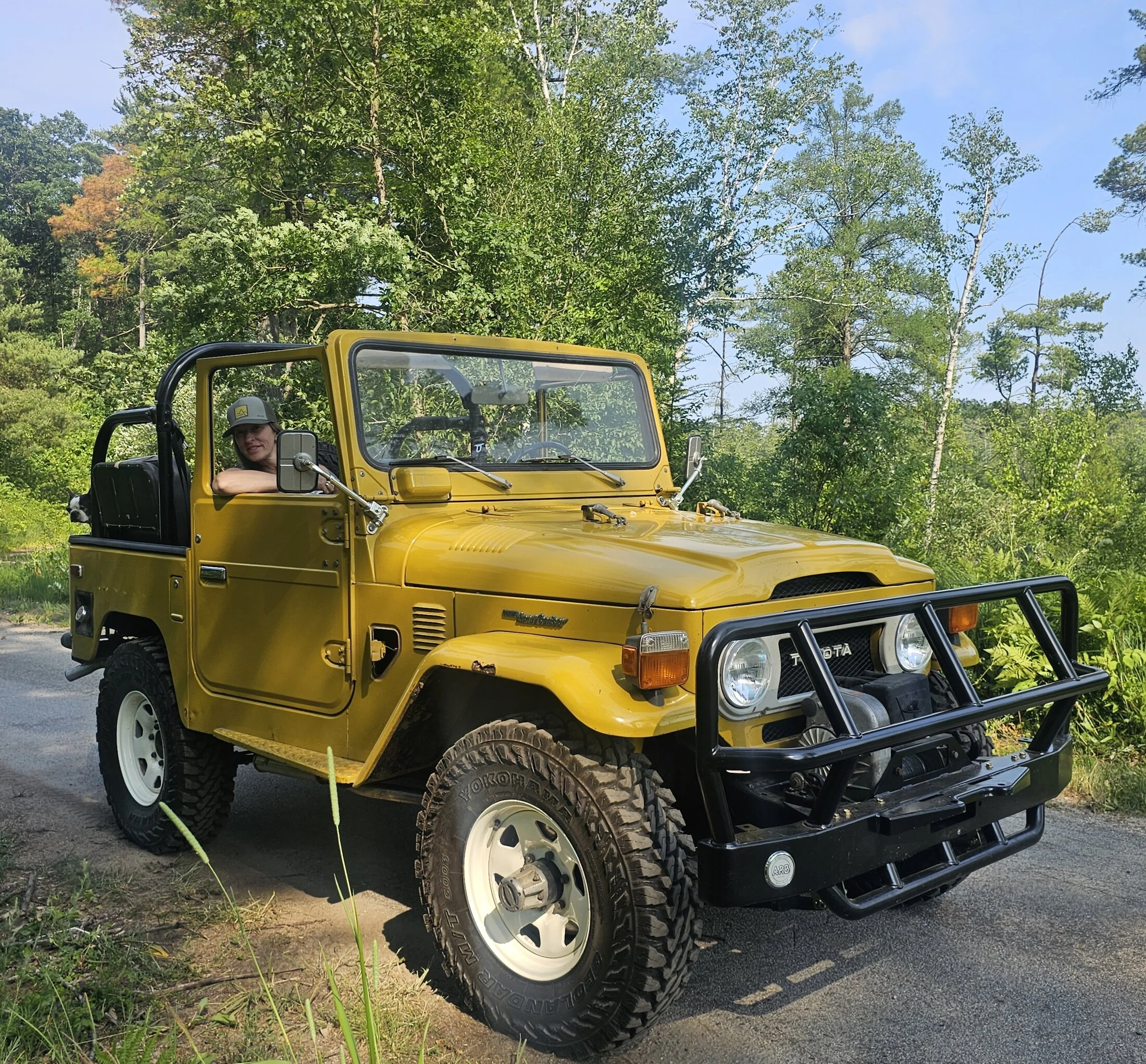

You can sandblast/powdercoat the chrome 15" wheels from a 60 OR go really nice and powder coat a set of 16" 70 series wheels to match the factory white. The new 70 series wheels are silver powder coat and you can coat over those without stripping them.
Definitely go with an off white like RAL 9010 (will match the white on the roof). Bright white looks wrong on a 40
My wife's 40 with 16" 70 series wheels, 255/85 tires and RAL 9010 color.
